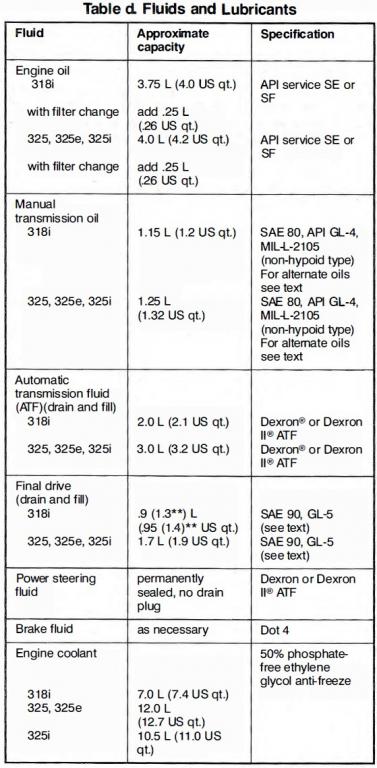

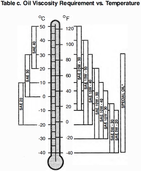

    I had a bit of trouble searching for this information myself so I figured I may make it a bit easier for people in the future.
    This information is pulled from a Bentley manual specifically stating to cover the 318i, 325, 325e, 325es, 325i, and 325is, and 325ic from 1984-1990. I know anyone can find that same manual themselves but you can never have too much information.
Name:	Oil Viscosity.jpg
Name:	Fluids and Lubricants.jpg
    The "Special Oil*" was a synthetic blend that BMW sold back then before synthetics were a popular thing. Ignore it. Just pay attention to the Viscosity/Temp. Conventional or synthetic.

    i always need to put in 5L (not 4.25L) when changing the oil

      5L is what I put in my engine. BTW, since you are new to the forum I would give you a bit of advice. Use the search function here before creating any new post or you'll be roasted. This information has been covered many times in the past.

                I put in 4.25 L and it's perfect every time.

                    Oil cooler / no oil cooler ?
                    325e same as 325i in other words?
                    • ForcedFirebird
                      • Feb 2007
                      • 8300
                      Not the same, but realistically the oil stays in the cooler when you change it, so unless it's a complete fill up (including the empty cooler), they all take about 5qt on a normal change.

                        Yea good point. Makes me want to put a drain plug on the oil cooler somewhere.
