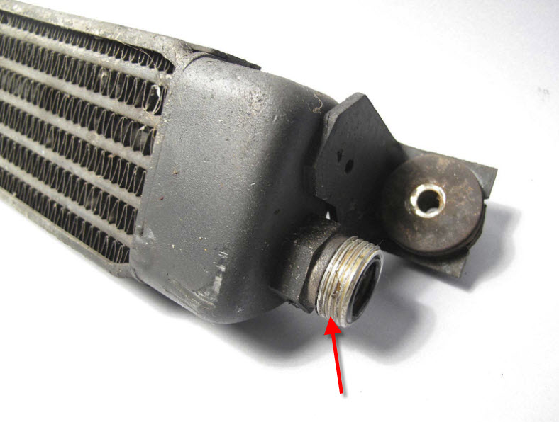

    Hello R3vers,
    Does anyone know if the outlet threading is replaceable? I had to replace my outlet pipe, and (stupidly) ruined the threading upon re-installation of a new outlet pipe...
    Does anyone have experience removing/replacing them?
    My next option would be to re-thread it or completely replace the cooler (which looks pretty beat up anyway).
    Thanks in advance!
    Eric

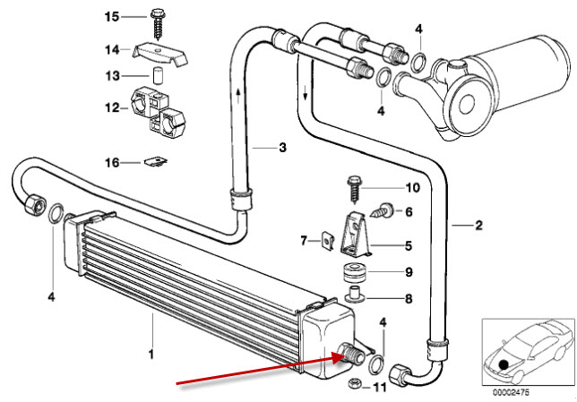

    Here's a real image of what I mean:
    -ALaS
    • TobyB
      • Oct 2011
      • 5296
      Alas, it is not, unless you can braze.
      Those USED to be cheap in the junkyard,
      but they've gotten hard to find around here, lately.

            • iitsMikE30
              • Oct 2016
              • 19
              I would try to re thread it first. Maybe re-thread and if it still leaks than to thread on/ braze on a new coupling onto the existing piece. aiming to seal the leak while brazing the new coupling on.
              • e30davie
                • Apr 2016
                • 1788
                Originally posted by alas
                Have you done it?
                I've had similar repaired.
                You need to find a fitting that you can braze onto it, if you go to a decent hydraulics shop they can supply something suitable and braze it on, it probably wont be the same thread though as that is probably a metric fine thread.
                Then you need to adapt the oem piping to whatever new fitting that you have welded on. Which will probably involve cutting the oem piping and brazing a new suitable fitting onto it. It would be a good idea to cut it back further and add a bit of flexire line to it to make it nicer to bolt up. hard lines not much fine if they aren't made perfect.
                Much easier to just find a new oil cooler if you can. though looking at your photo, number 4 is an o-ring. if you can get the thread good enough to wind on tightish the o-rinig should still seal.
