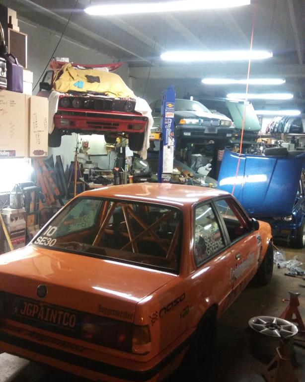

            Been a little backed up lately. :/
