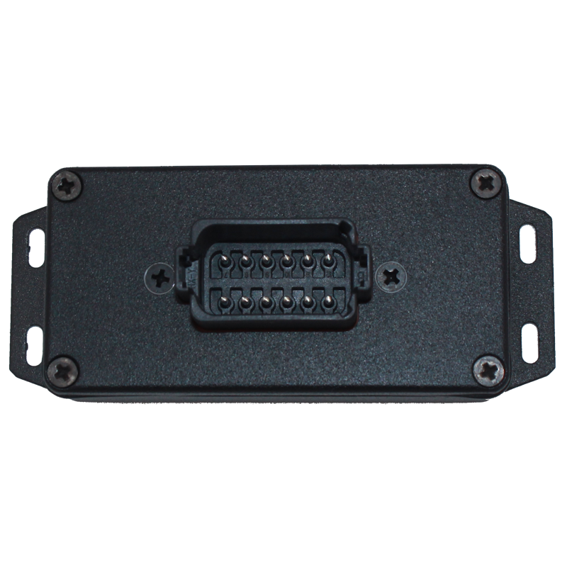

    Compact aluminum case with 4 independent channels and enhanced reliability. The AMP EFI Quadspark is perfect for performance applications up to 12 Cylinders
