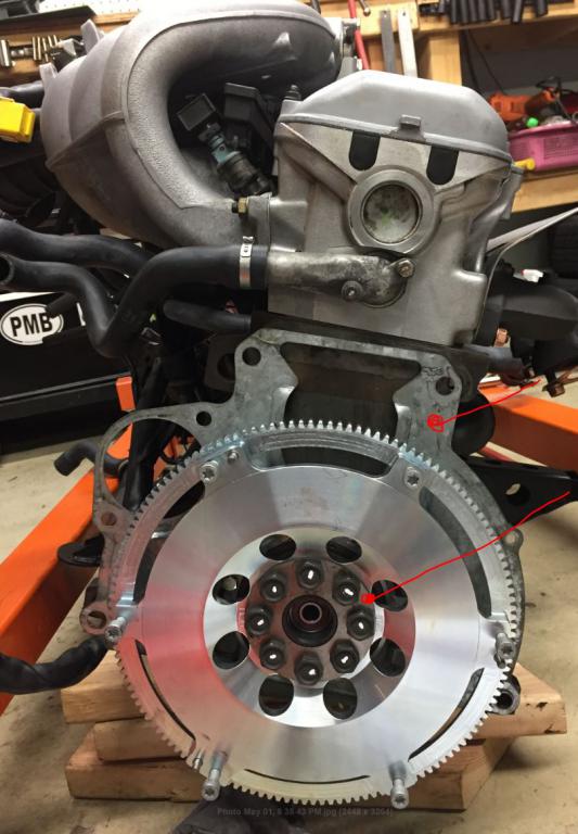

    Just got my car running after major motor & trans re-seal - all stock with the RHD 7.5lb flywheel. http://racehead.com.au/products-page...ng-flywheel-2/
    The flywheel and its seller are a class act and I so far am finding no down sides. I will note that I am a Grown Ass Man who drives my 100% stock E30 sedan daily and have a very low tolerance for Because Racecar stuff (aka chatter, searching idle etc).
    The one annoyance is that it makes a ugly sound when the starter engages and disengages, like a car with a sticky pinion. One guess is this is because of the design with the ring gear being less supported and more likely to "clang" and or flex than the stock boat anchor. I did not lubricate the starter nor new flywheel ring gear. I am using a new stock Sachs clutch.
    Anyone experience same? If this is unavoidable I'm still a fan. If it sounds unusual I will I play with shims / dry lubrication?
    Starter is stock and cranks like a dream.

    I've had a similar issue, when someone left out the shim between the flywheel and transmission. Additionally, if you tighten all the other bell housing bolts, before tightening the starter bolts, it'll do the same thing.
    • r-mm
      • Jun 2018
      • 203
      Good call will try slacking bellhousing and ring gear, tightening together.
      By shim you mean one of attached (arrows)?
      • e30austin
        • 15382
        I'm referring to the outer, large, sheet metal shim, correct.
        • r-mm
          • Jun 2018
          • 203
          Well I got that shim at least
          I will try to slack and retighten the bellhousing/starter. I don't see any starter to bellhousing shims listed but then I suppose that presumed the factory flywheel.

            Be careful with this issue, the ring gear on the RHD FW is not hardened. Frank who works with me in the shop (fporro here on r3v) had a similar issue and the starter ate the rings gears right off the flywheel after starting the car for 2 weeks in his daily.
            Not quite sure what's meant by this. If you can't tighten the bell housing bolts before the starter, then you would have to loosen the bell housing every time a starter is changed?

              I would like to learn more about the starter eating the ring gear in Frank's car please. Was the root cause determined to be poor alignment/engagement of the two? Surely normal wear on even an unhardened ring gear would never lead to such quick wear?
              • fporro
                • 1860
                Hey r-mm, ForceFirebird is correct. My starter was a bit loose, the sound warned me but I ignored it, so within 2 weeks made a flat spot on flywheel until did not catch anymore.
                Not the flywheel fault but my negligence. I order a replacement unit.
                Besides rattling at idle it worked flawlessly for a long while.

                              I just installed the same flywheel in my 325i. I have the exact same noise when starting. I also know someone local to me who is experiencing the same thing. I have an email into RHD as well.
                              It's like the starter is binding on the flywheel when I start. It's awful.
