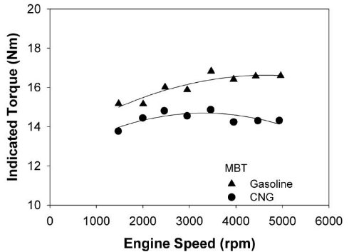

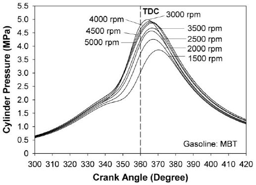

                  Cylinder pressure vs rpm... Speaking in generalities, since specifics depend on the engine itself and tune. Highest peak pressure tends to occur at or around the torque peak, then peak pressure tends to decrease as rpm climbs. The timing of the pressure peak itself also varies with engine rpm, without respect to ignition advance, tending to occur progressively earlier until around the rpm at which peak torque occurs and then later after peak torque. The optimum time in the stroke for the peak of pressure to occur is several degrees ATDC, later and you lose torque, earlier and you risk engine damage. The objective when tuning is to maximize the cylinder pressure, to a point, and move it to that most optimal position in the stroke. Advancing the timing not only increases the peak cylinder pressure but moves it closer to TDC. The attached plot shows the above, albeit rather poorly labeled, cylinder pressure varying with respect to crank position, without respect to ignition advance which was fixed at 18°BTDC (very important for the purposes of this comparison!). The other plot shows the rough location of peak torque for the research engine for reference when using the other figure. This is general behavior for a 4 stroke gasoline engine, specifics are highly dependent on many factors but this general behavior will apply to an M20 just as well as it applied to the single cylinder test engine.
