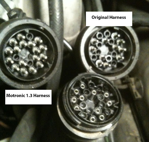

        I've got a 06/86 e (Motronic 1.0 system) that I'm doing a 1.3 upgrade on. I'm ready to swap out the harness and the 1.3 harness fits right on to my stock c101 connector. I know when people had the older square connector some wire splicing needed to be done, but I'm not sure about this.
        Do I need to move some wires around or can I just plug the 1.3 harness into the 1.0 connector and go?
        I took a photo and there are clearly some pins on the 1.3 side that won't be connected to anything on the 1.0 side.
        I think the answer to my question is "Yes" but I'm not sure if I've read about systems getting fried from just plugging and playing. Wanted to be sure before I reconnect the battery.

          After reading the first post it is plug and play!

            Where on the first post (or any of them) does it say 1.0 to 1.3 is plug and play?

              I guess what I meant to say is that it doesn't say anything about having to rewire and as detailed as it is I'm sure it would say if needed...
