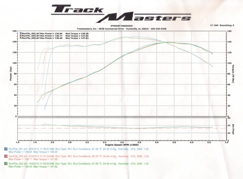

                        Good writeup. My '87 325e fired right up following the instructions. I used a recently rebuilt EU 323i head, and the rest of the parts from a '88 325i and '90 325i. The motor pulls cleanly, idles perfect and gets all fun on the 1st to 2nd shift. Car is a dedicated AutoX/RallyX car and this feels like some much quicker times. No more falling flat and shifting at the wrong places on course.
                        Update: Dyno day today. Nice numbers. Well worth the swap. 139.04 hp/149.26 torque
