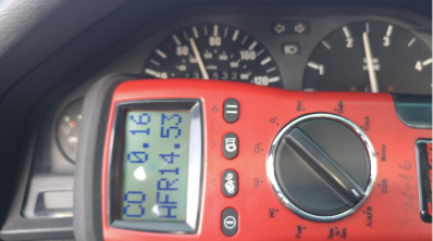

        I got an exhaust gas analyzer today.
        The AFR is good on the freeway.
        Click image for larger version  Name:	Screen Shot 2020-07-24 at 11.29.29 PM.png Views:	0 Size:	135.2 KB ID:	9940848
        If I accelerate hard it goes very lean (over 20). (I guess I have to stop that until I can figure out how to address.)
