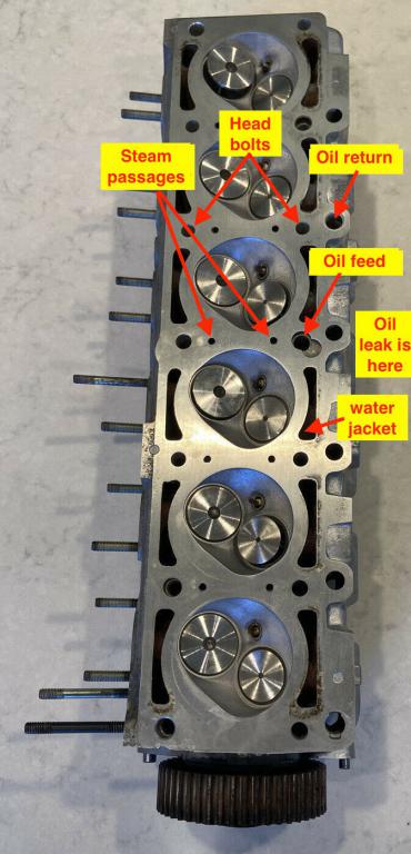

                  Eta 200 head.....
Name:	E30 200 cyl head.jpg
                  So, on the 731 head, those two small passages aren't there. Maybe I labeled them wrong above, because how do the block oil galleries match up with this head?

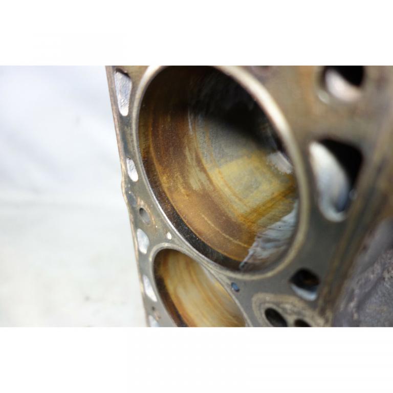

                  eta block...
Name:	E30 eta 2.7 block.jpg
                  • digger
                    • Nov 2005
                    • 6198
                    What is labelled as head bolts are oil return
                    What is labelled as oil return is oil feed
                    What is labelled as oil feed are steam holes

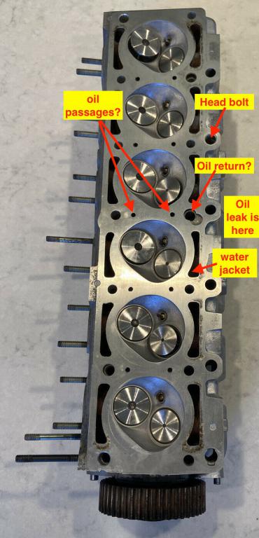

                    • LateFan
                      • May 2013
                      • 4432
                      Oh, thanks for that - I F'd up!
                      I'll attach a corrected pic for the record.
                      The steam holes are connected to what?..the coolant passages around the combustion chamber?
                      And then what happens in the 731 head with none to the block?
                      So there's oil pressure right near the side of the head where the leaking is.
                      Click image for larger version  Name:	E30 200 cyl head.jpg Views:	0 Size:	50.5 KB ID:	9946100
                      • ForcedFirebird
                        • Feb 2007
                        • 8300
                        It's common for the m20 heads to leak on the passenger side, specially if using a crap gasket. The good gaskets separate the head bolt hole from the oil feed, the cheap ones combine the oil supply and head bolt into one boss.
                        Since the 731 head came off an m20 that used that same cooling system as the rest of the m20's, then you would suspect that the passages would line up. ;)

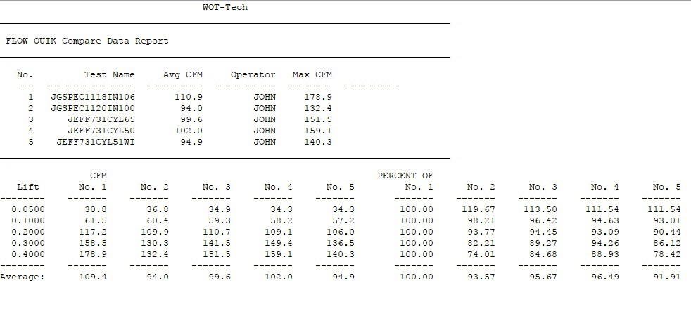

                        I flowed a 731 a while back, but the work was done else where:
                        The first test was randomly selected stock 885 intake, second is an AMC, the next 2 are different ports on the 731 head. As you can see by the "percent of" the 731 potentially out flows the AMC 885 clone. I bet with a little flow testing, there's more in there (random dude port job on this head may have even hurt flow).
                            Am I reading that right then, that the AMC clone is not outflowing a stock 885, except at very low lift?
                            • ForcedFirebird
                              • Feb 2007
                              • 8300
                              Yes, the AMC heads have been available for some time. I actually have two here at the shop. They flow horribly, though (test #2 in my post above).
                              If you are concerned about the steam holes, they can easily be drilled. There are some 24v heads that do/don't have steam holes as well, so who knows (some are even same casting #). But, honestly, if BMW was OK with leaving them out, not sure why they would need to be there if you slide a b27 rotating assembly under it.
                              You don't have to modify the 731 head at all, really, it's still an upgrade over the 200....
                              Just look at the flow coefficient (Alpha-K) of the 731 vs 200. The 731 is on par with ls1 for flow vs valve diameter up until higher lifts. Then the 731 smokes the ls (and the 885 dominates both). So, just putting the 731 head is an upgrade, specially if you paired it with a good cam. This way, the build can be done in stages. First swap the 731 and leave everything else alone. Then you could piece-meal the rest and enjoy the upgrades as they happen and budget allows.
