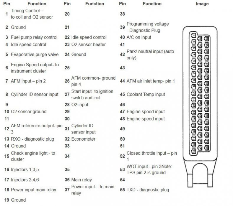

    Ok, I have a misfiring 89 325i and I’m trying my hardest not to just buy an afm and see if that solves it. I’ve tried TONS of stuff vacuum, iac, spark, all that. In this post, I want to discuss afm testing. Per the Bentley, it says to measure resistance at pins 7 and 8 on the 25 point ecu harness. I tried that and I didn’t get any resistance values.. At the time of me posting this, I’m realizing there are far more than 25 pins on my harness..
    1) am I measuring from the wrong points?
    2) is this measurement only able to be taken from the afm itself? (Doesn’t seem to make sense since the ecu would need this info)

      Here is the correct ECU pinout:
      "It wouldn't be there if it wasn't..." - Milton Berle
