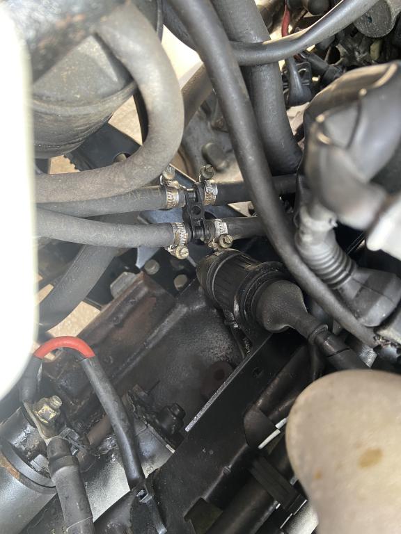

    Hi peeps,
    About to replace my fuel lines in the engine.
    I see there is some sort of connecting piece that splits both lines.
    Is this a stock factory thing?
    Do I need to maintain this or can I run one length from the metal line by the firewall to the engine?
    I am also trying to keep this car as visually stock as possible, so if keeping this does not affect anything, I would rather keep it.
    If, on the other hand, it might improve fuel delivery some, then I would remove it...

    it's not necessary. some cars had them, some didn't. were it my car, i would just eliminate it and keep things clean looking. good on you for replacing fuel hose.

            Continental, CRP, or Gates FI lines are all good things, and you ought to be able to get away without any molded hoses.

                Yeah it seems that would just be a problem prone junction for no reason. If you're changing lines anyway, just run continuous lines. I bought a few meters of CRP hose and it was enough to do a few cars. I do not want my cars going up in flames due to 30 year old hoses. For some reason, these easy to change hoses are often overlooked.
