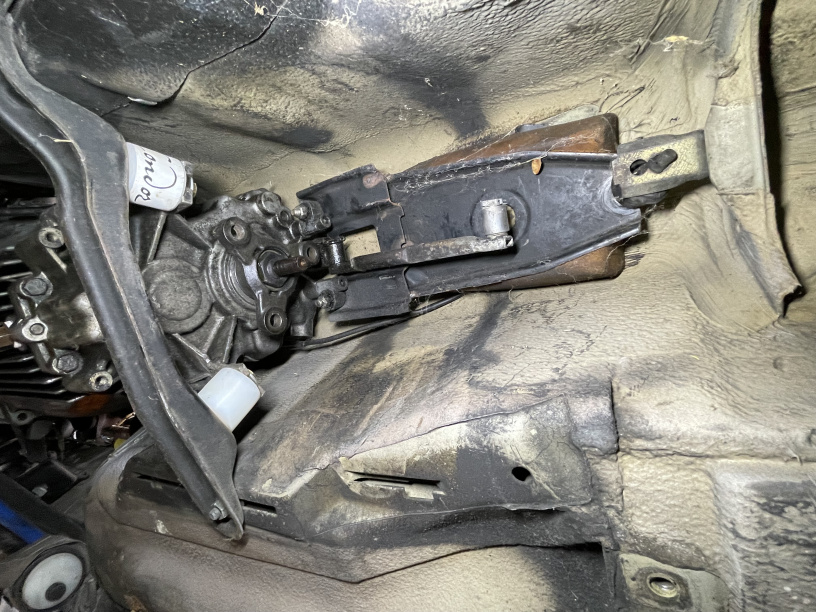

                    It seems to shift perfectly when the car isn’t running which is why I am leaning towards the problem being either the terribly misaligned shifter setup as seen in this photo, or the corrosion on the synchros.

                      hmm yer. Well one of those is alot easier to fix than the other. so id start by cleaning up the shifter and see if it helps. nothing stands out as too misaligned in your photo?
                      There are lots of rubber bits holding that all together though, so if they are all stuffed it will be a bit...floppy.
                      looks like your selector shaft seal is leaking too.

                        I will clean up the shifter setup by replacing the worn bushings and see if that improves anything. If it doesn’t I’m afraid it’s likely the internals causing the issue. I may have found a G265 available and will see about purchasing that as a possible replacement.
