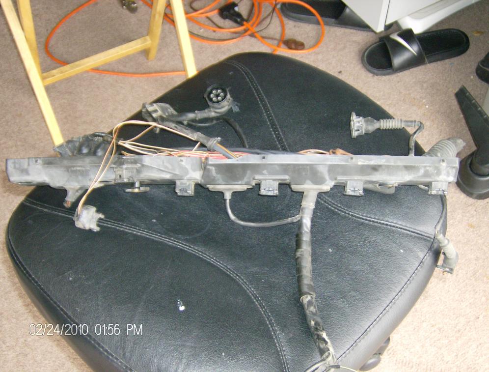

                      #115
                      this is all i have that came with the m30 motor (talking about the harness) which should be the first pic the rest are just misc. thats why i prefer to use the e30 wire harness because i already have everything for it nd i heard that its a lot easier to work with
                      • Jean
                        • 18228
                        #116
                        That's an automatic e32/e34 harness with a big chunk of stuff cut off.... I would use another e32/e34 harness or use the e30 harness you have.
                        It's not EASIER to use an e30 harness, think about it, the e32/e34 harness is MEANT for the m30, no wire cutting/extending needed like with the e30. Plus, e32/e34 harness looks cleaner.

                          #117
                          I see what ur saying jean, now if i were to get another harness would it have to be from an manual m30 or it doesn't matter
                          • yert315
                            • 2734
                            #118
                            go to the junk yard and get ANY m30 harness that's complete. I am running a harness from an automatic and it's fine. I'm just not using the automatic bits. I got mine frmo the JY for $30. Trust me it's easier.

                              #119
                              well looks like ill be going to the junkyard to pick up my harness nd go from there
                              • RickSloan
                                • 2401
                                #120
                                dont go and get just "ANY" m30 harness. Make sure it is from an e32 or e34 its what you need. The early harness will not work with a b35 ecu or some of the sensors like the crank reference sensor and temp gauge sensor.
                                plus the motronic 1.3 looks better and runs better
                                im running the late harness on my b34 and its great

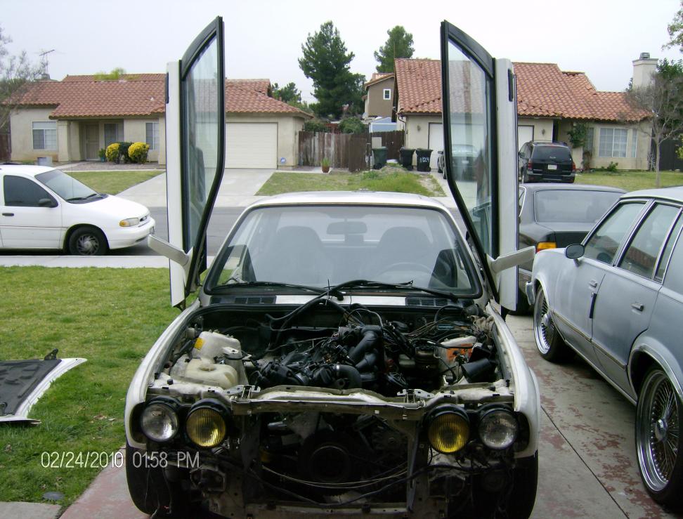

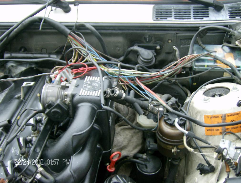

                                why has no one said anything about the doors...
                                and how did you plumb your brake booster? I couldnt see in the pictures
