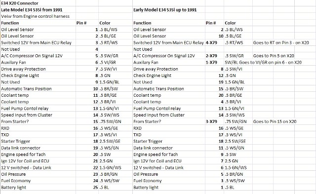

                okay im lost ive been trying to figure out jeans diagram for the c101 plug but everytime i look up the the plug from the e30 the wires on the diagram dont match up to the wires on my car, plz help!!!!

                    • LowR3V'in
                      • 4209
                      #145
                      This one? or are you looking for the ecu pinout?

                          okay this is what i have so far as far as the c101 plug goes.
                          E30 Side
                          1. Blue = Alternator
                          2. Blue/Yellow = Oil Sensor
                          3. ?
                          4. Brown/violet = Coolant Temperature Sensor
                          5. Black/brown = Oil Pressure
                          6. Green/Yellow = o2 Sensor
                          7. Green = Ignition
                          8. ?
                          9. ?
                          10. Violet/green = Oil sensor
                          11. Blue/white = Diag connector
                          12. Brown/black = Check engine light control
                          13. Violet/red = Fuel pump
                          14. ?
                          15. ?
                          16. White/black = SRS connector
                          17. ?
                          18. Black/yellow = Starter
                          19. ?
                          20. Brown = ?
                          What else needs to be to be wired up to the c101 plug for my car to run and is pin #20 a ground nd were does it go to.
                          I really need u guys help on this one

                            • sacse30
                              • Jan 2010
                              • 123
                              #149
                              This is all that i've been able to find.
                              and this...
                              • Jean
                                • 18228
                                #150
                                Start matching up the wires, all the info is in front of you or confirm it all by looking through an ETM for your CAR and the Engine.. You'll have to go page by page and look for any/all mention of c101/x20 on the diagrams and take notes. This isn't very difficult, try it and actually learn what goes where and why :)
                                If you don't want to do this source an automatic or manual b35 harness from an earlier e34/e32 car.
