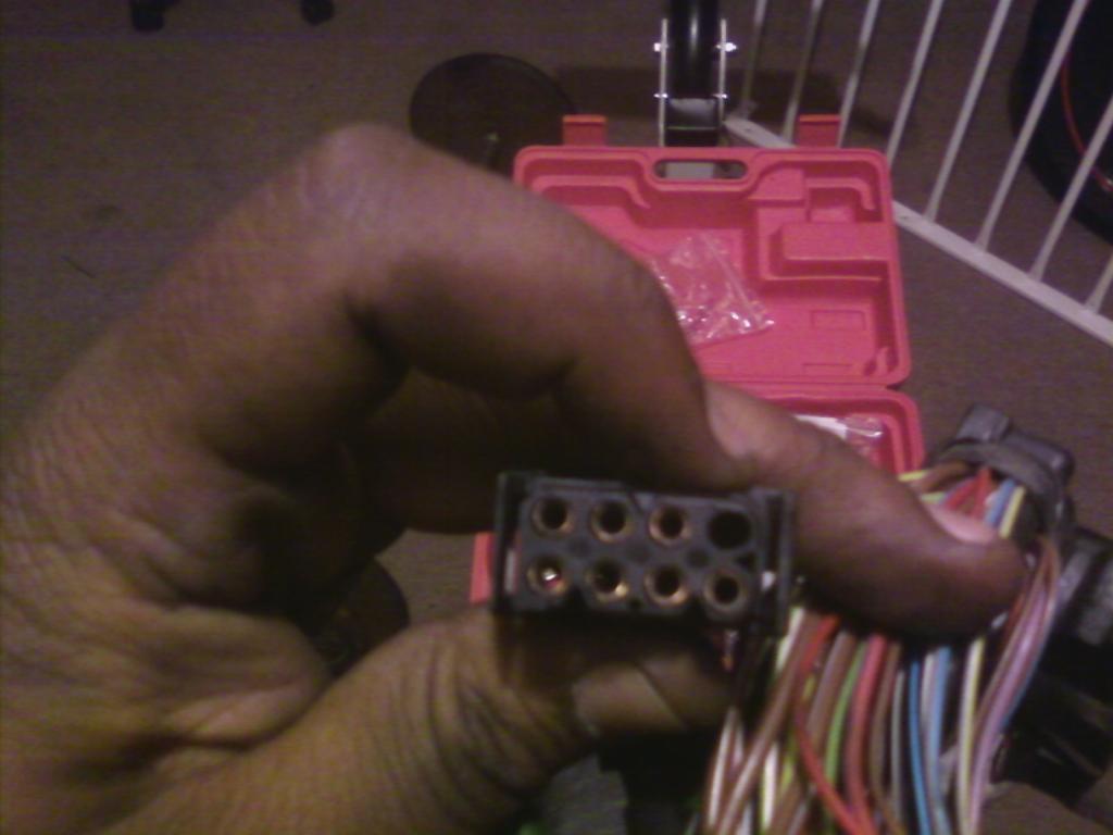

You don't need to do anything with that plug...ignore it.
Pin outs have been posted here many times....you do want to look at the ETM for YOUR specific model / year though.Mtech1 v8 build thread - https://www.r3vlimited.com/board/sho...d.php?t=413205
OEM v8 manual chip or dme - https://www.r3vlimited.com/board/sho....php?p=4938827Comment
Thanks BDK, looks like im gonna have to go that route bcause im getting confused lolComment
