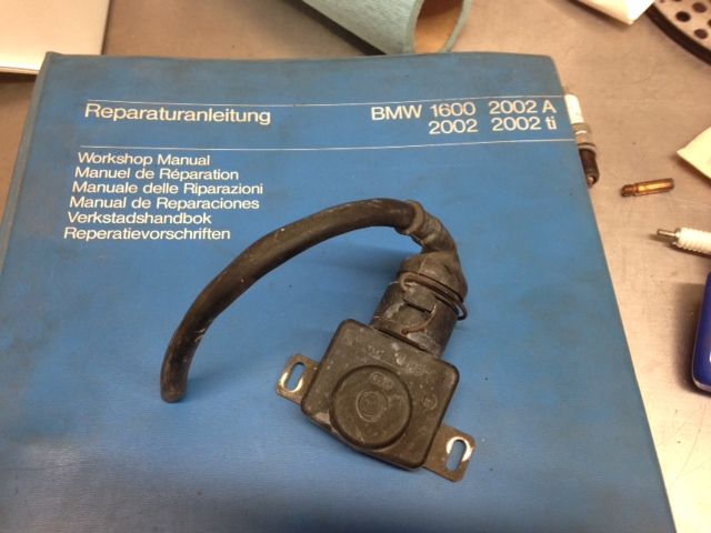

                          Yoo Hoo !
                          What's your shipping address?
                          Assuming you are interested....
                          Lorin
                          The M30 is God's engine.

                              #329
                              Originally posted by RagtopE30
                              ^thank you!!! I will on you my address.
                              For the TPS or the book ?
                              Alice the Time Capsule
                              • RagtopE30
                                • Dec 2010
                                • 1869
                                #330
                                Actually he was referring to the mig welder tip that I have been needing for a while
