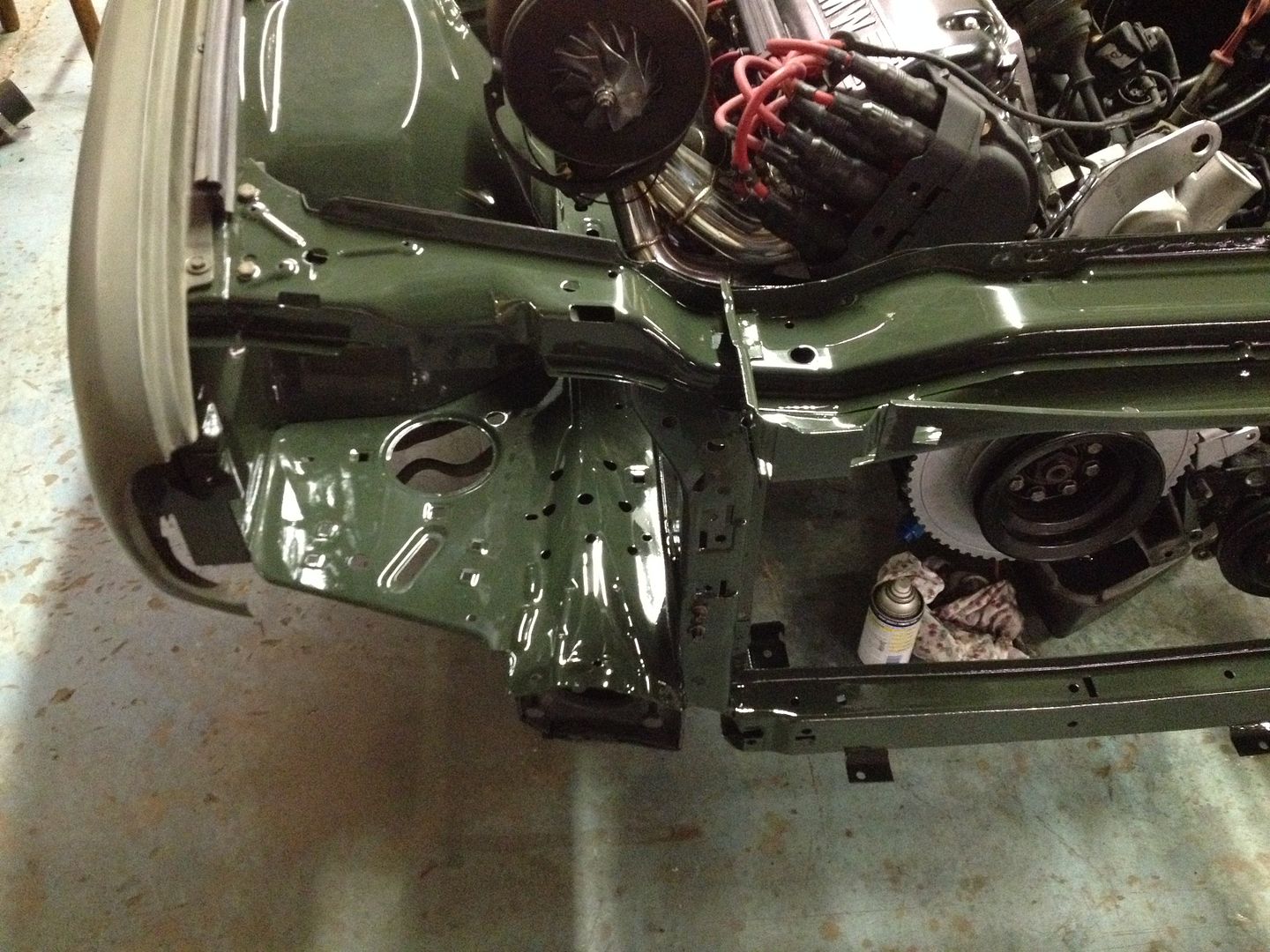

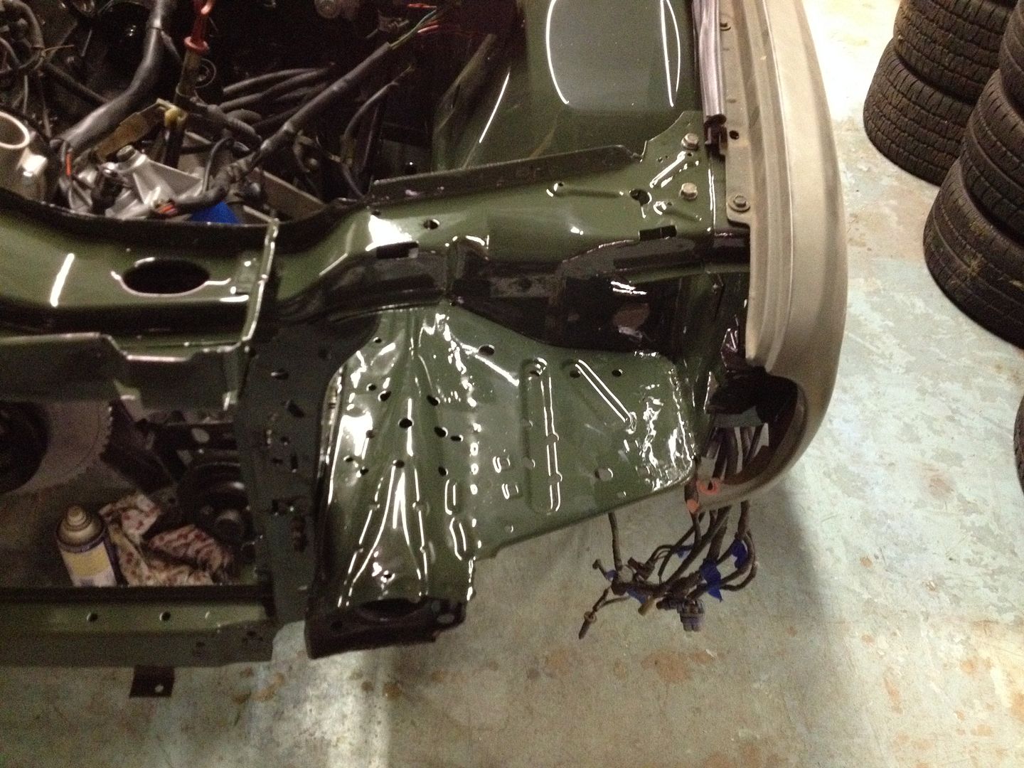

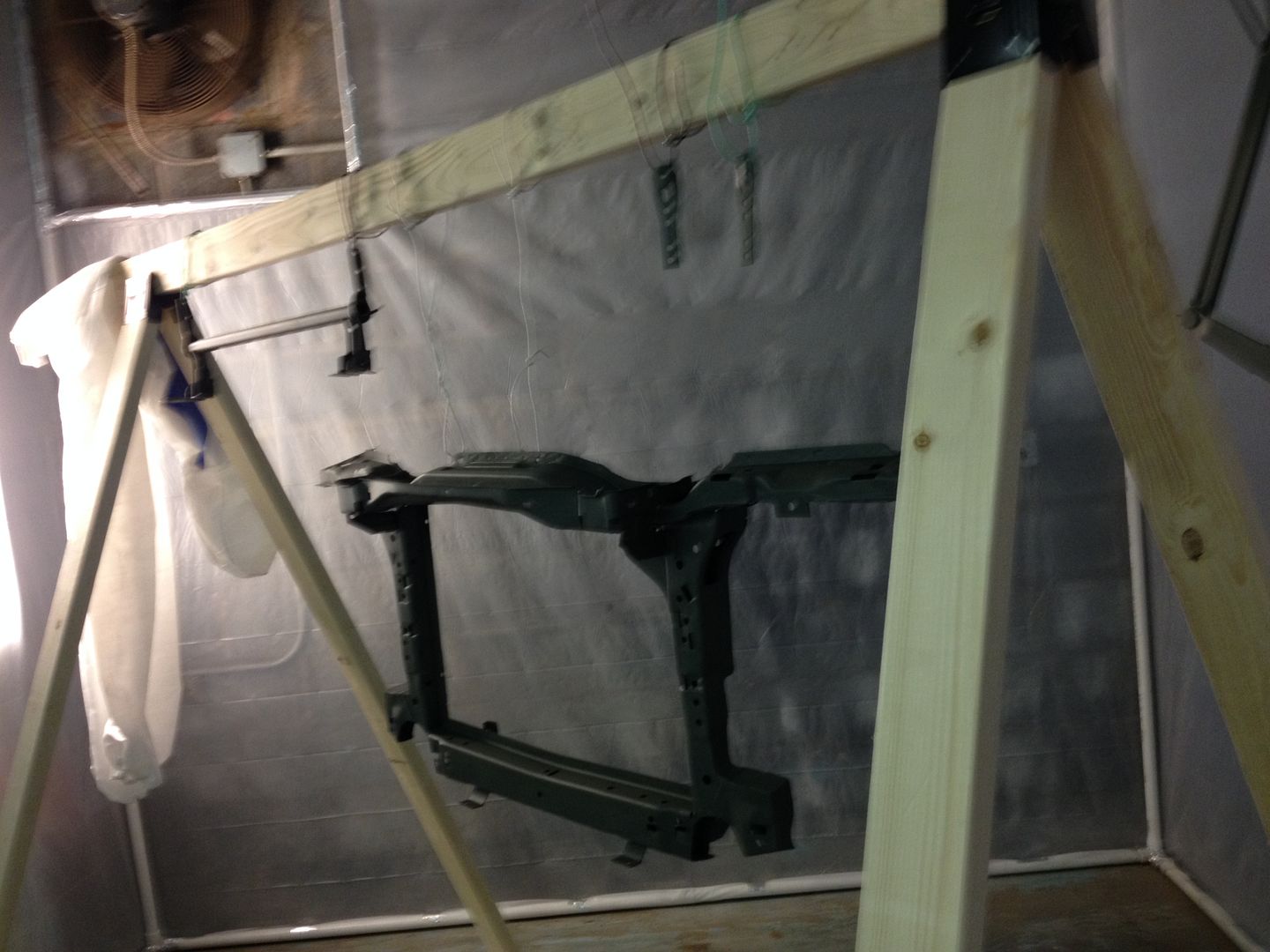

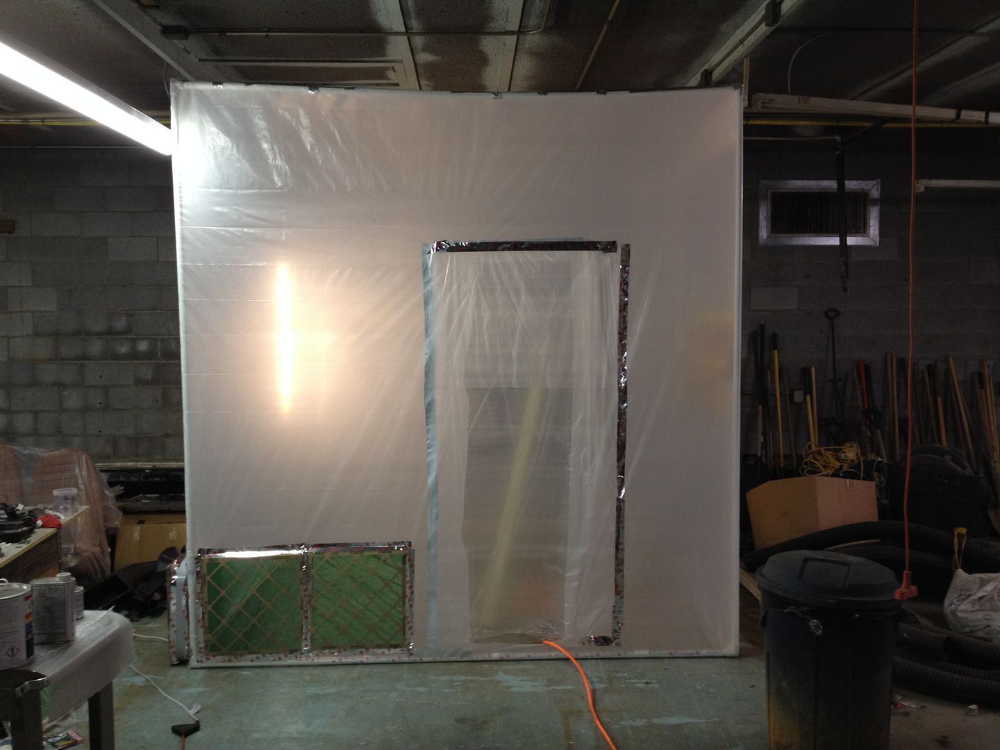

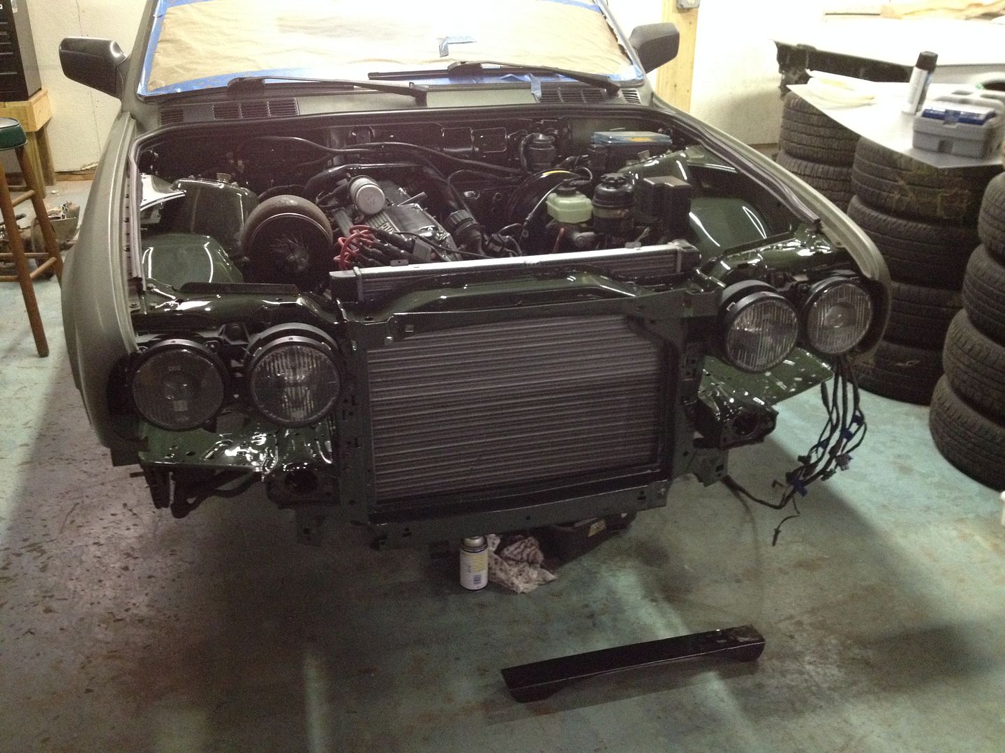

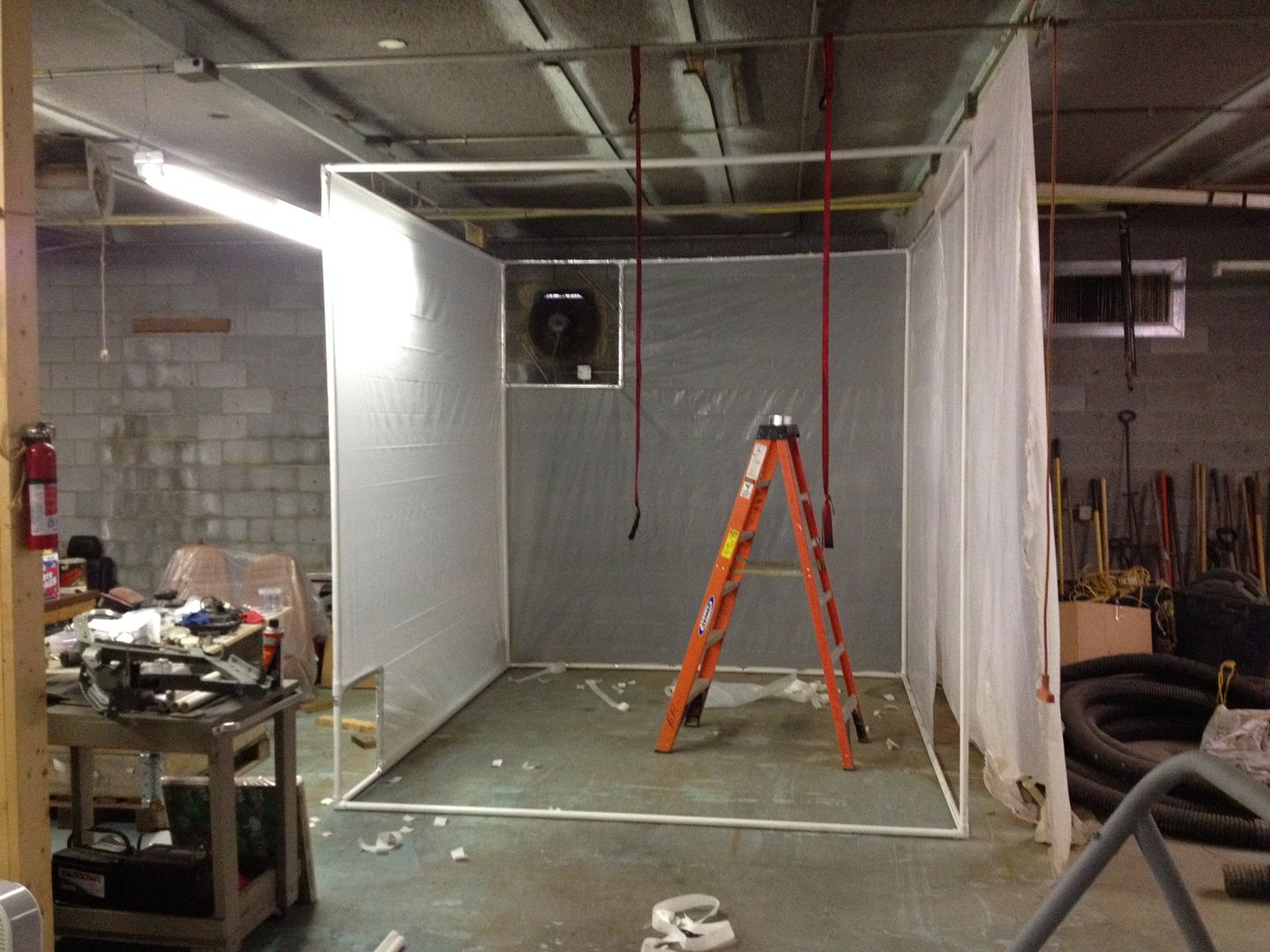

    I got more work done today.

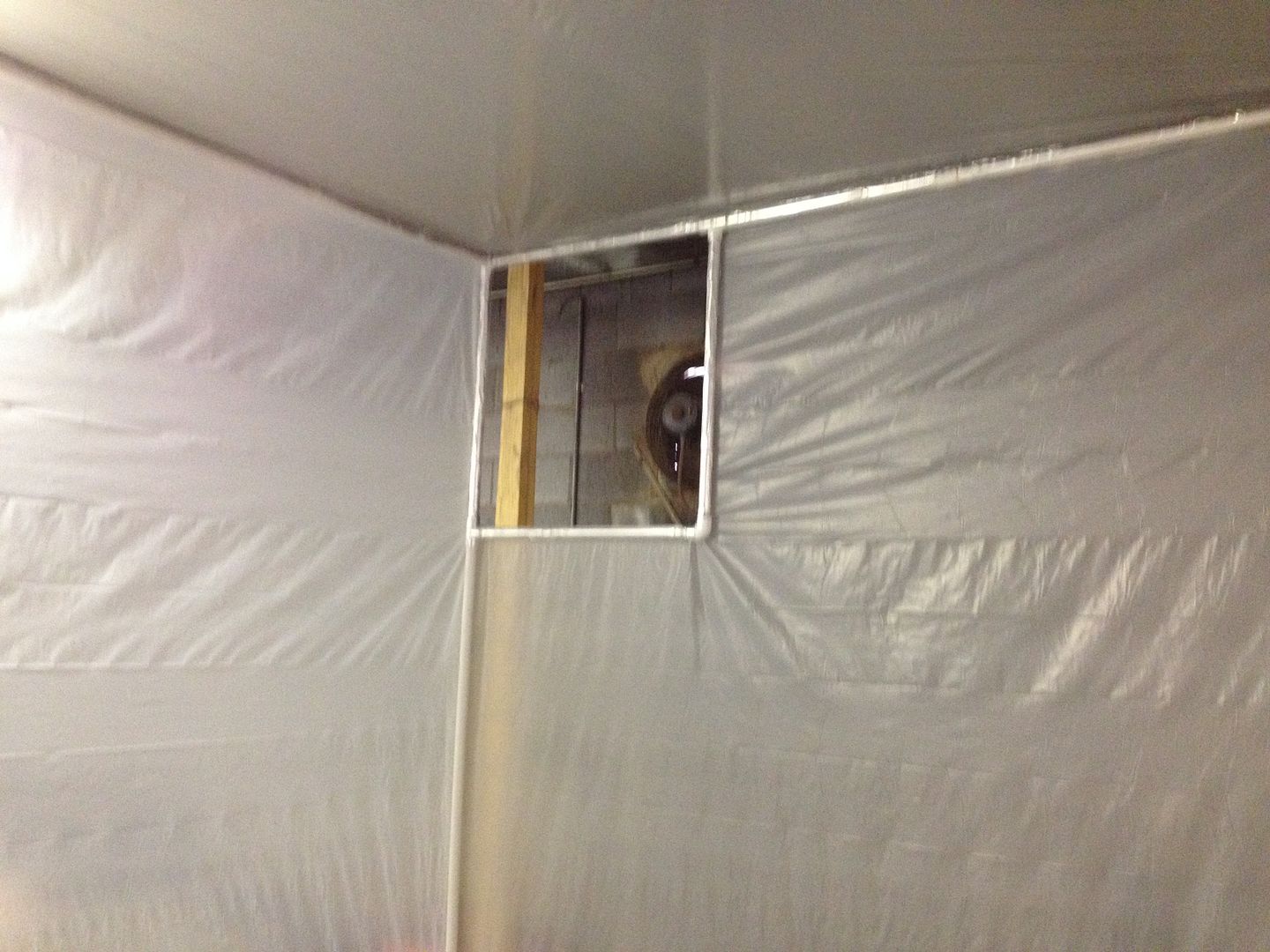

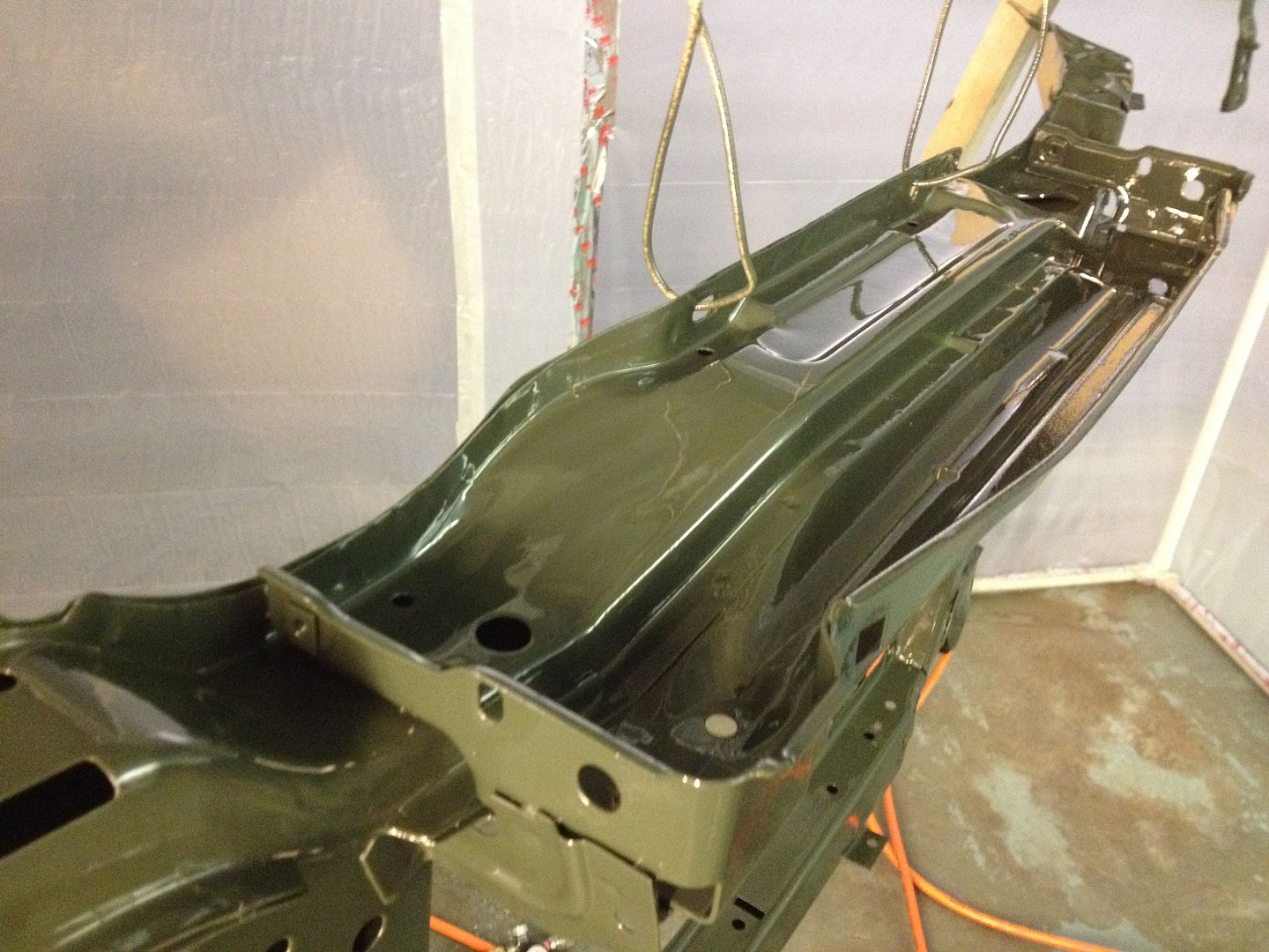

    Spray booth wrapped and completed.

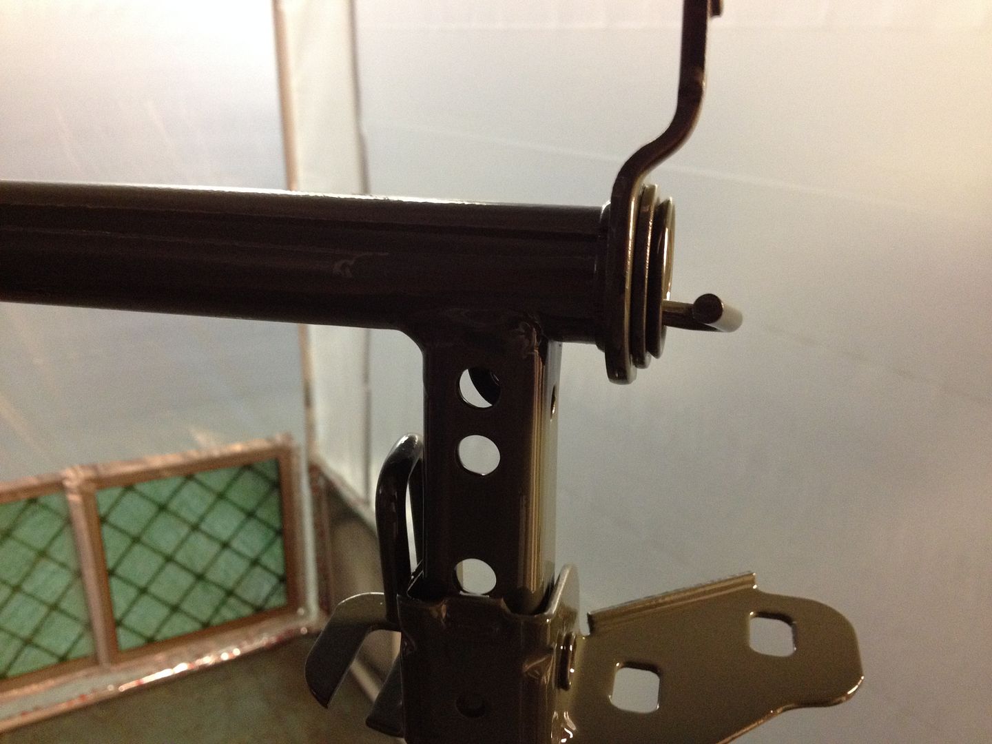

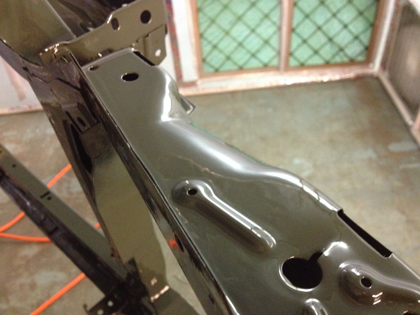

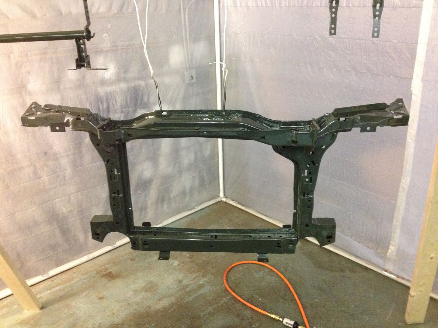

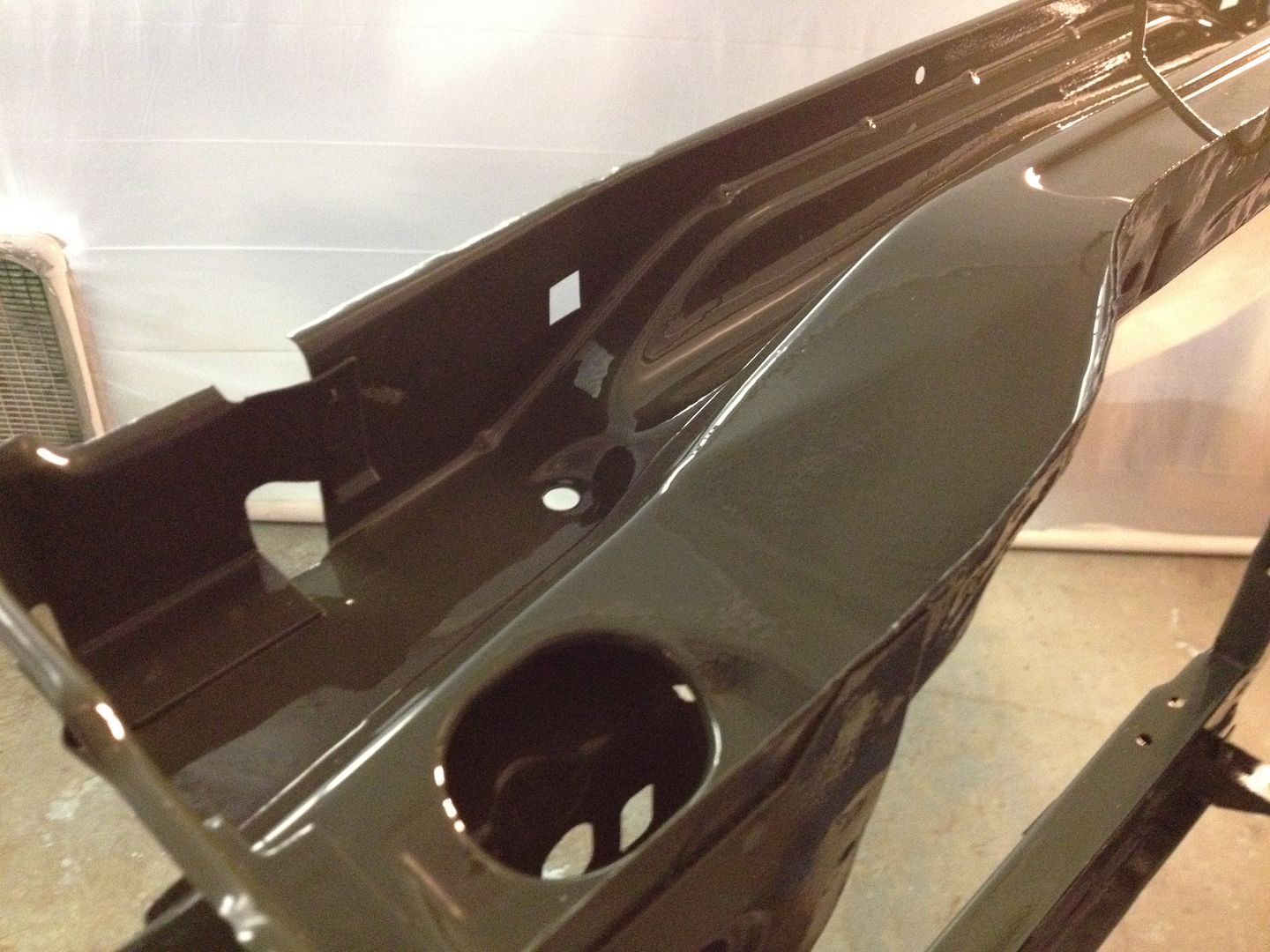

    Then I loaded it up with a cheap 6' tall saw horse. From that I hung all the remaining parts that I needed to paint including the radiator support, hood hinge assembly, etc..
    There is a fan on the left side of the booth and I pointed the shop heater at the front two filters and let the booth and parts warm up.
    Then I painted!!! Check out the results. And yes if you look closely you will see some mistakes but I am happy regardless.
    Now to wait for them to cure. I should be able to start final assembly on Wednesday. And now that I have my SPAL fan I can officially install the radiator support for the last time during this build.

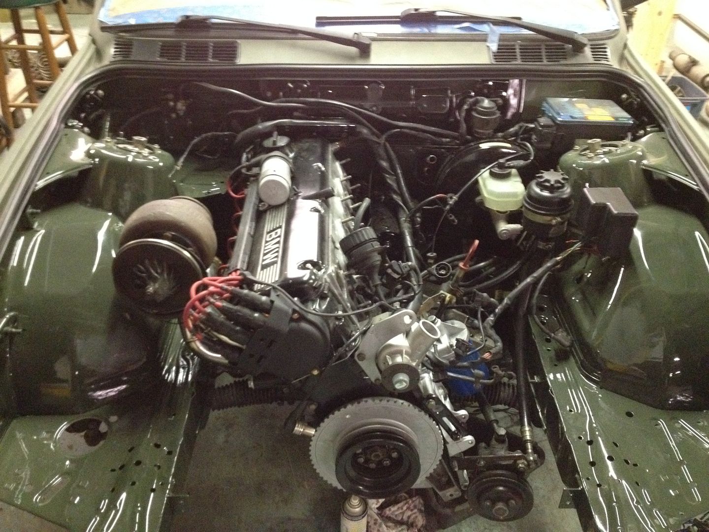

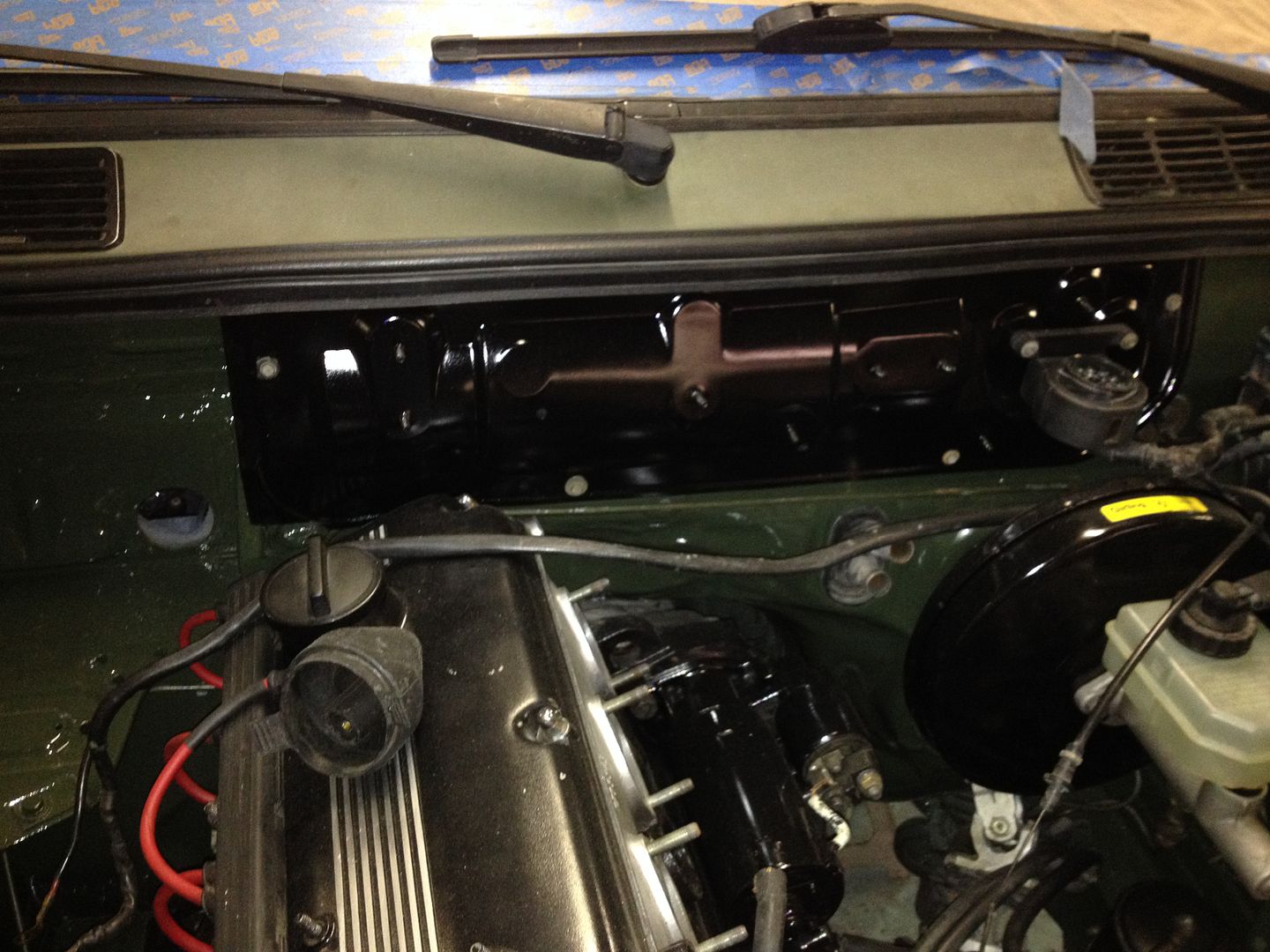

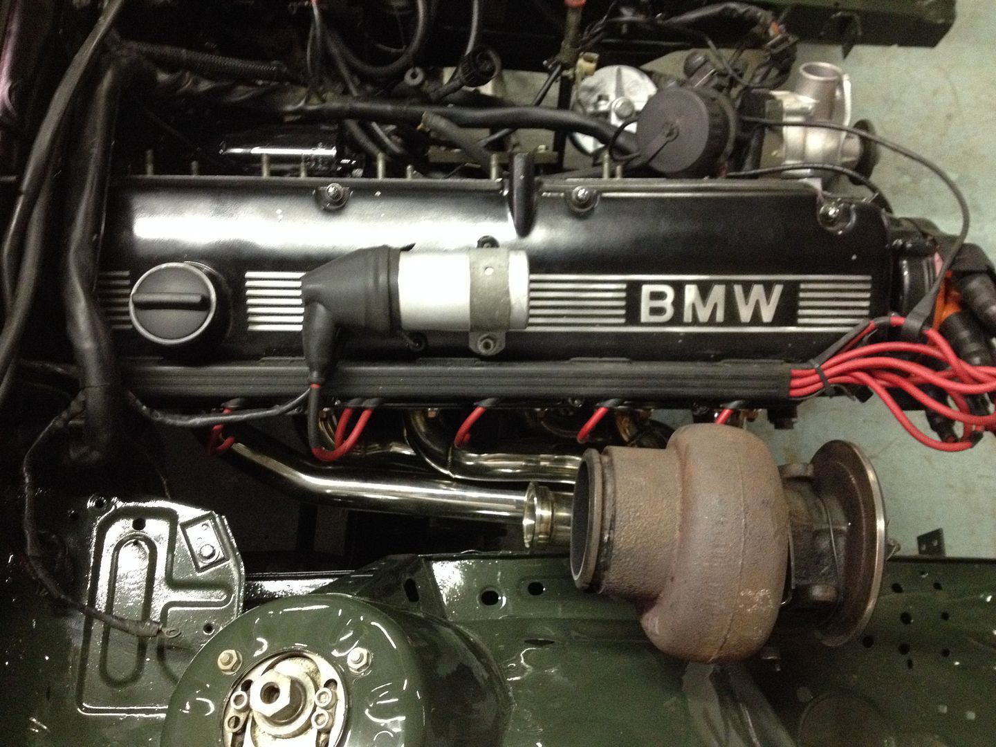

    And since I had to wait around for the paint to somewhat cure today I made some progress on the actual car.
    I put on the Bavauto sparkplug wires from my M20, I just had to put them into the M30 wire cover.
    I also reinstalled the freshly painted blower motor cover.
    And I put the wiring harness back in the engine bay.
    I relocated the coil to avoid the coil wire being draped over or under the down pipe. And I plan on mounting the wasted spark coils in the same location when MS happens.

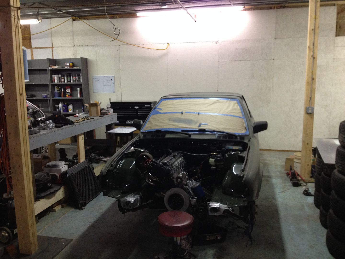

    Oh and in the last couple of days I did some shop improvements. Notice the wall behind the convertible, NO more exposed studs and a coat of paint made a huge difference.

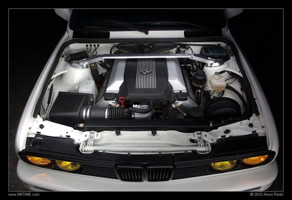

            Hey RagtopE30, I am doing an M30 swap into my E30 right now as well. I found a couple strut bars that will fit with the resevoir mounted on the firewall. I know it can be done, but could only pull up 1 pic I had saved:
            Not an M30 in the car, but I'm sure the strut bar would work with it as well?

              Sweet! Now we just have to find out who makes it.

                #172
                Innoparts, they're located in Germany I believe.

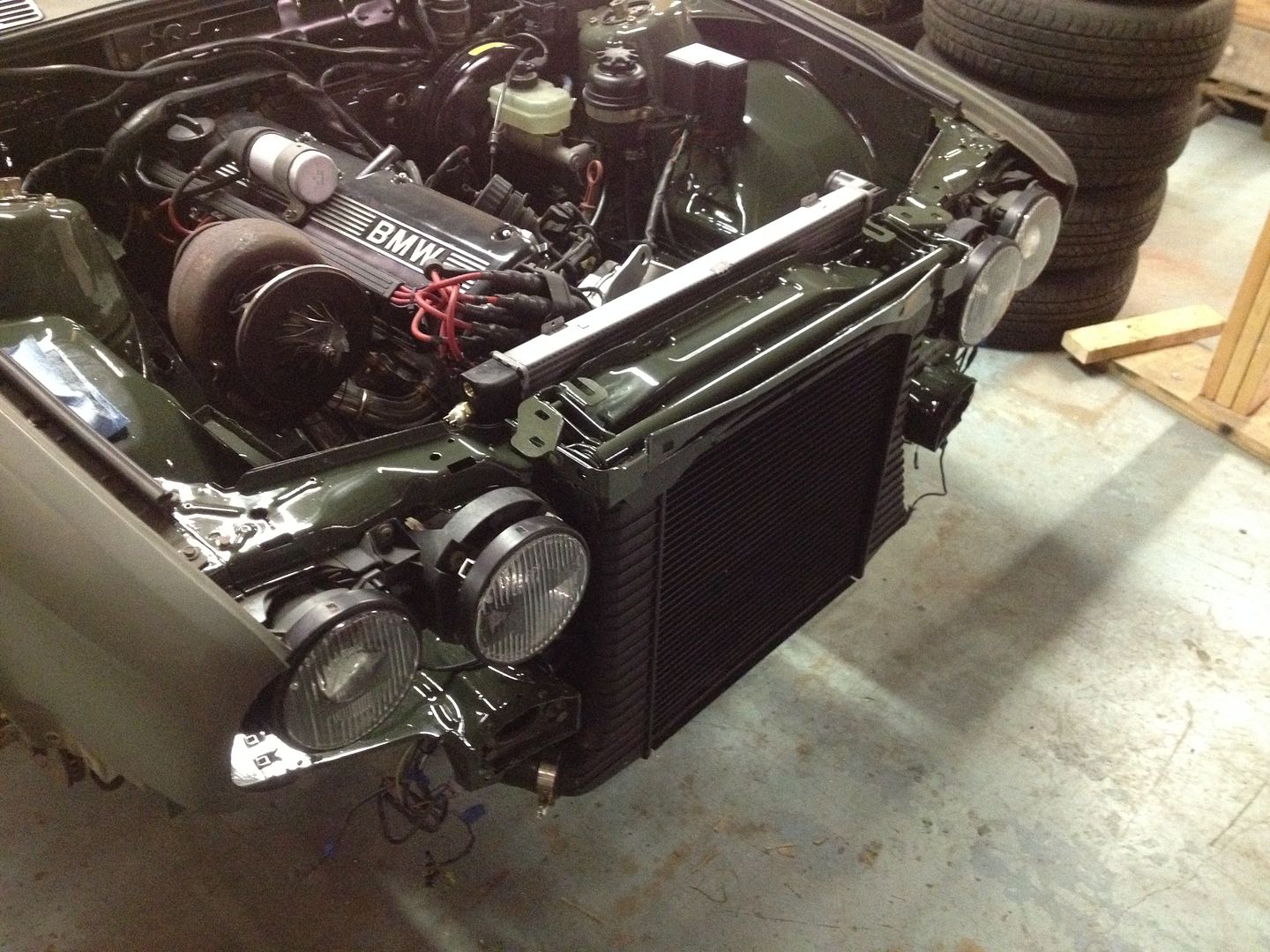

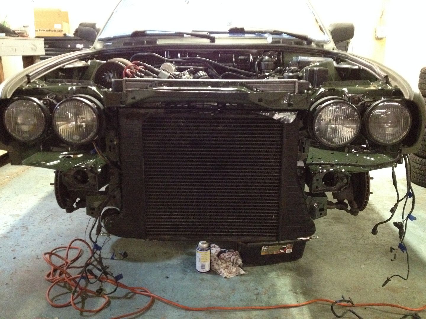

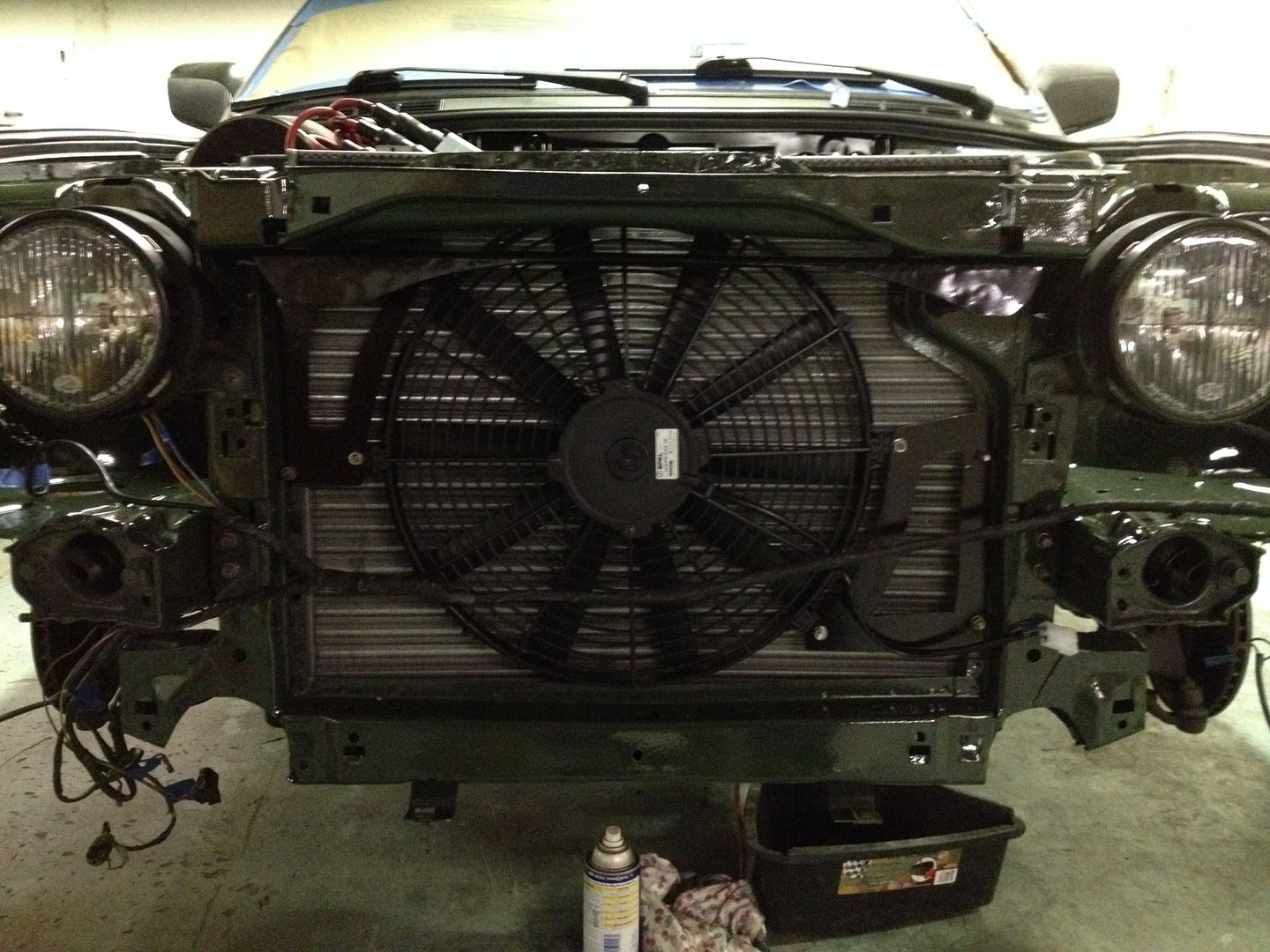

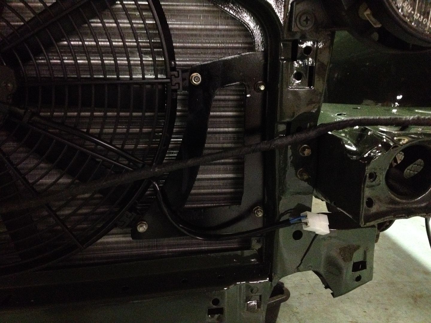

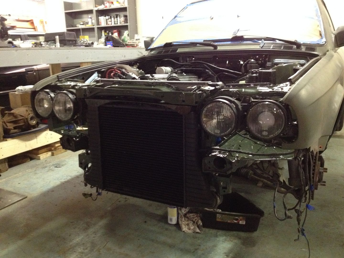

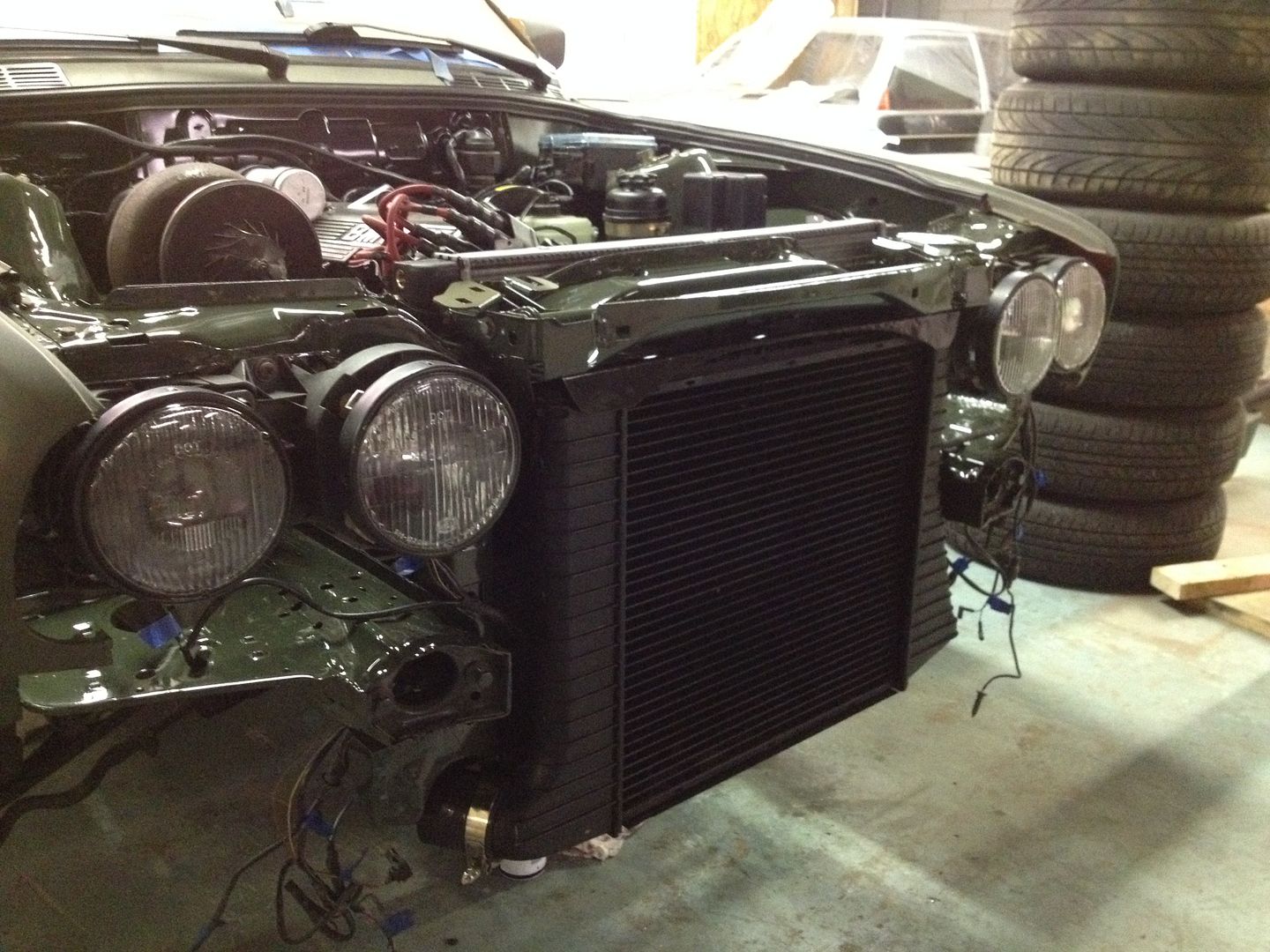

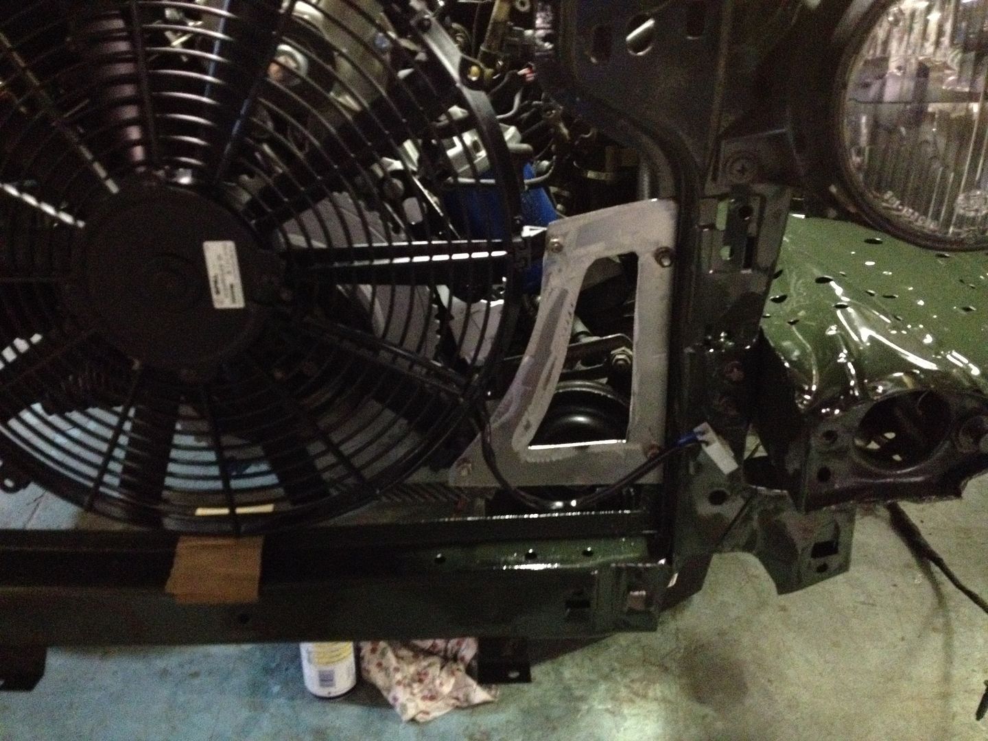

                            OPERATION: Removable Radiator Support and Intercooler install and Engine Bay Paint and Wire Tuck and Hood Release Cable Tuck and other stuff, IS COMPLETE!!
                            Got some work done today.
                            I mounted the headlights

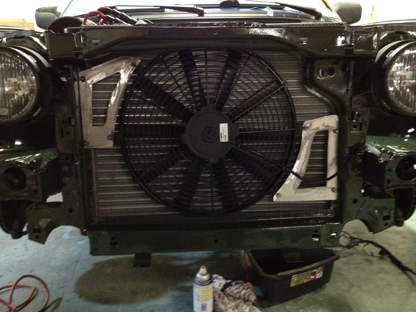

                            I then started working on mounting the SPAL fan. I had to make some brackets.
                            Then I went ahead and mounted the intercooler with the fan in place and the wiring pulled across the radiator support to ensure that I didn't make any mistakes with clearances. It looked like is was manufactured that way!!

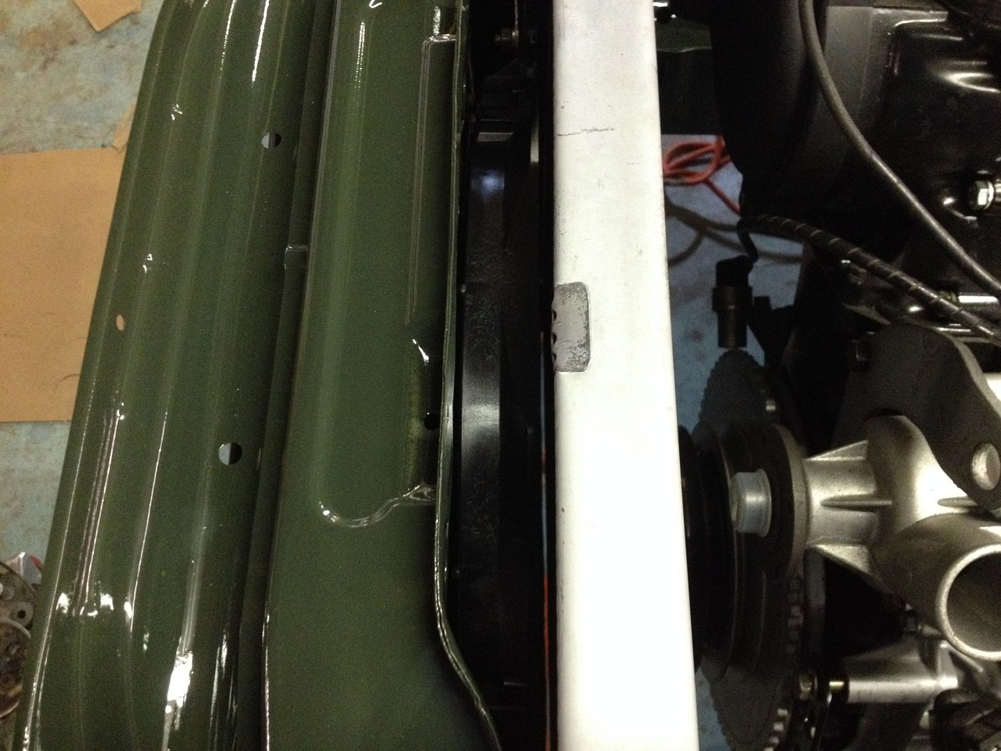

                            Then I disassembled everything and painted the brackets. And finally remounted everything. I cleaned up the intercooler and reinstalled the hood hinge mechanism and the hood shock arm.
