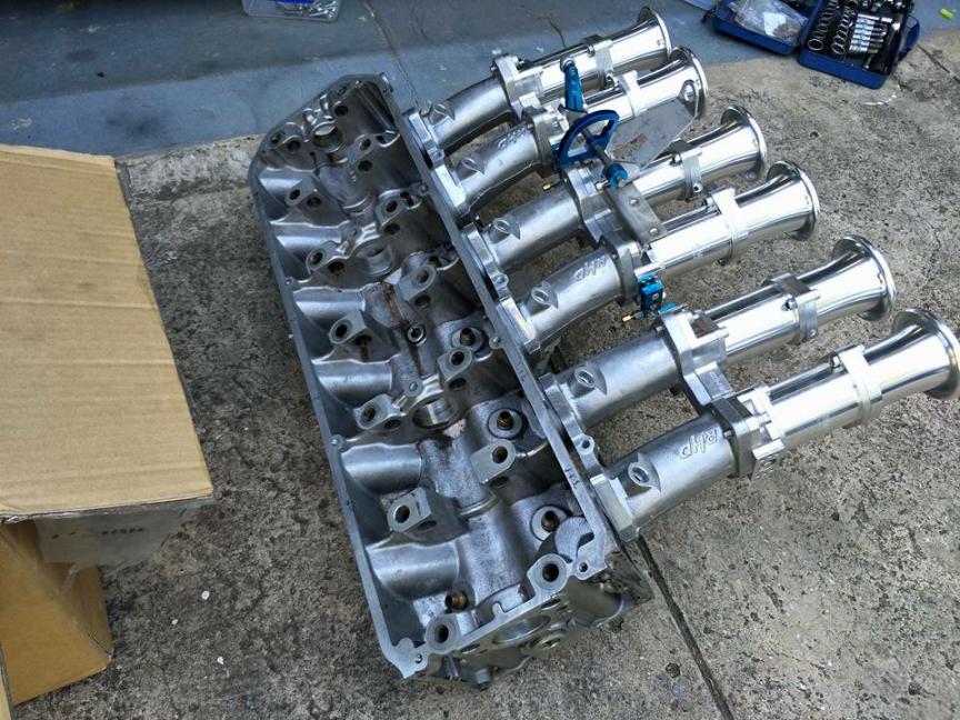

                      I’ll be adapting the maf to be fitted to a m30 turbo build going into the fiancés car, with my only reasons to moving away from the millar setup being RHDengineeing’s m30 itb kit which he used my head as the mock-up & design part
