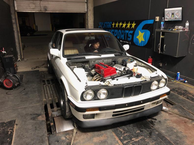

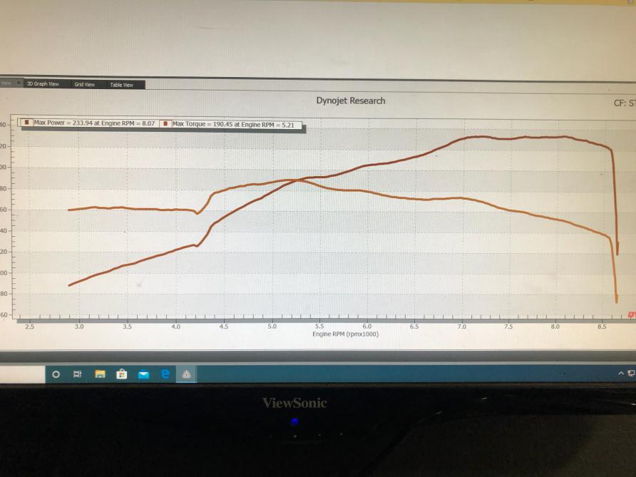

                                We got the car on the dyno last night! Our very simple OEM combo made 234whp, 190wtq, rev limiter at 8600 rpm, although we'll probably shift at 8300 on track. It's a K24A2 bottom end, with a K20Z3 head. The K20 head flows lightly better than the K24 head and is worth less than 5 hp on this engine, but it was what we had available.
                                I took it around the business park afterwards and it's a riot. Oil pressure was constant at 90+ psi. The AKG engine mounts also feel amazing. It feels like a factory car. Power steering works like stock and feels perfect. Overall I'm thrilled with our execution of this swap, I don't think it could have come together any more nicely. Here's a link to the dyno video on our facebook page.
