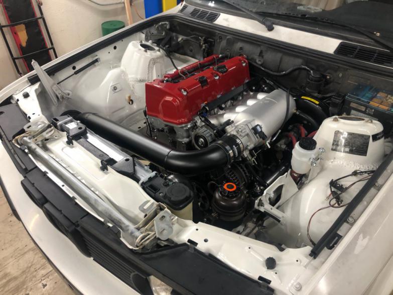

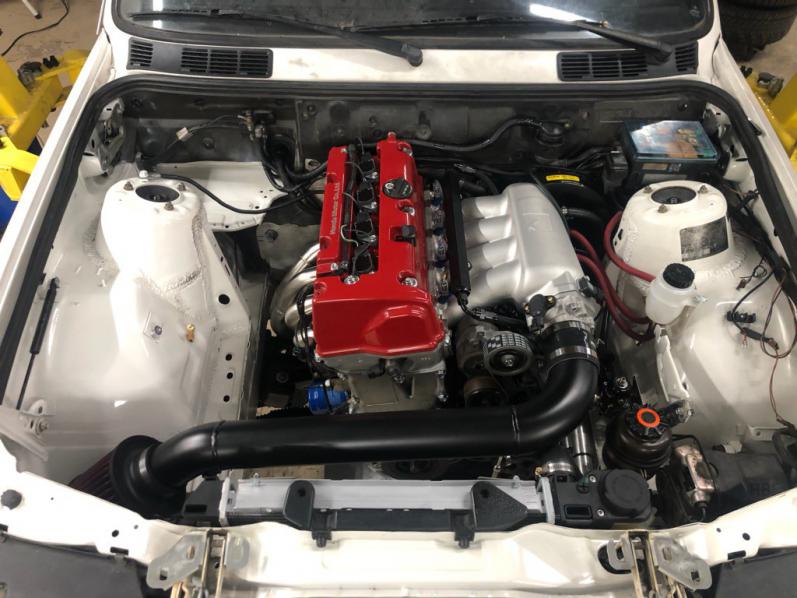

                            Hey guys, just wanted to share a long overdue update on our project. From our Facebook page today:
                            Our K24 E30 engine bay is 99% complete and we couldn't be happier with the end result! We have been getting flooded with emails and phone calls about E30 parts lately, so here are answers to the most common questions:
                            1) Our goal is to have the complete swap package for the E30 available in the first half of 2020.
                            2) Pricing has not been released yet, but the fact that the stock E30 crossmember is retained will help keep costs down.
                            3) No, we don't have any pre-production parts for sale. Everything will be thoroughly tested on track before production begins.
                            4) No details on E36 swap parts yet.
                            Thanks for your interest and your patience!
                            David Calzada
                            KMiata Inc.
                            KMiata.com
                            • 2mAn
                              SeƱior Mod
                              • 21078
                              #509
                              With all that development time, did nobody question the idea of running the intake tube right behind a radiator?
                              That engine looks nice in there though. Good job

                              • E30SPDFRK
                                • 5716
                                #510
                                Your Miata roots are showing with that intake
