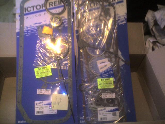

              #81
              Looky what I just got! I know its nothing big to you guys but I was pretty excited!:nice:
              oo..and there is a TON more gaskets than I originally thought

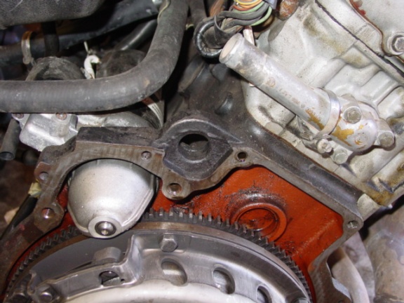

                    #84
                    There is a mounting hole in the rear above the starter. clip into that. hope you have skinny arms!!! There should be a lift hook in the front.
                    Joe Funk -- Portland Oregon
                    That Guy.
                    03 X5. 3 liter obviously.

                        #86
                        pic
                        That Guy.

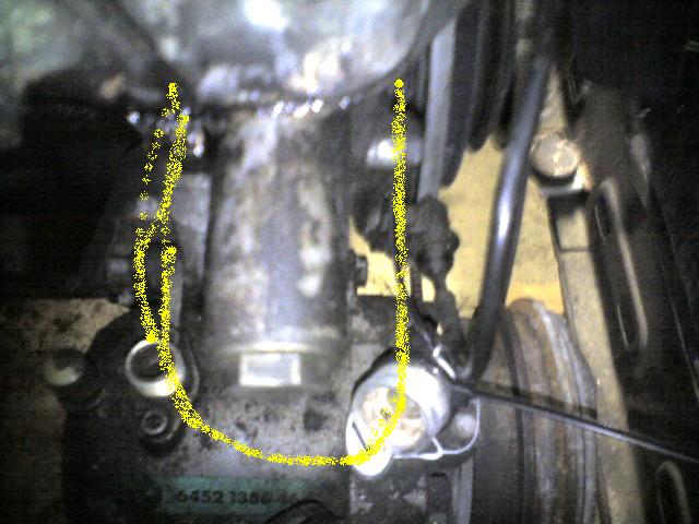

                            #88
                            Just a quick question to make sure I do this correctly.
                            I will connect 2 chains to the rear of the motor (Joe's presented picture) with a hefty ass bolt and nut
                            Then I need to connect the 2 front chains to something...is this where I need to connect to or is there some where else? (I only see this one so I dont' see another on the other side)
                            Thanks
                            • george graves
                              • 19996
                              #89
                              Not there, that is your timing chain tensioner.
                              Keep looking - it's by the t-stat housing if memory serves.
