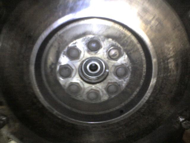

        I am trying to get these lovely bolts off and the flywheel just keeps on spinning. I don't want to jam or put anything in its path because I don't want to replace it for broken teeth.
        So how do I keep the flywheel from turning?
        Thanks

          #94
          Air tools, or, put a breaker bar on the crank nut...
            Yep a screw driver will not f-up your fly wheel if you have a friend sit on it.
            Find a fat friend - or in a pinch - a emo guy and have him hold 100 pounds of tools - just tell him it going to be a awesome "my space pic ---he'll do it..

              #96
              Haha, alright Ill try to find an emo kid while I am out.
              Thanks

                #97
                flat blade and a friend will do the job

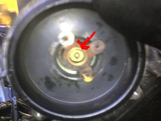

                        One, how do I get to TCD with the motor out of the car? HAYNES SUCKS!!! I want to get the timing chain off so I can get this head off by next week.
                        Two, How do I loosen this damn bolt? I have tried everything..maybe!

                                Alright, I have everything stripped down but I still can't get the head off.
                                I need some advice on the timing chain. I got cylinder 1 to TDC by lining up the O | T with a small section sticking out of the block.
                                So I still can't get the timing chaing off. How do I get the timing chain off? I want this damn head off!
