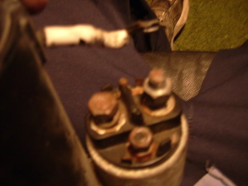

                              What terminal do I mount the white wire on?
