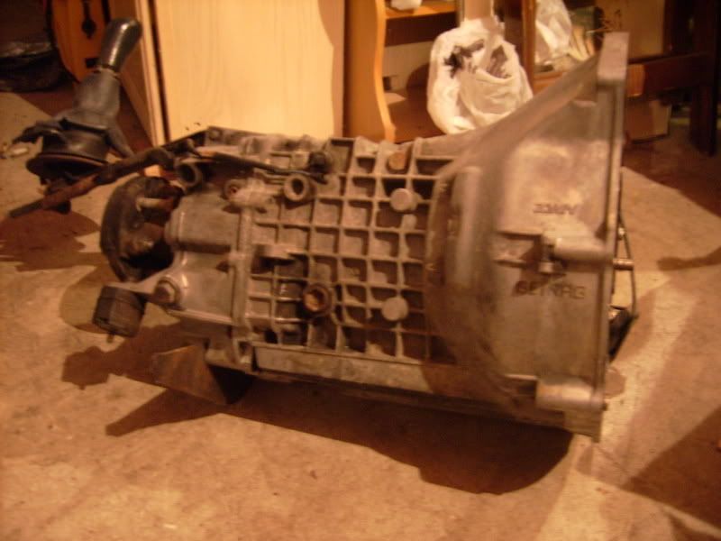

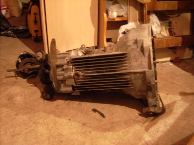

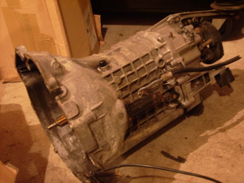

                        Pics of my transmission for clarification:
                        Does that look like a 260/6?

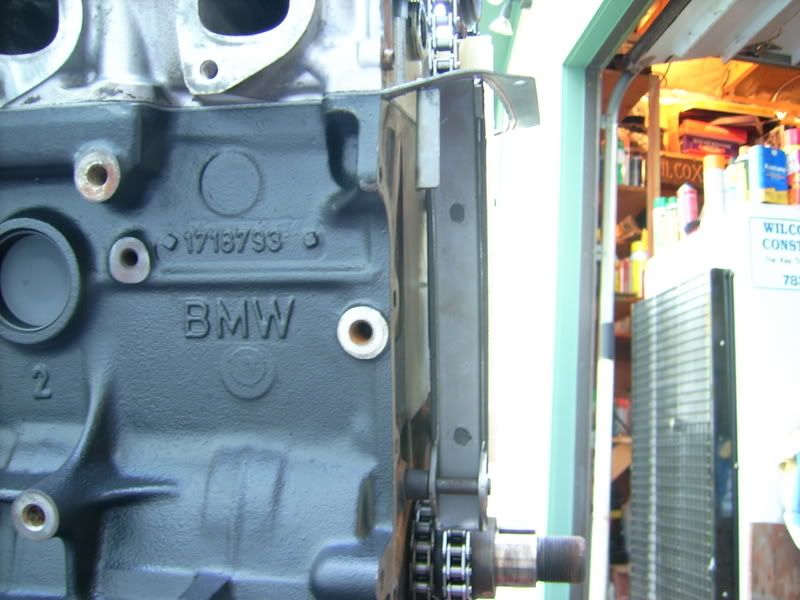

                          Which way does the tensioner spring go? I forgot to check when I took it out.

                          • speedhop
                            • 1509
                            #58
                            I thought that the 280 only came with ribs like that...I could be wrong though.

                              Ok, wtf is up with this.
                              My tensioner doesn't line up with the tensioner rail. Is it supposed to fit this way? Everything seems to be in the correct place, but the chain isn't centered on the rail.

                                #60
                                yes, it is a 260, the 280 has the fins (i think) but the 280 is abit longer, it has another piece (about 2" spacer piece, if you will) between the rear section and the main body...
