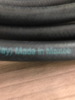

        Perfect timing on the thread, I am currently in process of simplifying the mess under the intake, and other proximal updates. THANKS!
        Just ordered Gates 27348 Barricade Fuel Injection Hose-15' Length, Inner Diameter 5/16" from Amazon I plan to replace all soft fuel lines in my E30 and E46.
        ~$55 +tax, delivery thru Prime targeted tomorrow! DONE
        Incidentally,
        27348 - 15 ft spool - shows country of origin = USA
        27340- 25 ft spool- shows country of origin = China, picture shows "made in mexico".
              If it matters, I checked my 27335 hose and it says, "Made in USA".
