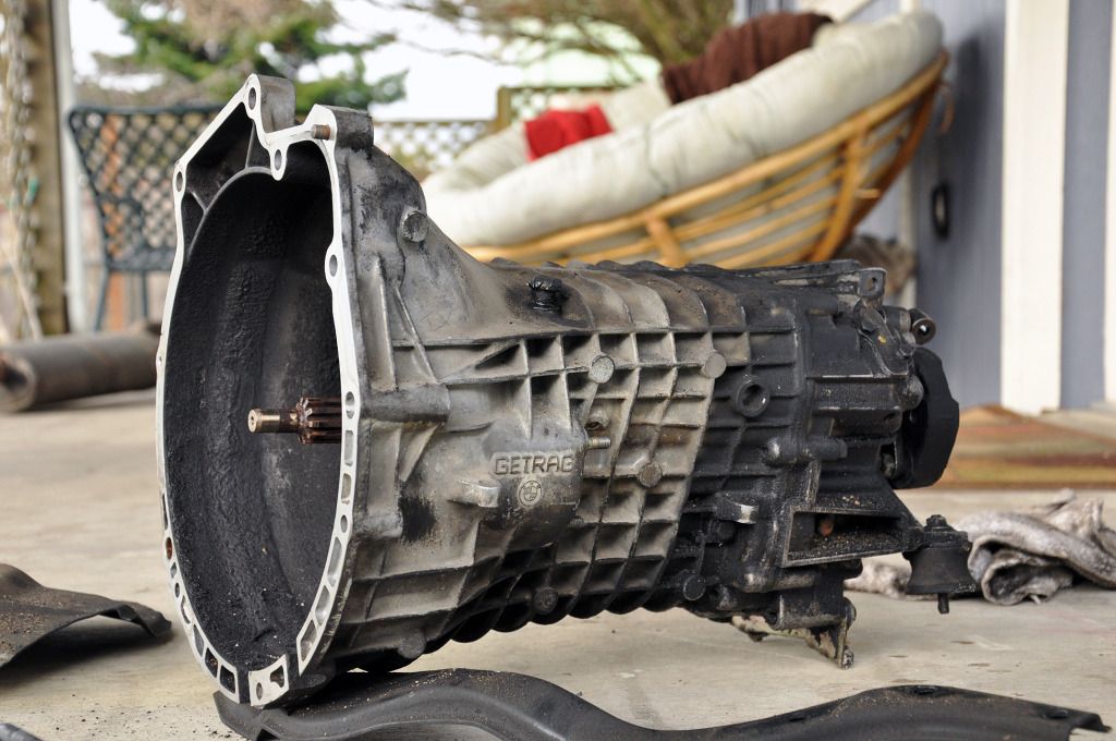

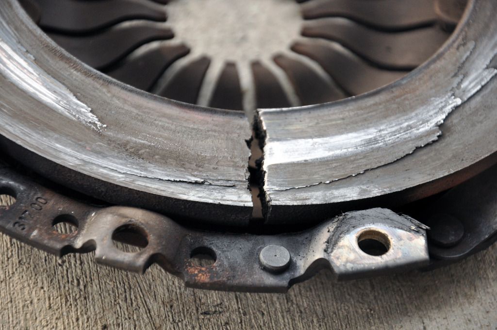

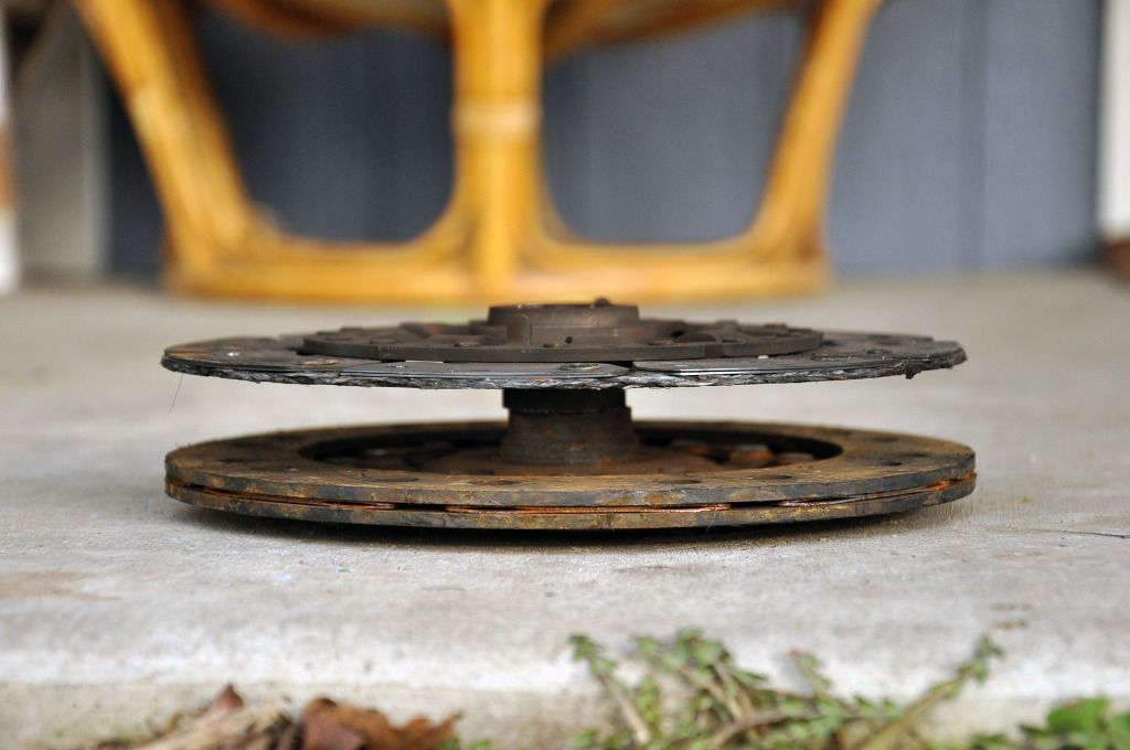

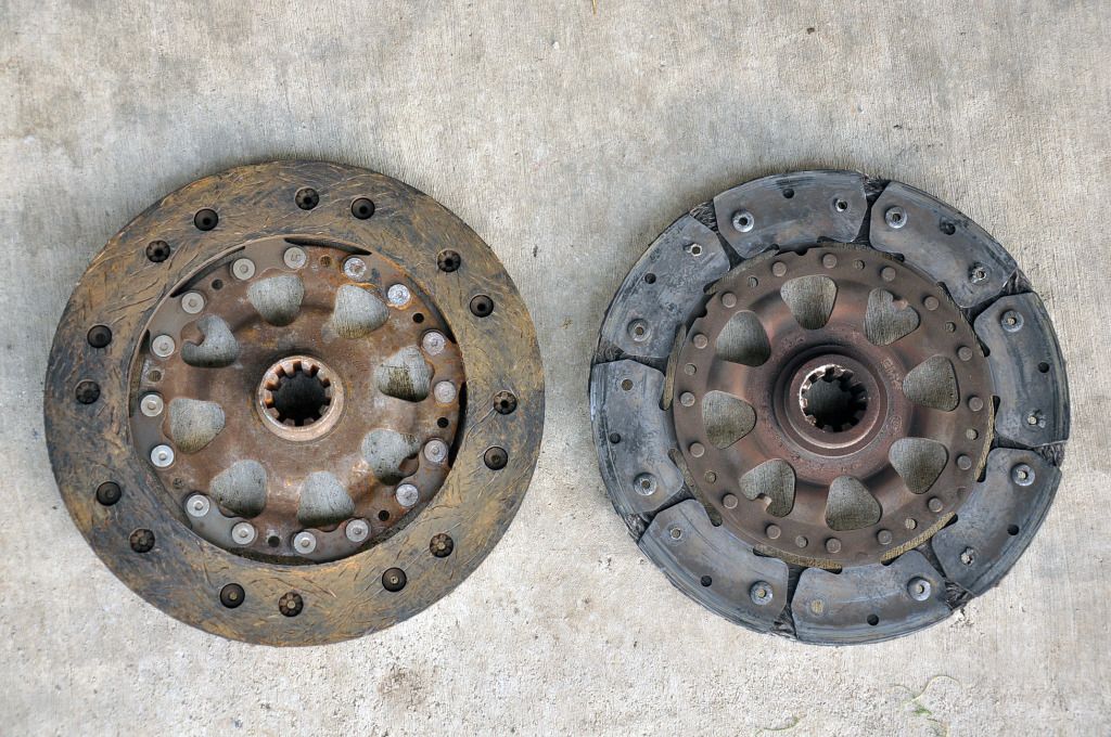

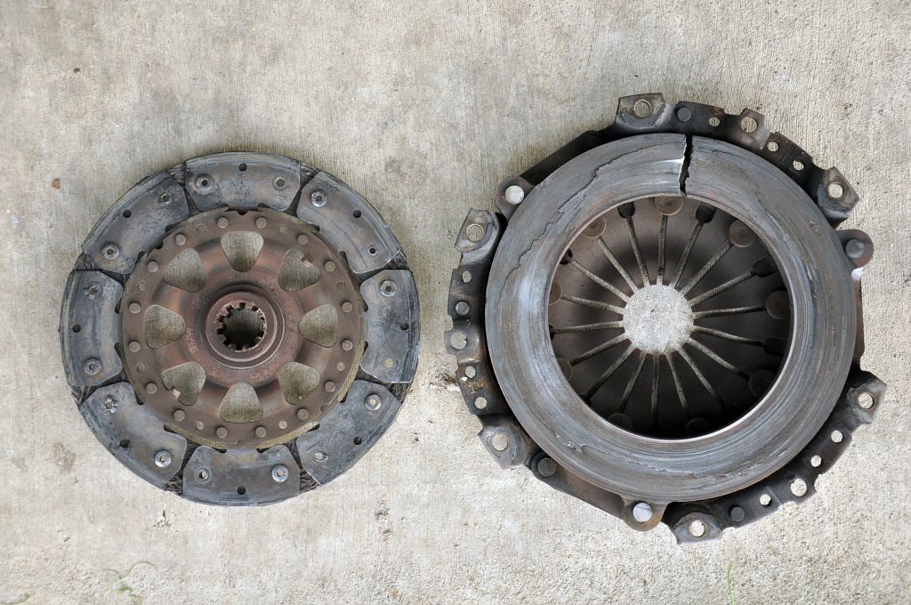

    In the process of replacing my clutch (as most of you know by now from all the help threads ) but once it came out we couldn't believe the condition the old one was in!
    Let the pics do the talkin:
    Thanks for all your help along the way! Odds are that I'll be asking for more in the near future!

        holy hell that's the most worn clutch I could even imagine. I wonder how long they were driving it with the busted pressure plate. Looks pretty obvious that's what stripped all the meat off the one side.

              Looks like there is a just a little meat left on the bones!
              • Jboss12
                • 357
                How does the new clutch disc look to you guys? I'm debating whether or not to buy a brand new one or just go with this one. Does it look like it has some good life left on it? About what %? Thanks!!
