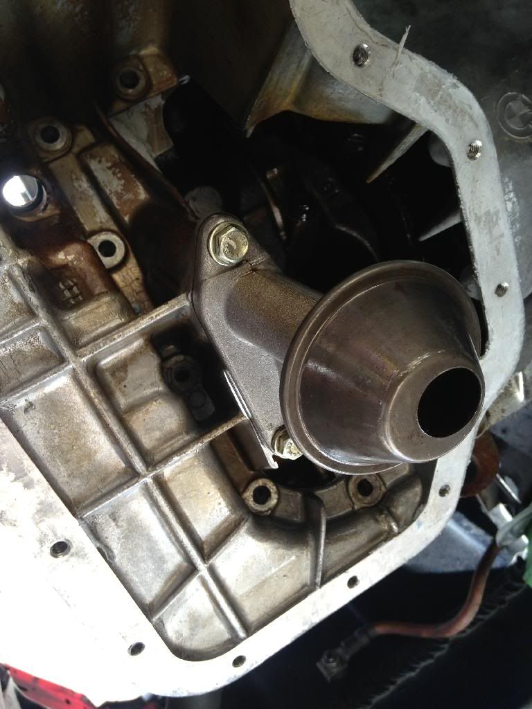

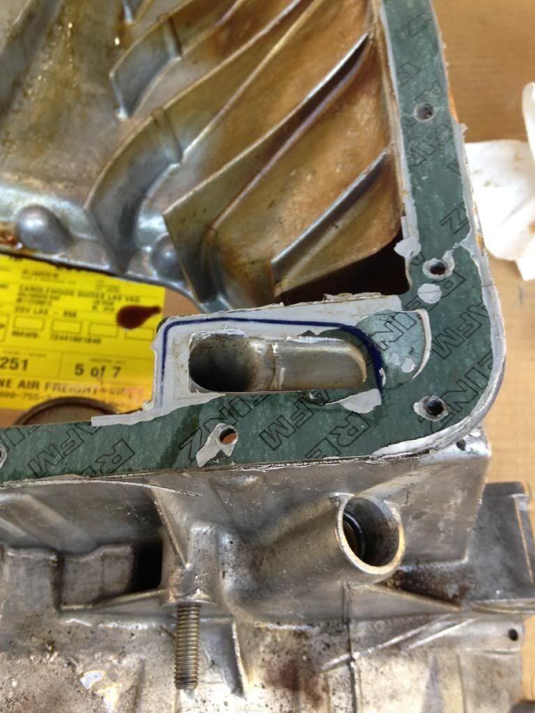

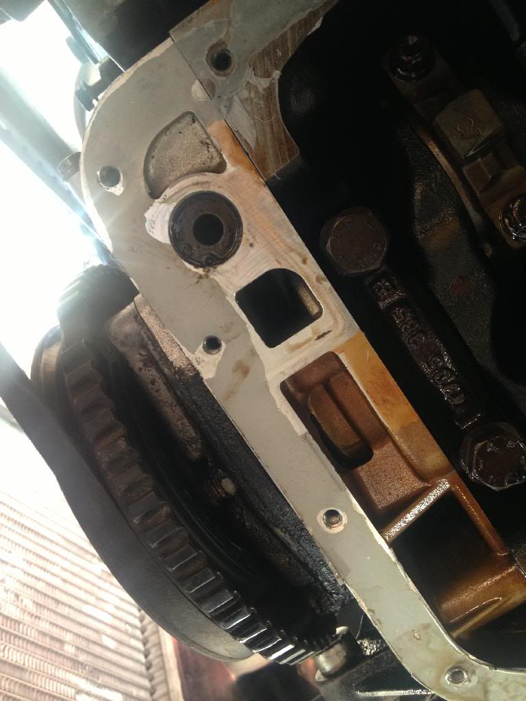

          Okay FINALLY got both pans off. The lower one took forever because I couldn't get it to separate. On the upper I stripped one of the torx bolts on the bell housing and that took a couple days to remove. Fucking pain in the ass. Anyways, here's some pics:
          Oil pickup:
          Gasket around the oil pickup:
          Oil pickup port. Note that it looks/feels completely dry. Would a stuck relief valve cause that?

            Anyone? I'd like to assemble this ASAP but I don't wanna put back together and find out it's like the oil pump or something else.

              It is good that you got the updated parts in. Was the old one stuck or jammed at all?
              Considering how long the thing sat for, I wouldn't be surprised if the inlet felt pretty dry.
              If this wasn't it then I am totally stumped. The only other thing I could think would be that there are no pump geats in the timing case, but if it was running fine before and the case was not off at any point then that is not a possibility.
