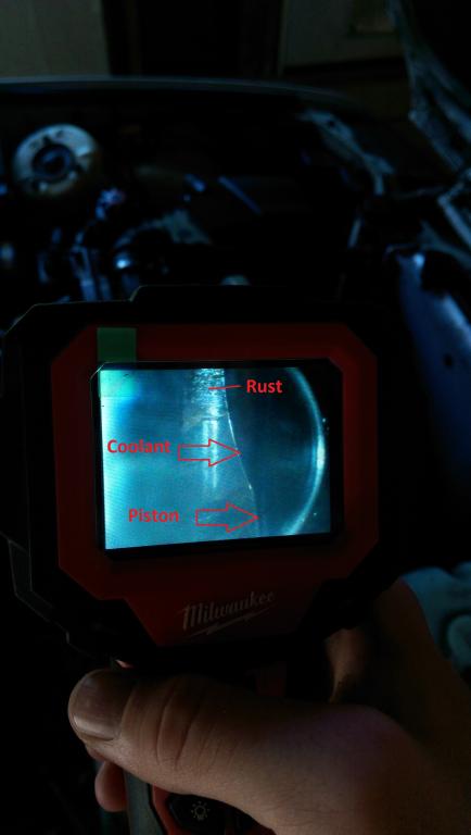

    Now at some point in time. Not sure if it was before or after overheating, it would have a rough start every time I started it when it was cold. I also eventually noticed coolant level was getting lower. Put the two together and you know where this is going. So pulled the spark plugs, all brand new, #2 was yellowish. I put a snake camera down there and sure enough there was coolant covering 25% of the cylinder, and this is with the motor mounted at an angle.

        Here's the #2 cylinder for laughs. This is what gets me to work everday

          ^ Dude. You need a bilge pump stat!

            There's no way I'm gonna take the time to pump that out every time I go for a drive.
            I just have to refill the reservoir once a week. That's about 12oz or so. Not bad...?
