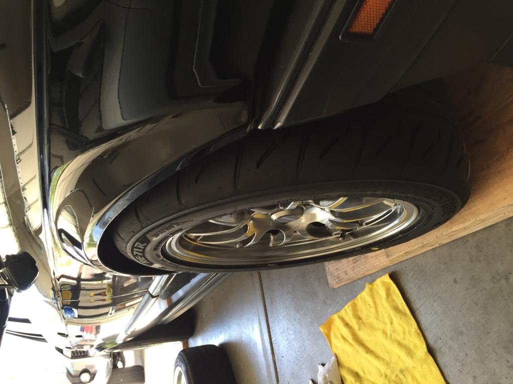

        • m42'd
          • Jan 2016
          • 37
          Cars..
