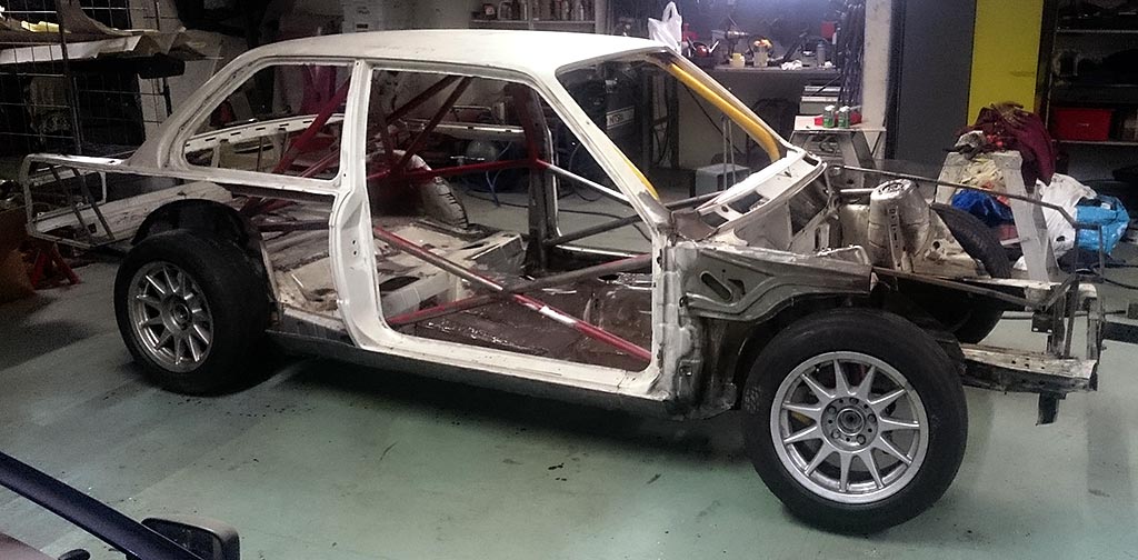

      Here is the car before I moved it to my own garage on the end of summer. Bottom of car has allready painted, interior still needs a little paint to look nice :) After that I can install all the glassfiber body panels so it will look like a car once again...
      I going use a big as possible generic aluminium cooler with a ECU controlled(on/off) electric fan. Because of PWM controlled waterpump I'm going to use 2-3 temp sensors around the engine(head is the critical part). I'll use ceremic coating on exhaust parts to reduce engine bay temp. If the turbo comes too close to the engine, I'll use probably a heat blanket for it. Turbo should be around where the washer bottle was.

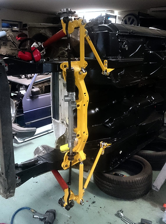

          In the picture: front axle with selfmade(had a professional welder to weld them together) cromo wishbones. Mechanical steering rack is 2,5 rotation left to right(custom part inside). Shocks are missing coils so there is a piece of steel tube working as bumb stop :) Tie rods will need about 3cm threaded extensions because of quite a bit wider track. Wheel hubs have 5-bolt pattern

            That's so cool. Is the placement of the heim joints in your suspension arms compensating for bumpsteer?
            Judging by the bottom of the strut housing, it looks like you can fit a spacer between it and the tie rods/control arm joint.

              There is no bumbsteer correction at this moment. I would like keep the oem rods. It would need some sort axles that threads over rod ends cone and have another cone to fixed in the hub thus providin offset for the ball joint. Maybe I'll be in touch with the machinist that sold me the parts for those wishbones. I can order the rod end extensions at the same time.

                Is the steering rack a modified E30 one or an E36/46 one?
                    Yeah the underneath with black paint is nice because it hides all the flaws :)
                    Steering rack and pinion is made by a Finnish machine shop Karpiola(they make custom drivetrain parts with gears and splines etc to rally cars). My steering rack did cost about 350€(included installation to my oem rack and shipping both ways) 7 years ago. I drove about 2,5 years and 50kkm daily driving with it :) Parking needed some arm muscles...
