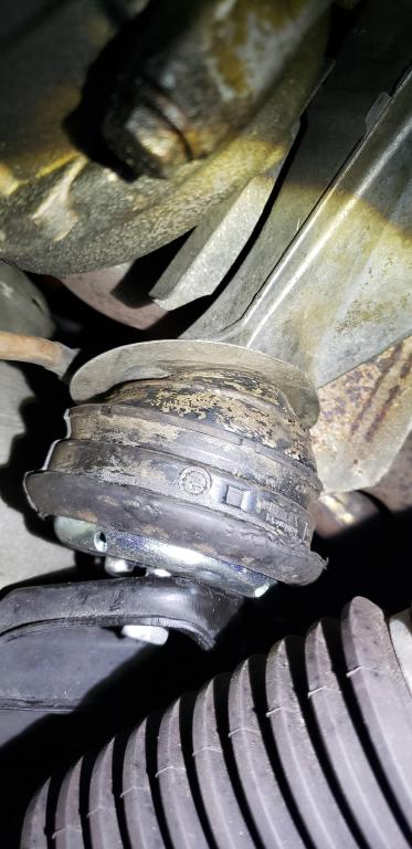

              So i crawl underneath to look at the passenger side which is most clearly visible and I see this:
              Click image for larger version  Name:	20200421_164034.jpg Views:	0 Size:	50.1 KB ID:	9919697
              The top of his mount was skewed hard over and the bottom of the mount was not seated on the perch. His OEM mounts were dead wrong also but this was not visible from up top so he thought they were right.

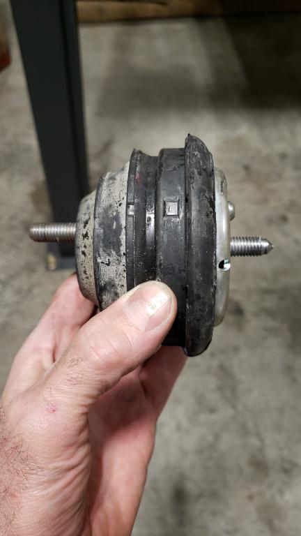

              I bought the MTC mounts and this is one of them in profile:
              Click image for larger version  Name:	IMG-20200421-WA0017.jpeg Views:	0 Size:	50.5 KB ID:	9919698
              See the top pins is offset inboard.
              I installed them and of course the bolted right up without issue.
              This is the passenger side installed, no skewing at the top and seated perfectly on the perch. Drivers side is also seated perfectly.

              So long story short is that BMW has a major issue with e42 motor mounts made by Freudenberg. I would have preferred to use OEM instead of an aftermarket - but BMW has let me down big time.
