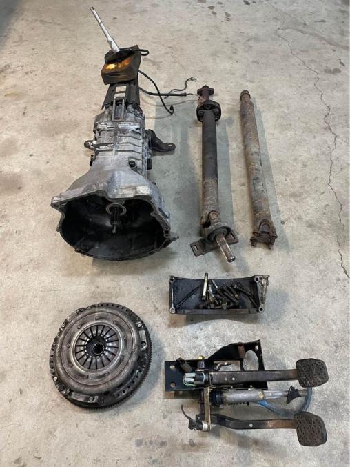

                Ok so I found a potential 5 speed swap package and just wanted to as a few questions:
                My car is a December 1985 Build car and the swap allegedly came out of a 1986 325e as well.
                I would like to replace the clutch and pressure plate assembly with a new unit while everything is out and potentially upgrade (?) to a single mass flywheel but upon research it seems that certain ETA blocks have a trigger point on the flywheel and some don't along with the fact that some bellhousings are shorter than others,
                Am i totally confused or what?
                Thanks in advance.
                Here is a photo of what I'm looking to pickup.

                  There's two part numbers for the gearbox regarding bell housing depth. Remedied by ordering a 323 throw out. If that's from an 86, it "should" have a single mass, but the larger version. There are 2 sizes of single mass, then dual mass which only came 87/88. That pic is the size of my thumb on a 32" monitor can't see well, but the large giubo (110mm) is generally an indicator that you have the deep bell housing and dual mass.
                  That box is the late 1985/6 style that has the mounting points for the late model shifter carrier. Good upgrade. Just make sure you put the two allen head bolts back on the gearbox when you remove the sheet metal shift carrier, or fluid will leak out.
                  Before you swap the pedal box, examine yours closely. It may contain the captive nuts for the master cylinder screws. If that's the case, you can leave your box in place and just swap the two pedals and hardware.

                    Yes, you need to stick with the ETA flywheel, all have the trigger points references. It has the pickups for the reference sensors in the bellhousing. My 86 came with a single mass version of the right flywheel. But I cant speak to which eta models have single vs dual mass flywheels.

                      Correct, but there's a way-a-round. For the ETA ECU, you need to use the m20 flywheel due to tooth count (24v and m42 have a different ring gear) as that's what gives engine speed. The single tab for the cylinder identifier can be replicated. Lay the new flywheel on the old one with the big holes lined up and mark the single tooth. Drill/tap and put a ferrous bolt in.
                      The heavy flywheel can be brought several pounds lighter. The extra mass is on the engine side which can be machined off, and even get very light if you cut it all the way to the ring gear, or the cylinder identifier on ETA.

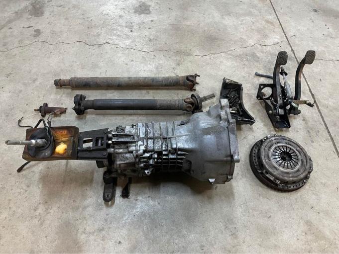

                        Thanks for all of this good information.
                        I am going to pickup this swap and analyze what I have before moving forward.
                        I was hoping to order a complete clutch kit with a single mass flywheel beforehand to have everything ready.
                        Here is a bigger photo attached:

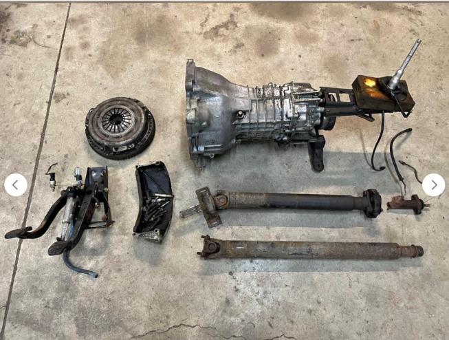

                          A few more photos
