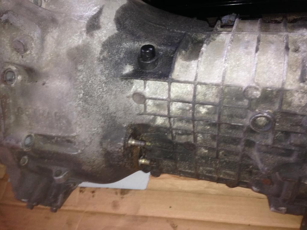

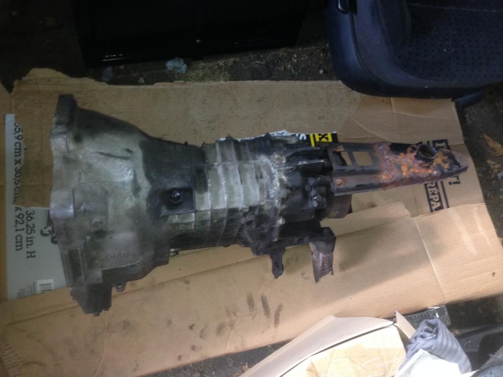

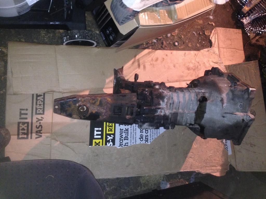

    Just pulled the transmission off my parts car ('86 325e, 320k KM) after a few days of tough work by myself. Planning on swapping it into my Auto '87 325is.
    This is the first transmission I've ever pulled, and thus the first clutch I've seen first hand. Here's what I've found so far. Planning on pulling the clutch, flywheel and master cyl next week when I have some time. (I'll take pictures of them when I do)
    It looks like an inspection hole was drilled into the bellhousing, and never plugged. Therefore everything in there is somewhat rusty. Is this a really bad thing?
    The car did run and drive previous to this. The trans felt good, I even gave it a test launch and the clutch held the mighty (lol) ETA power with no issue (left a couple of skids on the pavement)

    Here's the pics.

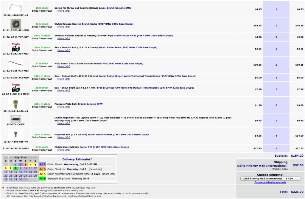

              Here's what I've got.
              Anything I'm missing?
              (Should I be getting a pilot bearing + felt + caps?)

                  Ok, i'll get a new TOB then.
                  What about a pilot bearing?

                    • rmdashrf
                      • Feb 2014
                      • 207
                      Clutch jobs are annoying and most times it's a, once you're in there, do everything kind of deal. You don't want to drop it again because you didn't replace one stupid part. Replace as much of it as you can.

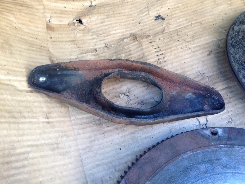

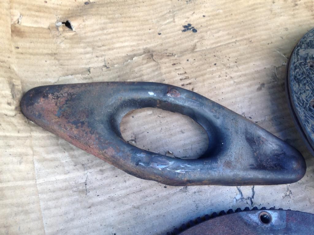

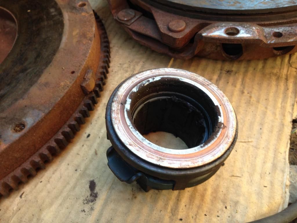

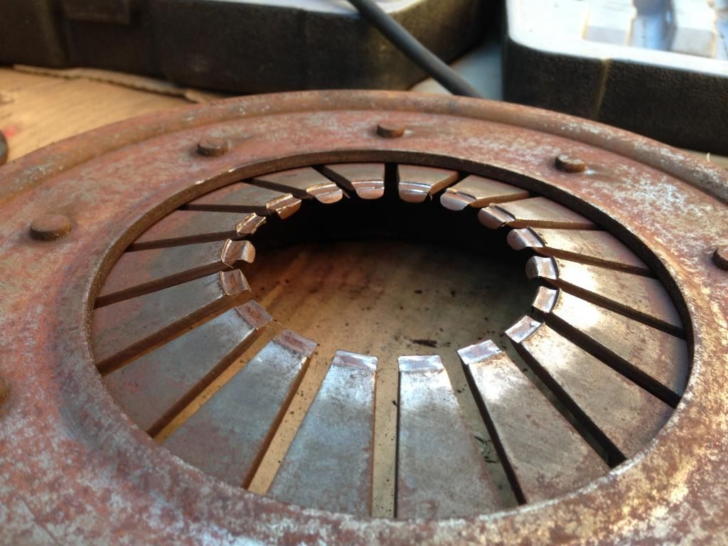

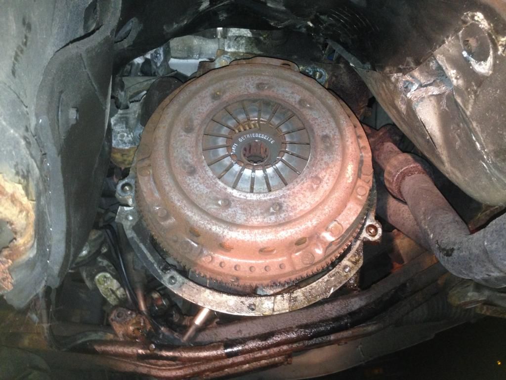

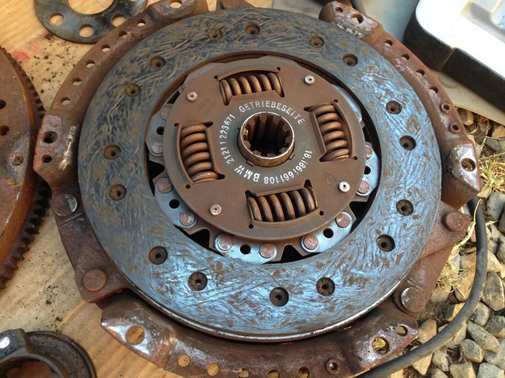

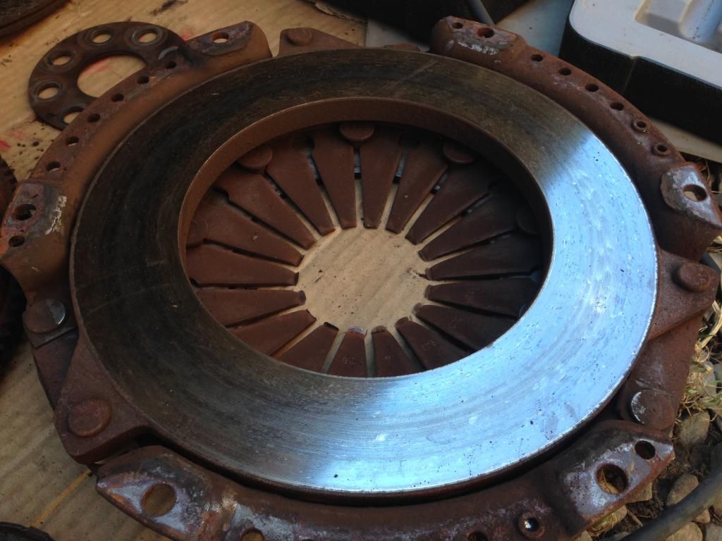

                            Got the flywheel and clutch off today. Take a look at these pictures and tell me if anything is off.
                            As I said before, I've never had a clutch/flywheel apart before, so I don't know what to look for. Please point out what you may think is obvious.
                            The only things that strike me as "off" are:
                            1. Bent/broken tips of the fingers on the pressure plate.
                            2. Worn/shiny areas of (TOB?) arm.
                            Assuming the above two points are not issues, I plan to use all the parts that you see. As I said before, let me know of anything I've missed/am ignorant of.
                            Thank guys!
                            • SpecM
                              • Oct 2005
                              • 4531
                              The clutch disk looks "ok", but the TOB and PP are rusty and show obvious wear. Replace all three (normally replaced as a kit anyway).
                              The release fork looks iffy, I would replace it with new along with the arm spring and pivot bushing.
                              New slave cylinder and hose, obviously.
                              You NEED a new pilot bearing, as automatic vehicles do not have them. It presses into the end of the crankshaft.
                              Take the flywheel to a competent local machine shop to be resurfaced.
                              Do it right or do it twice ;)
