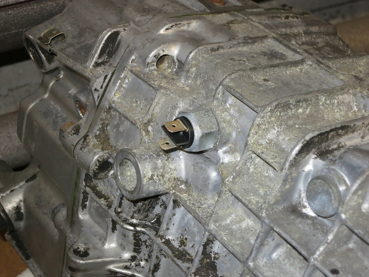

    I recently installed a spare gearbox into my E30.
    But this spare gearbox has the new style of backup light
    switch with only two terminals (here in Sweden/Switzerland
    we had an oddball with three terminals on older E30), so my
    connector does not fit anymore.
    No, swapping the switch does not work (the spare gearbox
    uses M12 while the one I want uses M14).
    I thought it was the standard 6.3 mm spade connectors.
    But no....
    It seems to be around 6.6 mm connectors spade connectors (and they are not standard and can't find that anywhere).
    Does anyone have any suggestions what connectors would fit onto this switch?

          Thanks for answers! Haven't been able to reply until now :oops:
          The standard sizes are 4.8mm and 6.3mm - I bet you guys in North America is using something completely different as usual :-)
          So basically everyone selling generic electrical components will go for the standard sizes, since that is what everyone uses.
          I've browsed through some of Europe's biggest electrical component supplier (like Elfa and Conrad) but they don't have that size.
          @varg and @Madhatter : Yeah, I agree - I will most probably just file down thw width if the connectors somewhat. Quick, easy and fully acceptable solution.

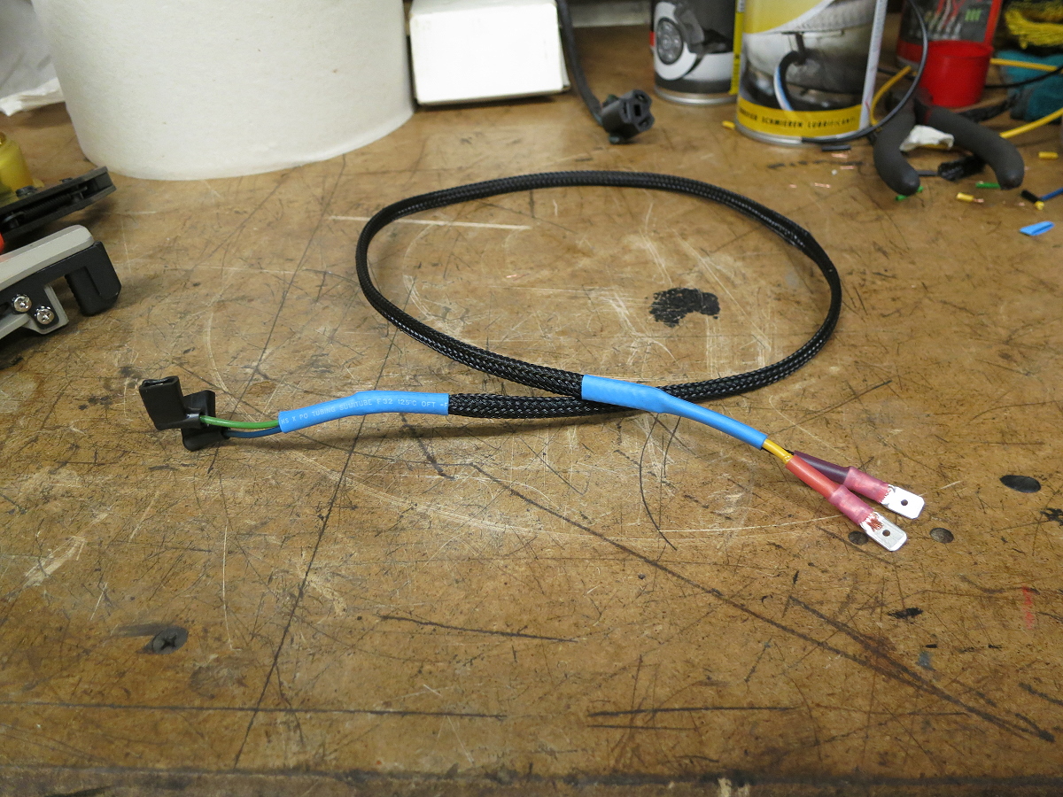

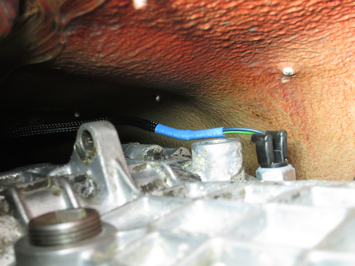

            Turned out I found a simple solution.
            When I was dismantling my E34 535i I saved good-to-have cables/connectors and found a cable with connectors I was looking for (because there are quite a lot of connectors on a E34 having 6.3 mm spade connectors).
            So I simply took that cable from the E34 535i, cut to appropriate length and added two standard male 6.3 spade connectors (that is connected into the main harness).
