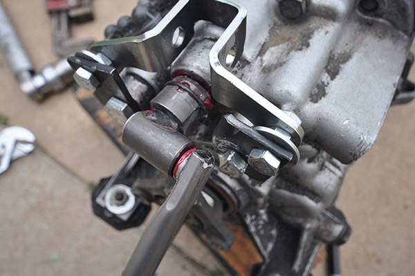

    Some notes on replacing a newer Getrag 260 with an older one, on a BMW E30 3 series or E28 5 series.

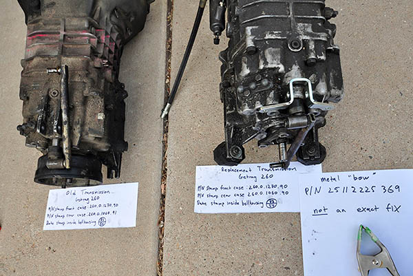

    Original transmission part number stamps:
    Front half of case: 260.0.1270.90 ( 260 0 1270 90 )
    Rear half of case: 260.0.1060.91 (260 0 1060 91 )
    Date stamp inside bellhousing: 85/86
    Replacement transmission part number stamps:
    Rear half of case: 260.0.1060.90 ( 260 0 1060 90 )
    Date stamp inside bellhousing: 83/84
    So far as I can tell the external dimensions are the same. This includes the stud spacing for the slave cylinder. Stud spacing at output shaft flange was the same but different design.
    The difference between the two is the mounting for the shift platform. At first, I thought that perhaps I could use metal bow P/N 25 11 2 225 369 as bolt-on workaround. It was not a bolt-on solution. It required bending, grinding, washers and fabricating spacers to fit. Even the shift rod had to be ground.
    In the end, it works acceptably but I can feel a slight difference in the position of the shifter. I have played with reversing/adjusting all components of the shifter linkage to some benefit. I may have gotten better results if I had spent more time getting my fabricated solution more exactly aligned to replicate the original position of the shift platform connection.
    Conclusion: swapping out a newer Getrag 260 and replacing it with an older was is doable, but enough of a PITA that given the choice I would happily pay more for the correct used transmission, or sourced the correct shifter platform and related parts.

      Easiest way is just to look at the top of the trans. It'll have two "ears" on top of the later ones, its where the carrier clips in. Earlier ones don't have it.
      Both model gearboxes have holes in the back of the rear housing for the series 1 style shift plate. It's easier to go from a series 2, back to a series 1, than it is the other way around.

          For anyone who finds this thread, I *believe* just using the bracket/bushings that came on the early model e30 (25111208580) would allow the M3 shift arm bow (25112225369) to bolt right up without the brackets in the OP.
