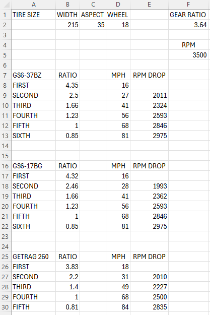

    I made a spreadsheet calculator that may be helpful. I was trying to figure out diff ratios for my N52 swap. Seems like I can't upload it here directly. If you're interested, DM me your email address. You can input tire size and rear ratio, change RPM and it'll output MPH and RPM after shift for G260, GS6-17BG and GS6-37BZ
