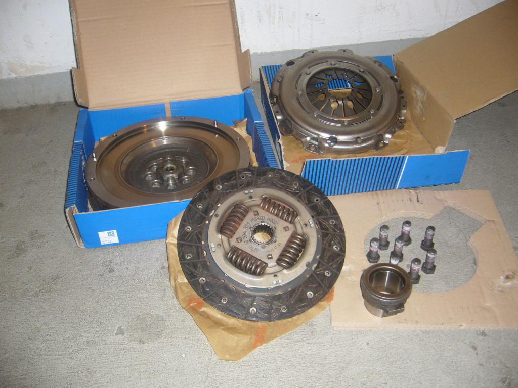

                Snagged a used Valeo kit 835101 with 3000km on it. it is a single mass conversion kit for m54 engine with a 6 speed box. It is still as heavy as the factory assembly, but it can be lightened and balanced :)
                My transaction feedback on r3vlimited :):Clickety click

                  Valeo (835101) single-mass flywheel weighed in @ massive 12.4kg (27lbs)(when factory double-mass is specified @11.3kg (25lbs) in the m54b30 parts catalog).
                  Got it conservatively lightened to about 9.1kg (20lbs).
