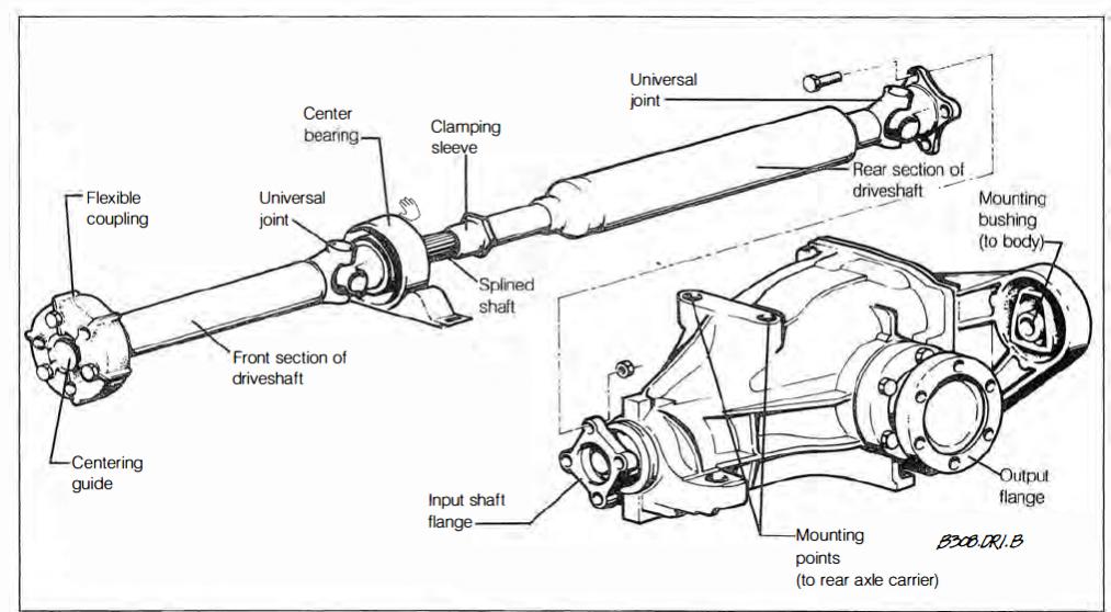

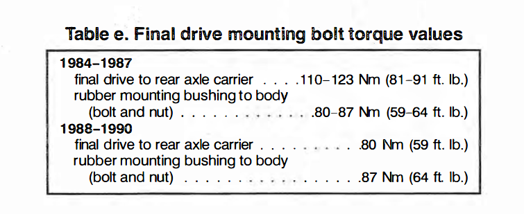

    Looked at Bentley and I think that's the "final drive to rear axle carrier"?
    59-64 ft. lbs. See below

      Those specs would be for the subframe diff mount and bushing respectively. Way too much torque for those little bolts OP is talking about, would probably snap them. They're M8 class 8.8 bolts according to realoem, I wouldn't go over 20ft-lbs.
