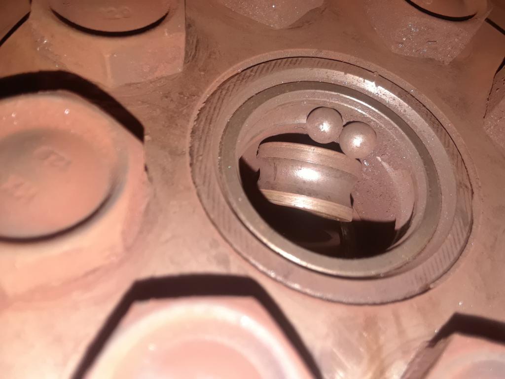

          Well, it didn't really make much of a difference...
          • jgilber0
            • Nov 2016
            • 457
            Ooo. Not good. What is that broken part?
            Jon (OO=[][]=OO)
            1992 325ic white, stock with a 5-speed swap
            Palm Beach County
            • varg
              Florida Turbo Man
              • May 2014
              • 3417
              pilot bearing
