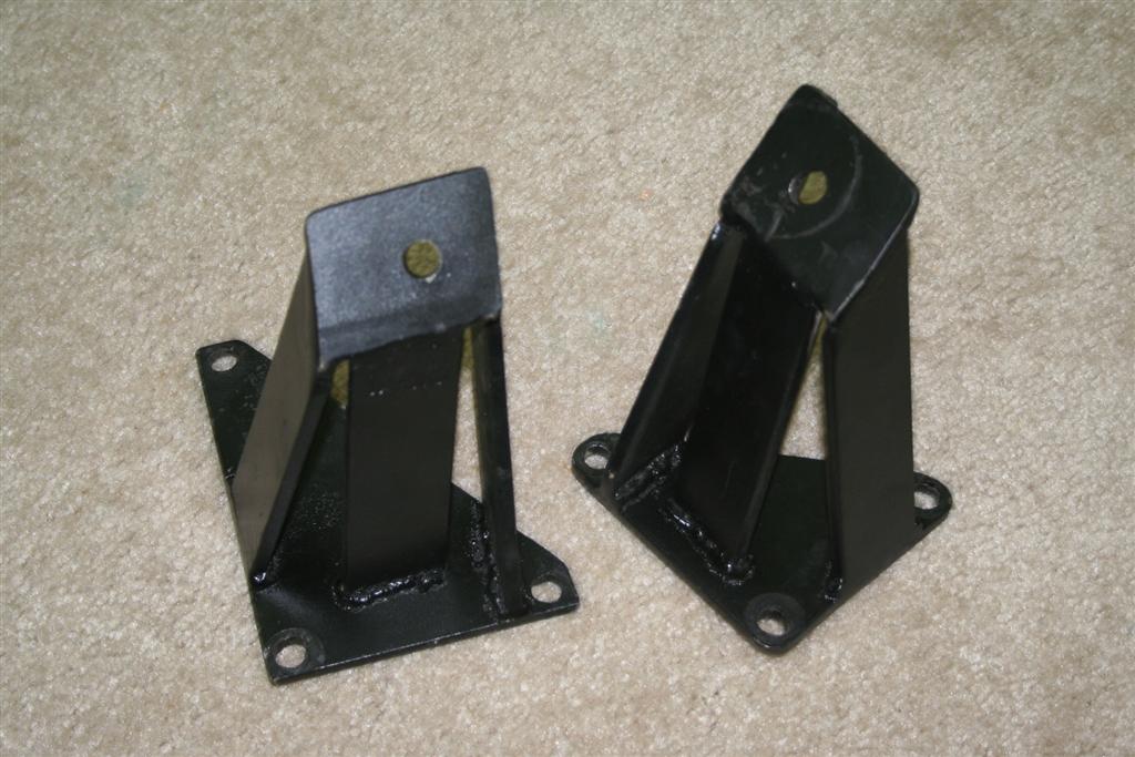

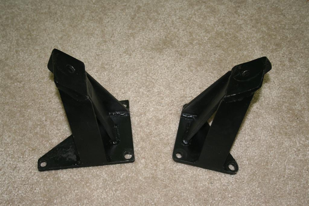

They are due on the 16th according to UPS. Got a set from a forum member on e30tech to start with. Hopefully they will sit the engine w/o having to lower the subframe or any of that ....Mtech1 v8 build thread - https://www.r3vlimited.com/board/sho...d.php?t=413205

They look very much like www.300mm.de mounts.- E34 M5 (x 2) -

Is it possible to get dimensions or a cad drawing of the mounts to make our own?
