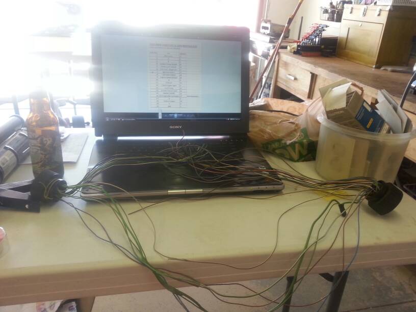

  • MonkeyMadness
    replied
    Swap harness adapter. ...!
    Here's the chart I used for mine adapter.
    all the wires seemed to match up well.
    Note: i have a91 318is c101 to 94 e34 x20 from a M5xtu.
    I also used this webpage a point of reference..
