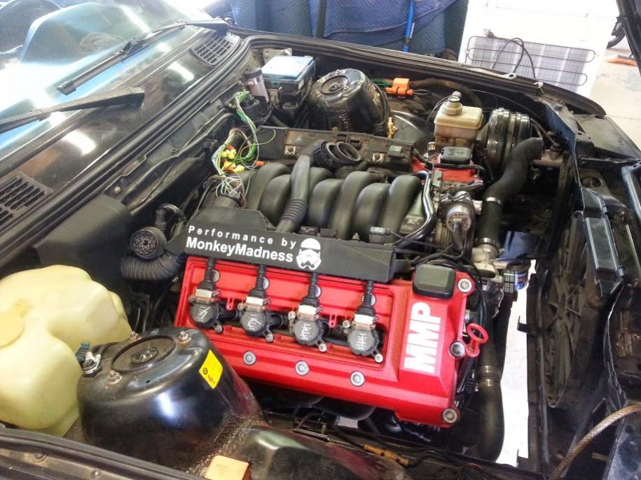

      Run test #2
      • econti
        • May 2014
        • 1147
        #378
        That looks sexual with the red rocker covers.
        What's the next step? Tidy it up then tune?
        (clicky on piccy to get to thread)
        • MonkeyMadness
          • 3251
          #379
          Yes. Clean everything up. Work some bugs out. Figure out my tach. I'm not getting a signal to my cluster so will be working on that next. Need a new belt. Coolent, ect.

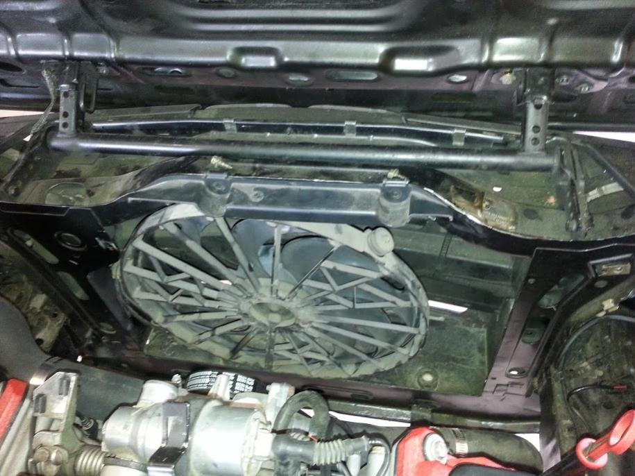

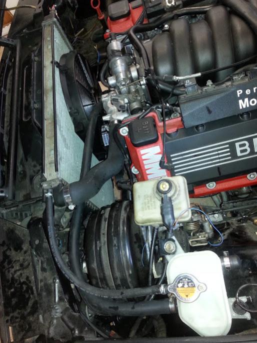

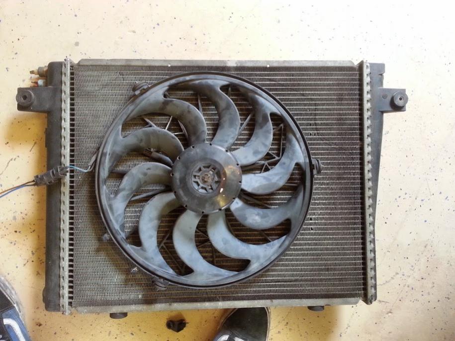

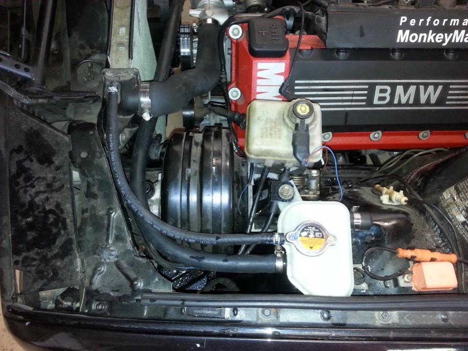

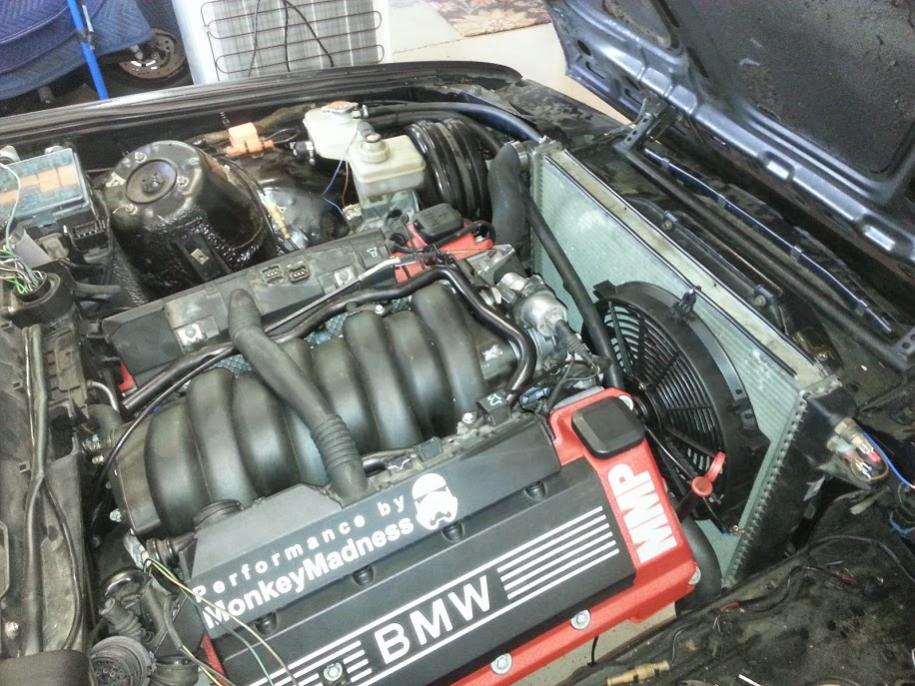

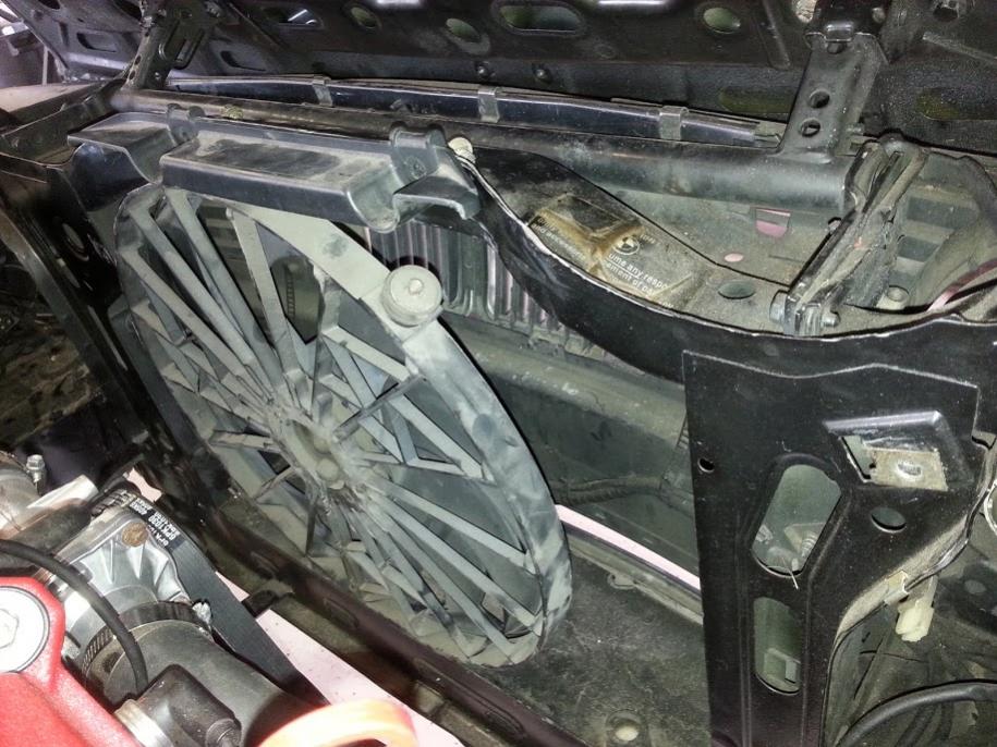

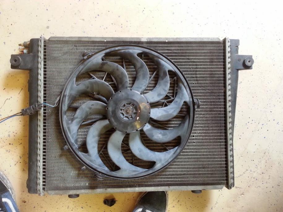

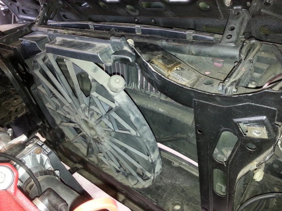

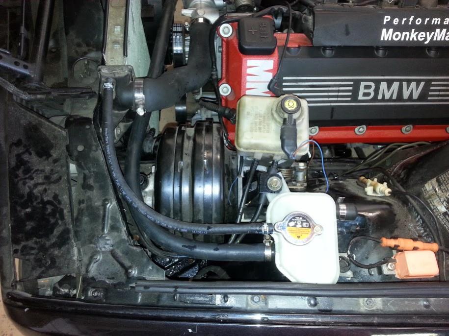

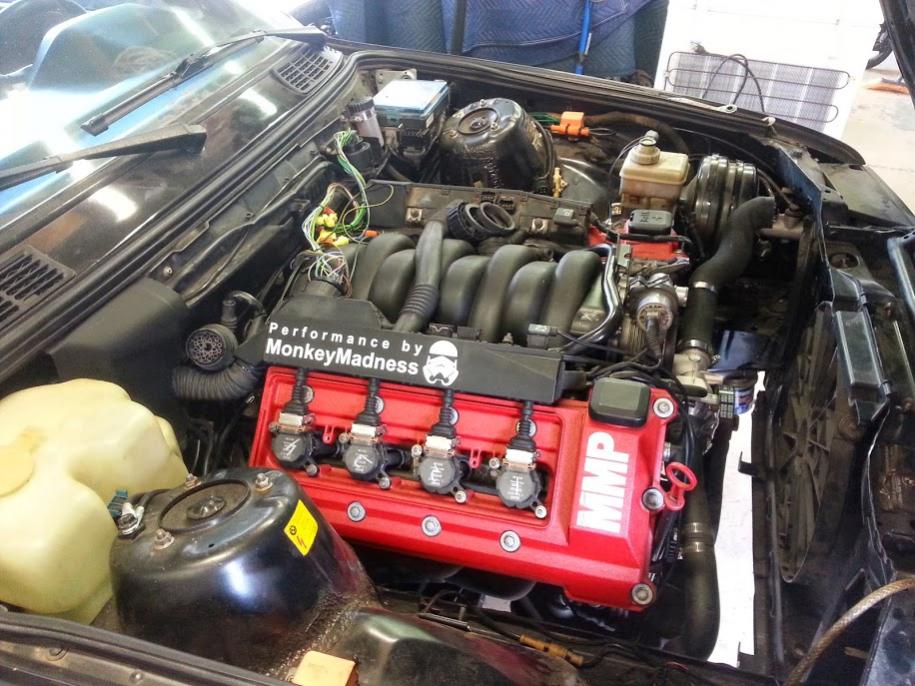

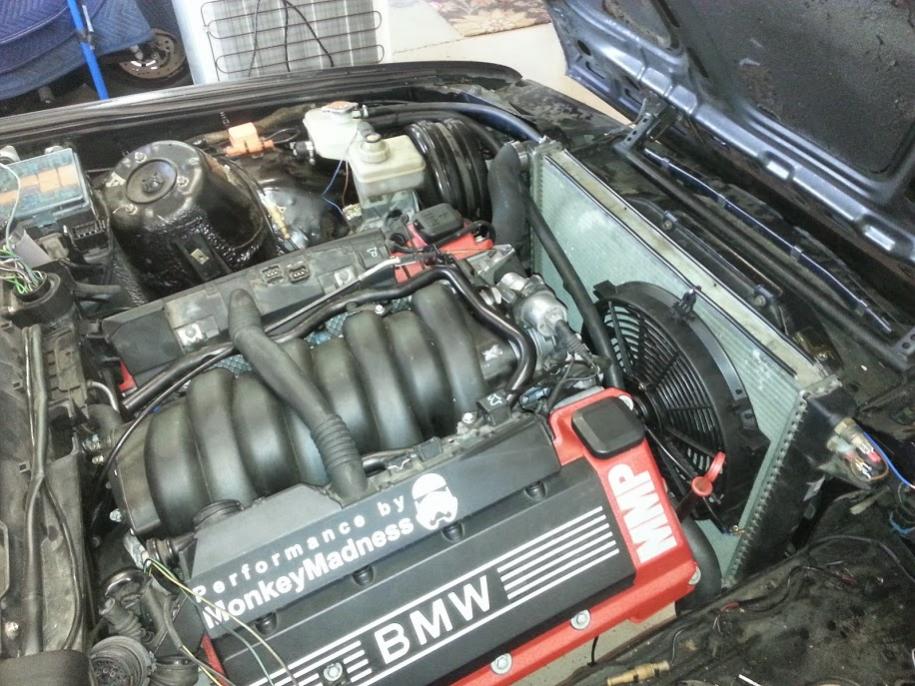

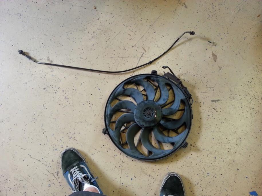

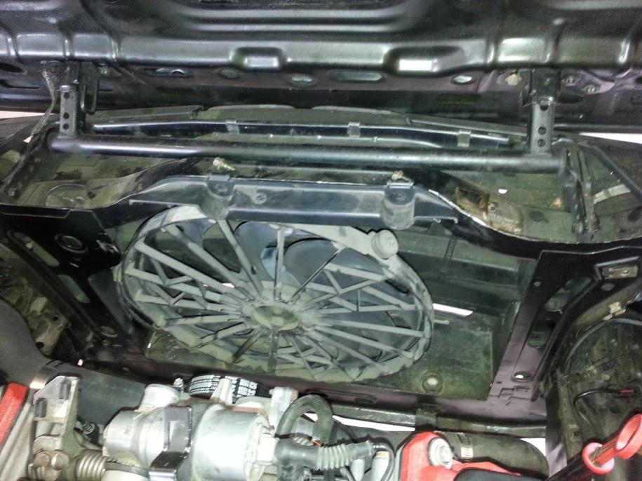

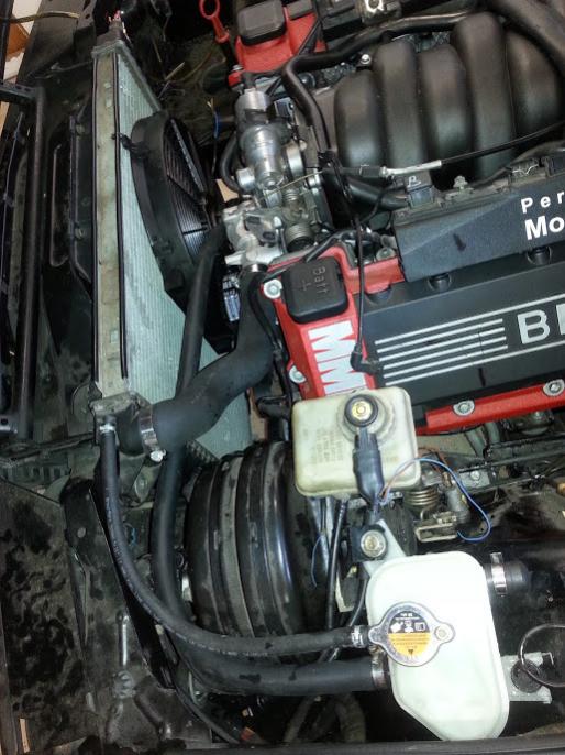

                      So spent the day finishing the cooling system. Added a Huge OE fan and moved my other fan so now i have a low and high speed fans, as a pusher and a puller. Also mounted my new overflow tank with hoses. I'm really happy with it. It hides well in plane sight.
                      Also heard back from Garagistic, they want my tach signal thingy back and there sending me a new one. I thought that was pretty standup and cool on there part.

                        This is the placement I have for my overflow tank...:D
