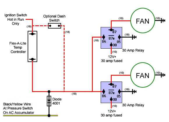

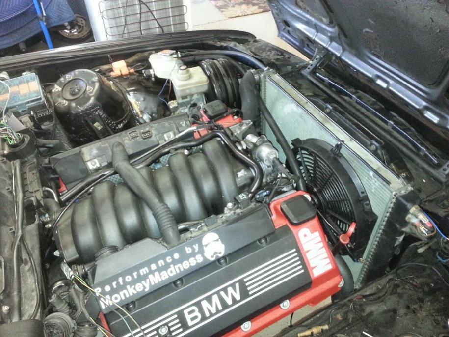

        Small but exciting update today. So after "Self smarting myself" on electronics.
        I was able to build myself a dual relay, dual heat sensor harness with high/low fan speed setup for 2 fans. One pusher and one puller.
        I was able to build, test, and finalize the build with dual fuses and controlled by the ignition switch supported by and through the M60 harness. Using my harness adapters lead c101 x 7 ---//---x20 x21 wire Green.

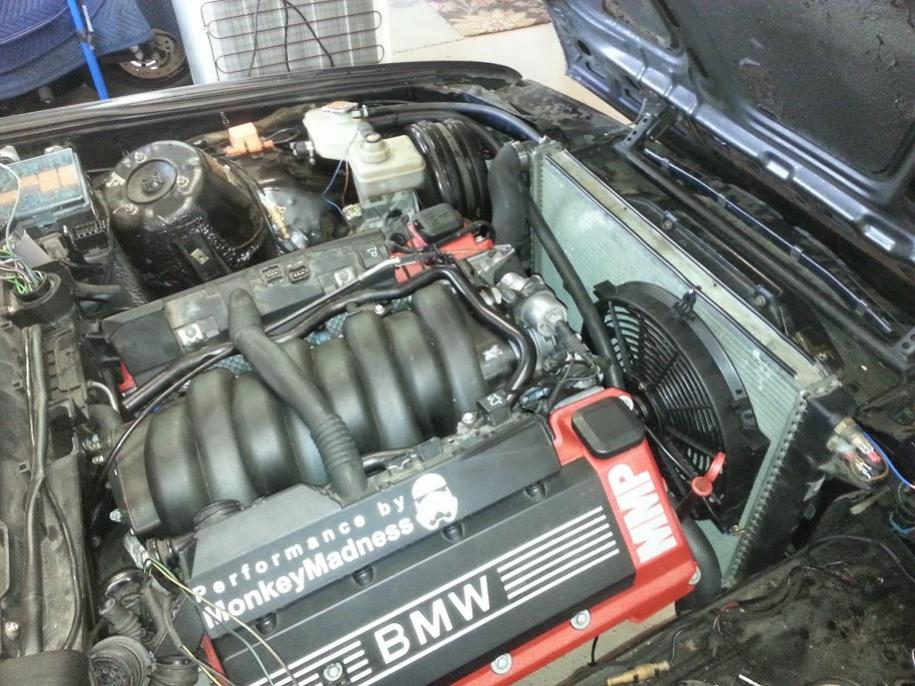

        I built my harness off of the setup below. The only difference is that the -grounds for the relays are routed through the low and high temp sensors that come stock in the E28 535 radiator
        Top Left of the rad in this pic.
        Top right of the rad in this picture you will see the temp sensors I used as a -ground for the two relays I'm using for my setup.
        Everything was nice and cleaned up after the picture. I have to say I was quite happy with the setup and testing.
        This thing will be a SICK ASS Daily Driver...:mrgreen:

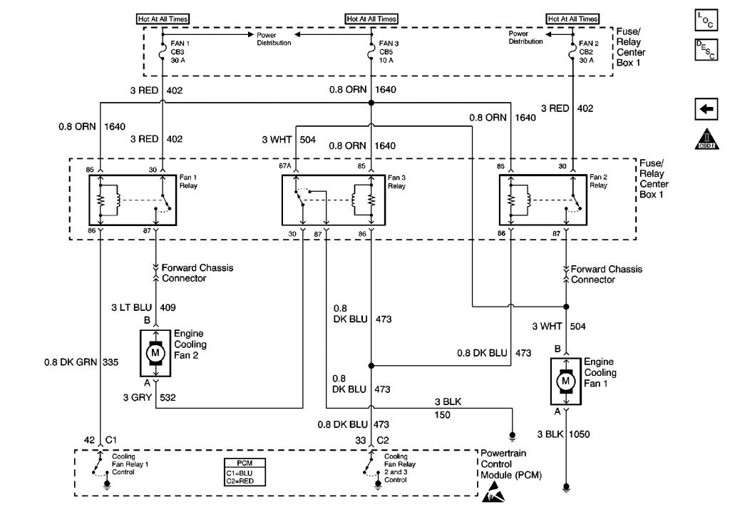

            You can use 3 relays to control 2 fans such that at low speed the motors are in series and at high speed the motors are in parallel. It's a fairly elegant design that GM uses all the time.
            "Low speed" relay:
            Primary high side: low speed fan control
            Primary low side: ground
            Secondary high side: Fan 1 fuse
            Secondary normally OPEN (NO) low side: Fan 1 high side
            "High speed 1" relay:
            Primary high side: high speed fan control
            Secondary high side: Fan 1 low side
            Secondary Normally CLOSED (NC) low side: Fan 2 high side
            Secondary Normally OPEN low side: high current ground
            "High speed 2" relay:
            Secondary high side: Fan 2 fuse
            Secondary NO low side: Fan 2 high side
            Fan 2 low side goes to a high current ground.
            This assumes that your low and high speed fan switches are on the high side of the relays. If you have a switched ground via an electronic controller, then connect that to the primary low side, and connect hot in run (or fan enable) to the primary high sides.
            Edit: Dug up a diagram:

              The radiator overflow tank, what's it from?
              • MonkeyMadness
                • 3251
                #397
                It's from a Nissan pickup, not sure make or model. I found it on flebay. It was cheap right size and local...

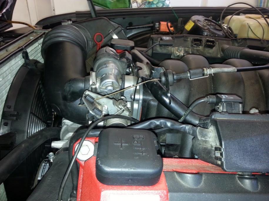

                      So I got the some of the final bits needed to finish my build.
                      Received the new Garagistic tach speed splitter (Thank You!)
                      Bump and Shout out to them for the Help!
                      Garagistic is your trusted source for high-quality BMW performance parts, specializing in E30, E36, E46, and more. Discover custom-engineered components, from suspension upgrades to drivetrain solutions, designed to enhance your BMW's performance. Shop now for fast shipping, expert support, and unparalleled quality.
                      Please visit them for your latest v8 swap needs...
                      I was also able to pick up the needed little gromits to finish my throttle cable..
                      If all goes well. I plan on backing it out of my garage down the street and back then parking it in the garage, cause I'm sure by that time the COPS will be looking for me due to the lack of exhaust.... ;D
