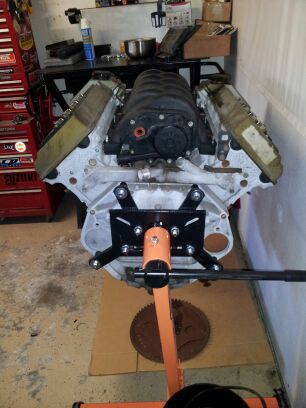

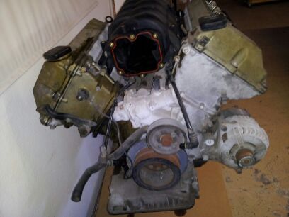

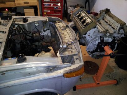

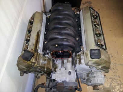

                    #54

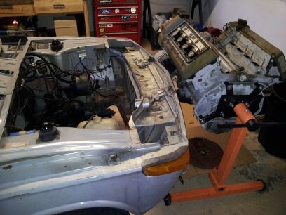

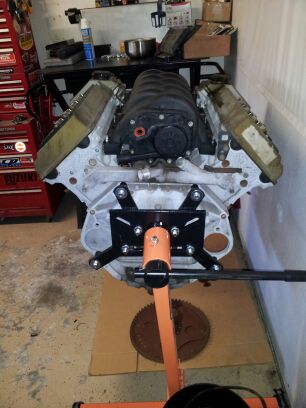

                    Gratuitous Motor Pictures..
                    oh umm
