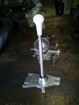

                            Had an exciting day today. Guess it's cause it's setting in now that this is going to really happen.
                            Got the 5spd today in the mail.. it came with an AKG shifter.. soo stoked.
                            Still need a flywheel. but got rubber mounts and a starter coming now..

                            AKG
