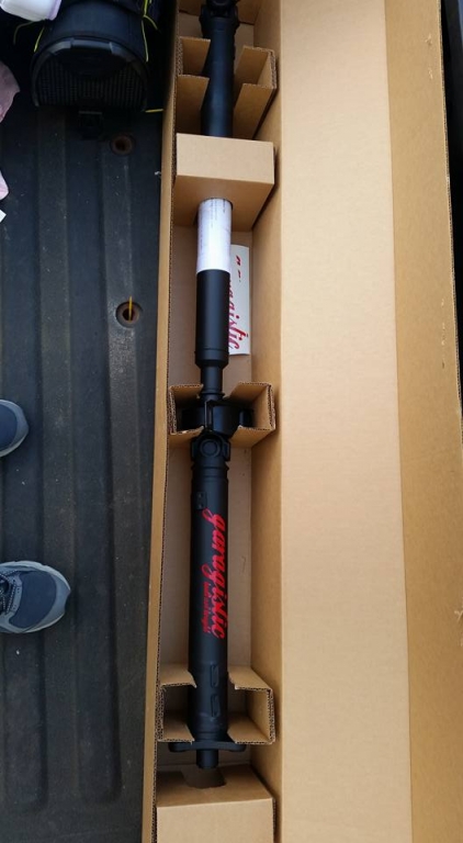

                        Hey slappy, how many pieces do you see here:
                        Dumpster Fire Pilot
                          There appears to be slightly more than one piece, although my comment was mainly directed at monkey's potential desire for a one piece shaft.
