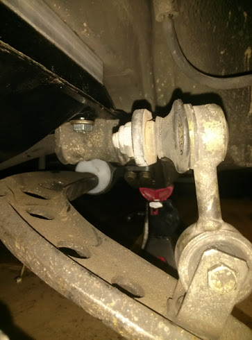

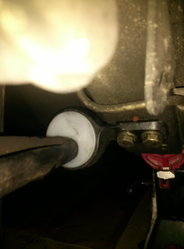

    New M3 Solid bushings rotated 90* to compensate for the 10mm drop spacers on the Crossmember. I noticed that after the spacer install the rubber bushing were under a sizable twisting load, compound that with the normal road movement of the suspension. This worried me So I got a set of M3 solids and rotated them 90* down.. Worked like a charm...;)

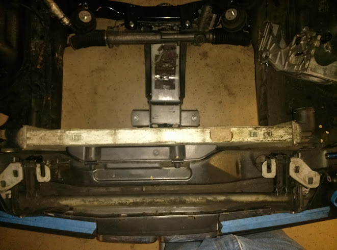

    And some pic's of the rad and mounts

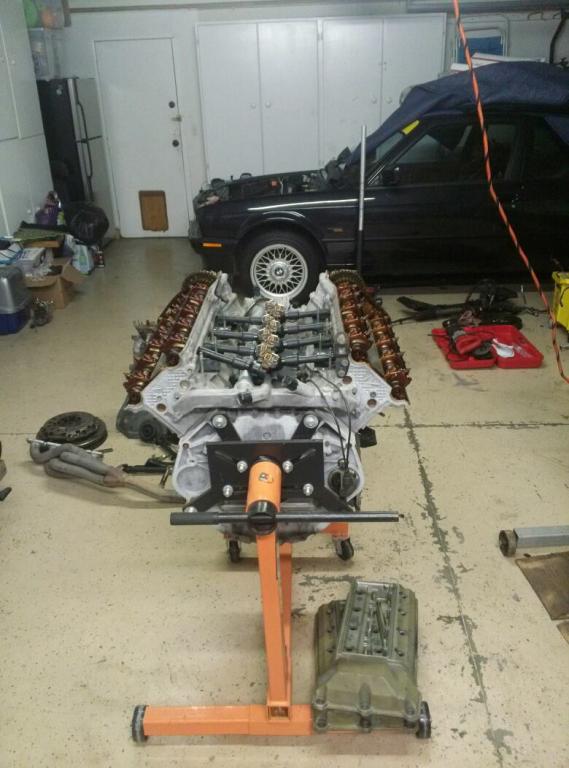

      Valve covers off and on there way to Robertk for some MMP liver tomorrow!

        Ingenious use of the offset CABs!

              I like the idea of rotating the CABs to compensate for the spacers. Nice!
                So pukled the bottom pan to check the oilpump bolts before I button everything up with the trans.
                To my surprise when I got in there everything was tight and torqued to spec. :up:

                    What radiator is that, not e28 535i is it?
                    Pull the cover, replaced the guides?
                      Yes it's the same radiator used in the RTSAuto.com build.

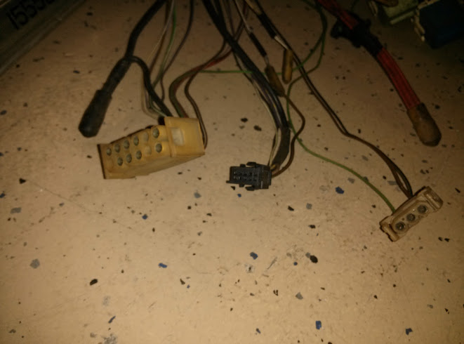

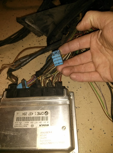

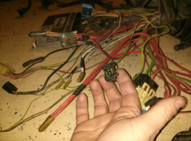

                      Now that I got the DME today I'm working on the harness and have a few questions mostly identification of plugs.
                      Mostly need to identify the EWS plug and trans plugs.
                      First off is the plugs near the Dme. I have no clue what these are, plus do I have the plugs in the DME right, thought the blue plugs are trans plugs please help...:eeek:

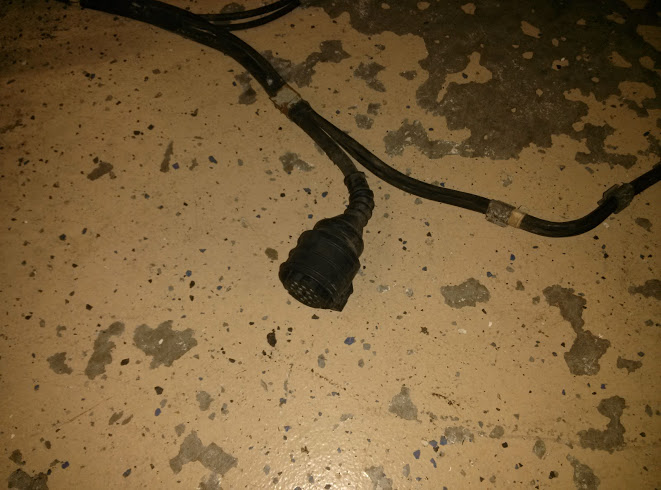

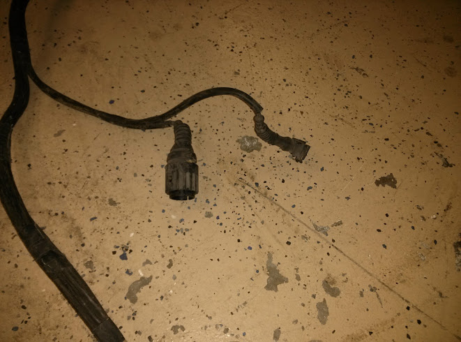

                        Now for the pig tails.
                        I'm sure these are the trans, crank/flywheel trigger plug,
                        Full big tail off the back of harness

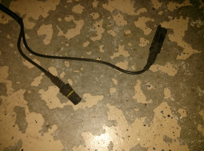

                        I think this is the right side O2 sensor

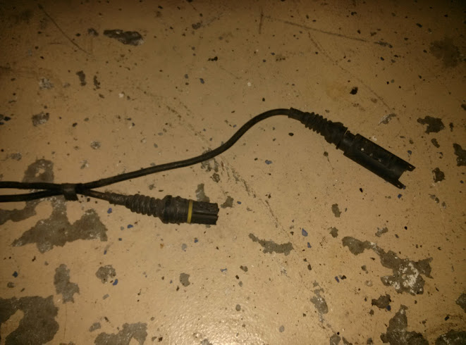

                        Guessing these are for the transmission
                          IIRC for O2 sensors, as the M62 has 4 of them i think, pre/post.
                            Definitely o2 plugs in the last 2 pics.
