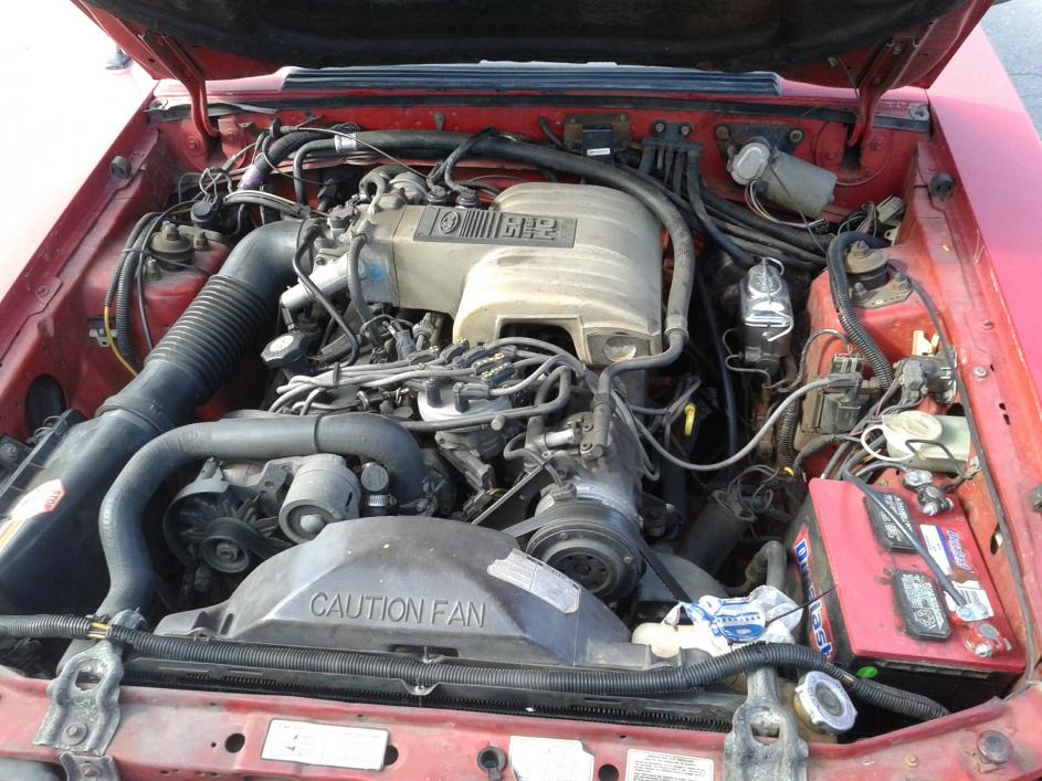

          http://www.r3vlimited.com/board/atta...1&d=1407641553 just got this!! hopefully start my 5.0 swap!!;D
          • jalopi
            • 2370
            #185
            Sweet man, try to do everything kind of right :)
