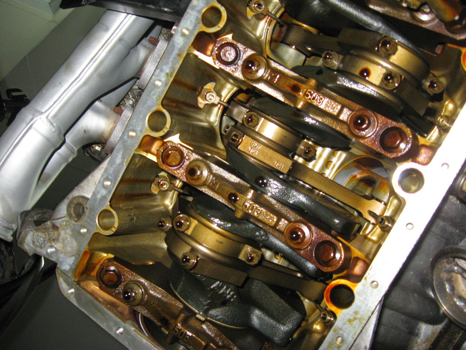

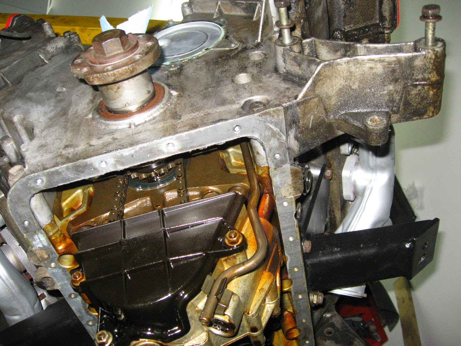

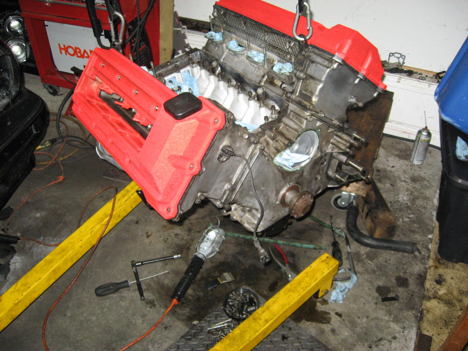

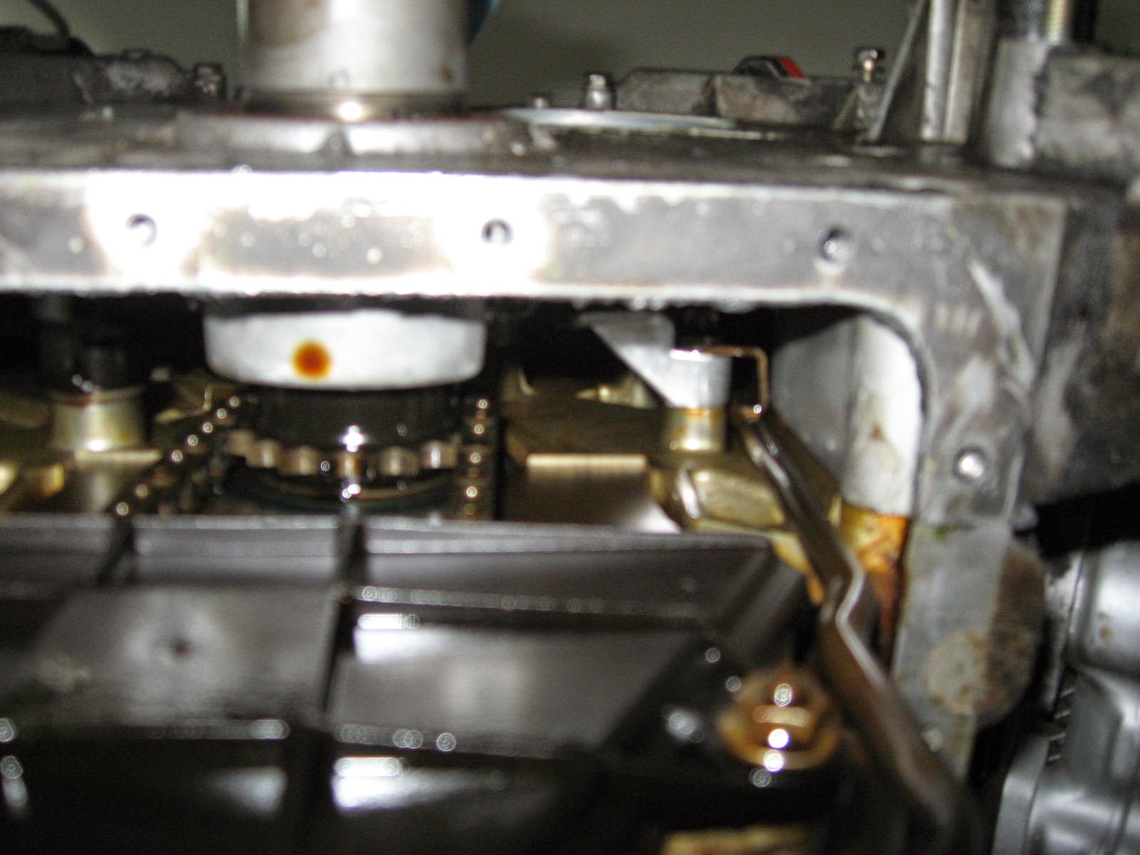

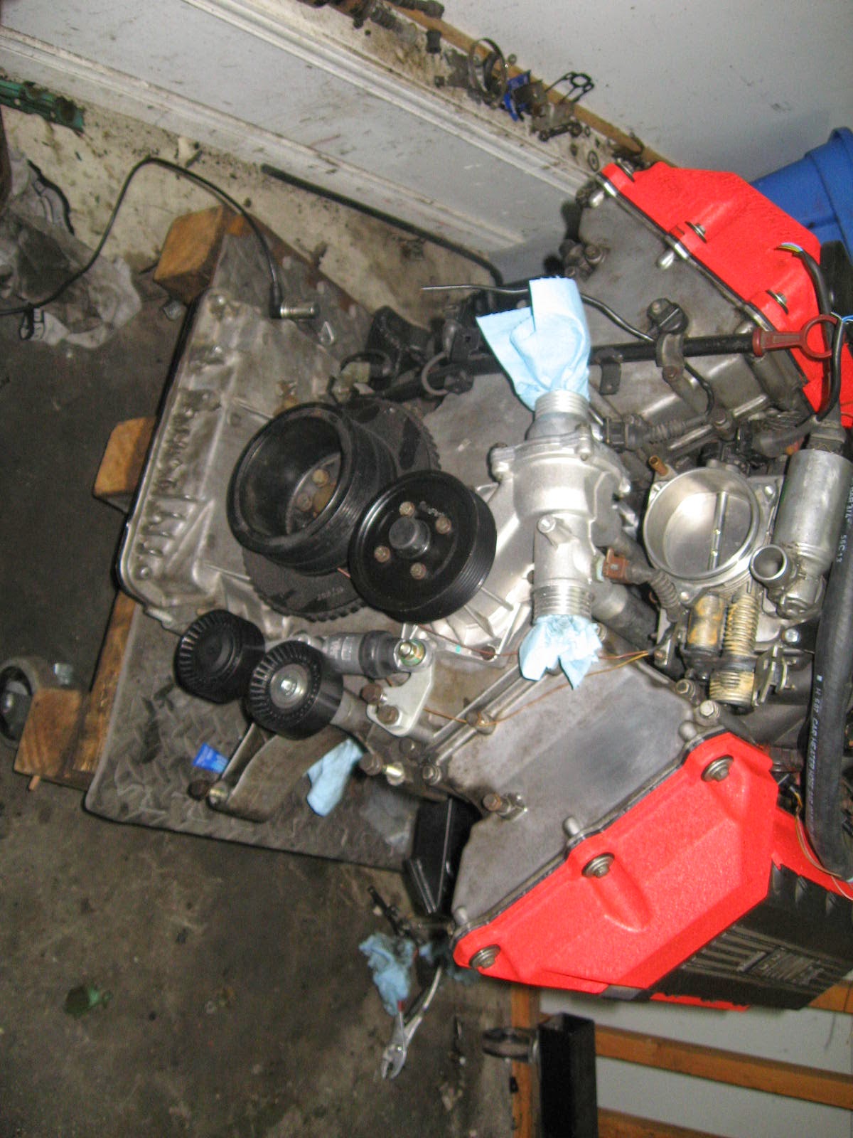

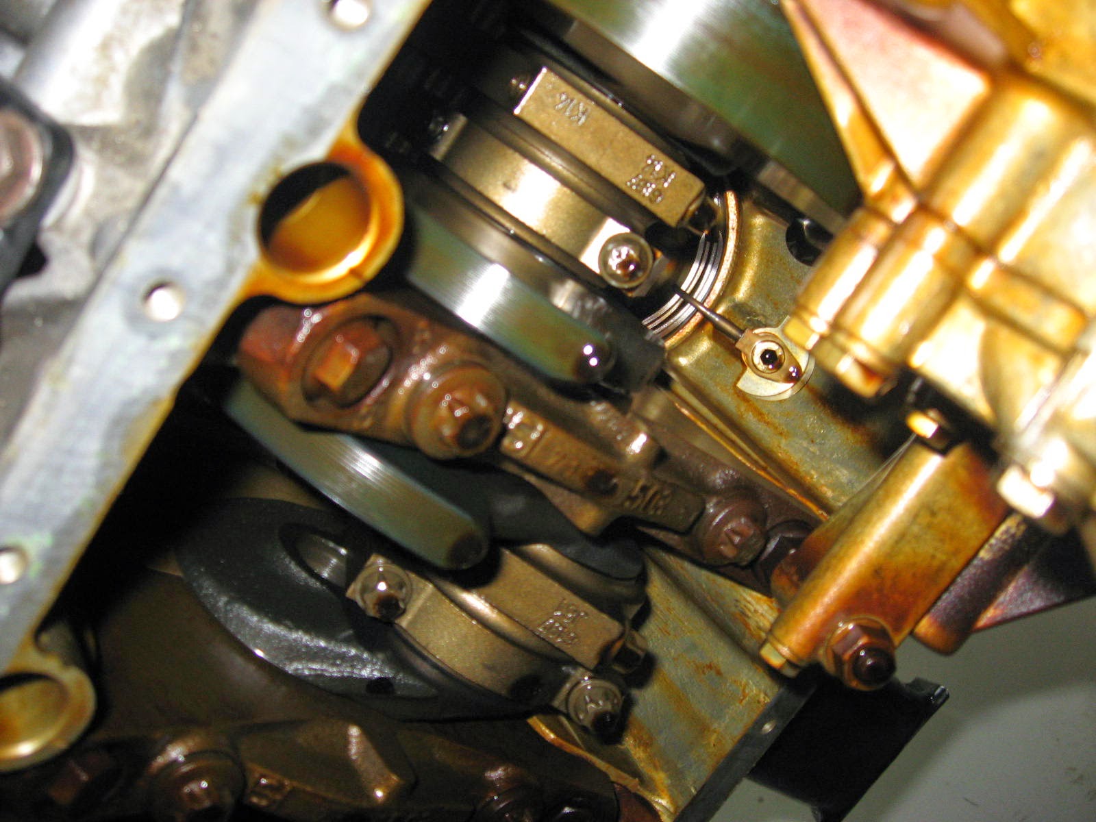

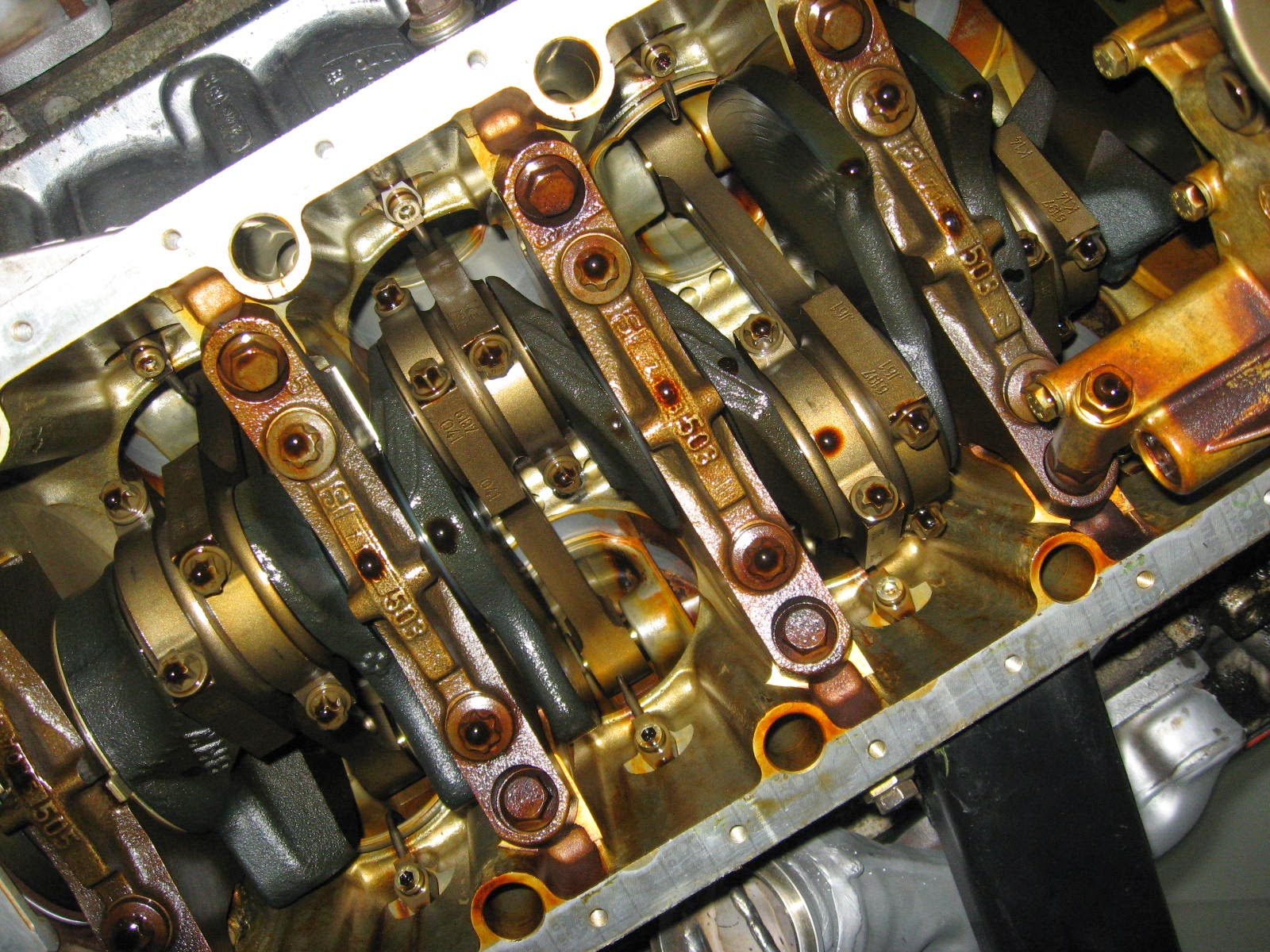

Doing oil pan gaskets... what a shitty job..lolll..
I rarely seen an engine so oil backed outside it was leaking from the valve cover ..at least its clean inside where it counts.
new starter the original one had a loose rotor and I didn't trust it..
..and more cleaning of course.
Cant wait to button up this engine still waiting for parts.. should have this engine installed with tranny in max 2 weeks with the help of my father in law robert.Denny

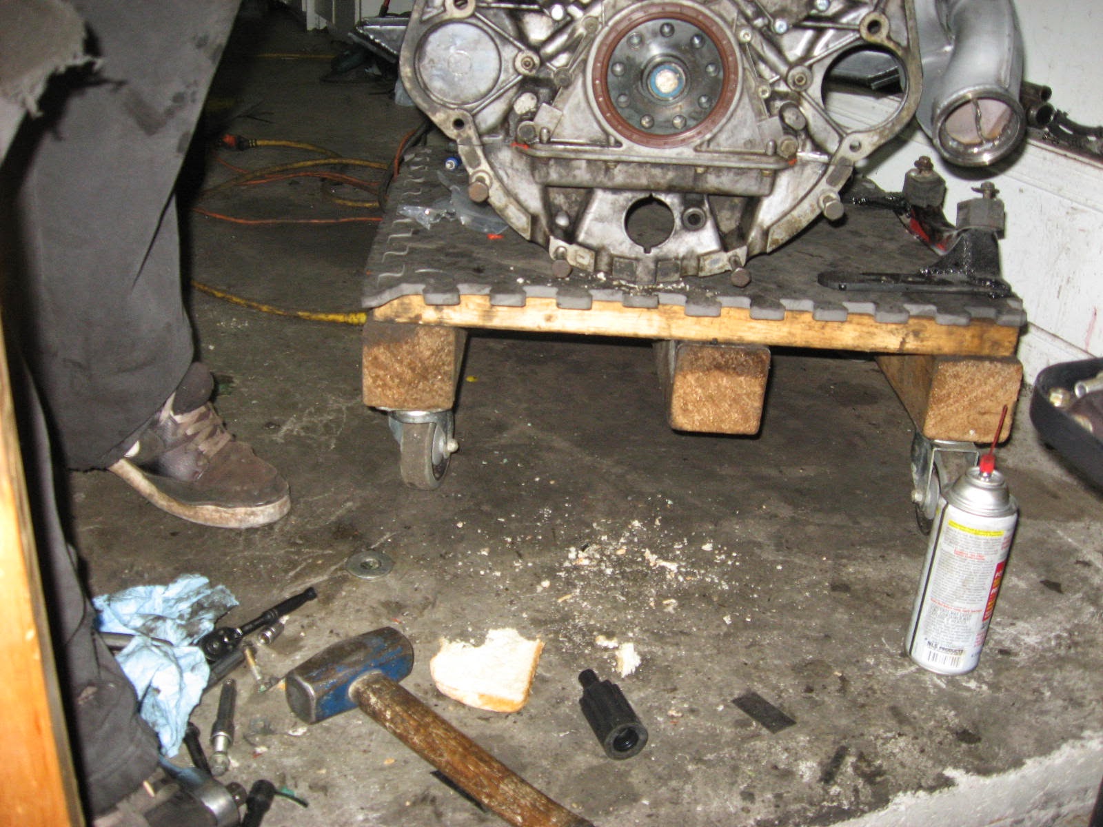

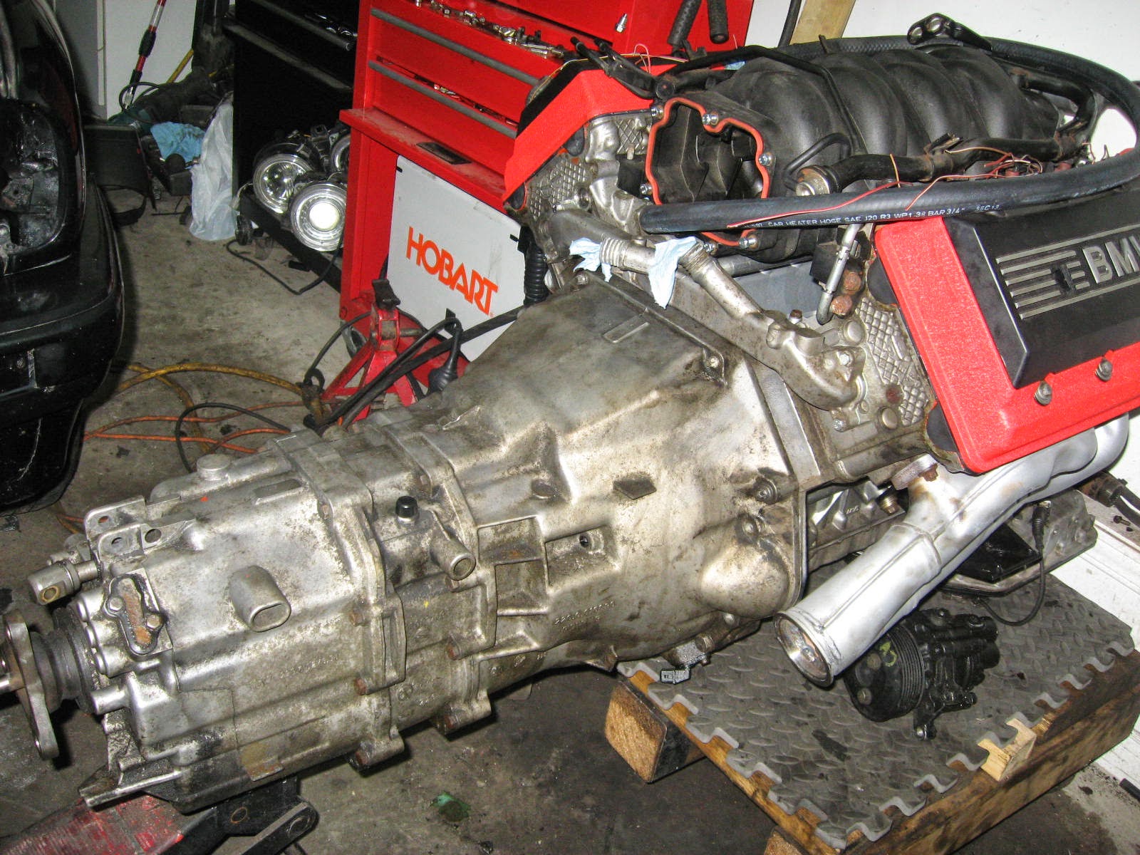

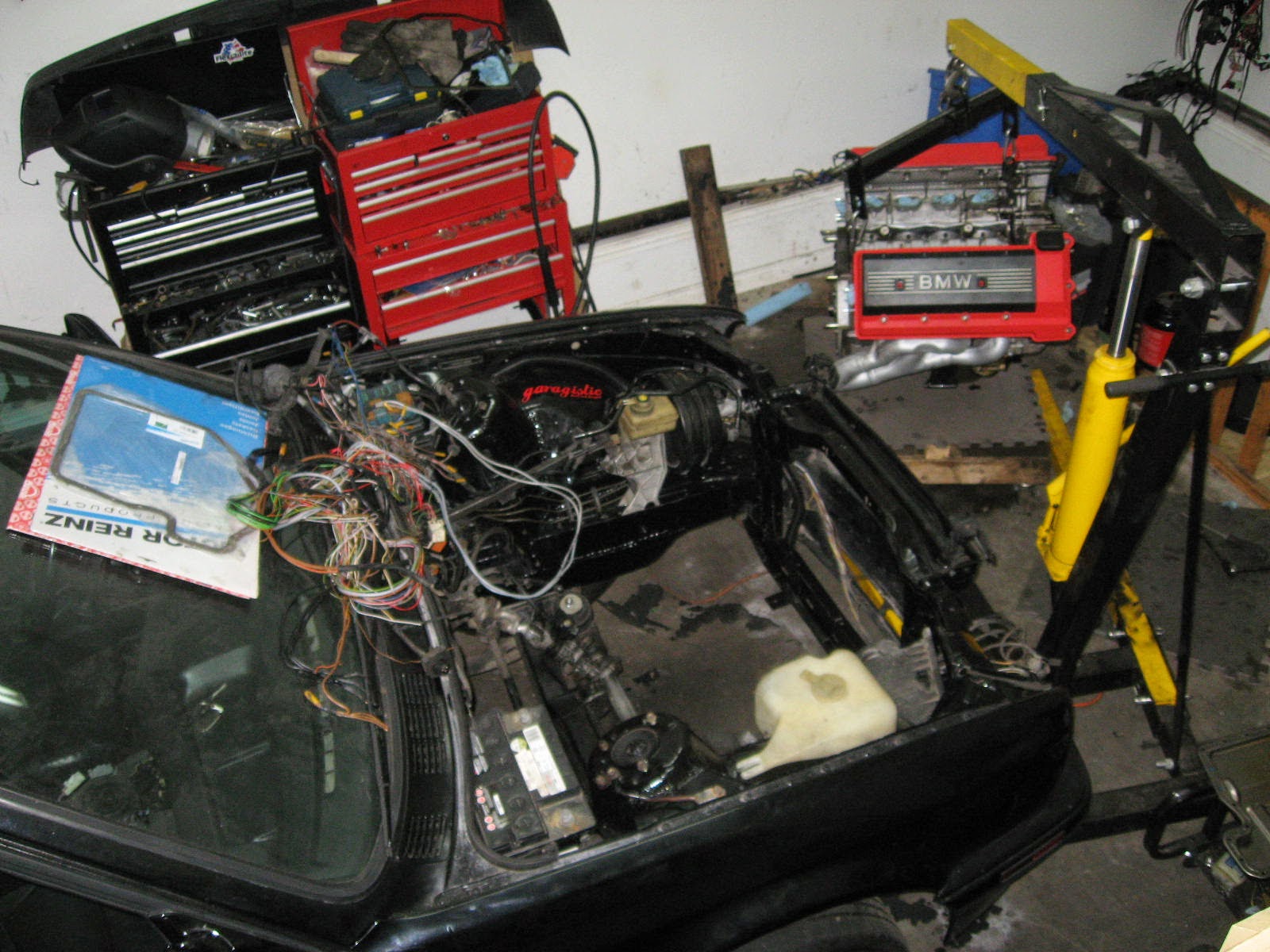

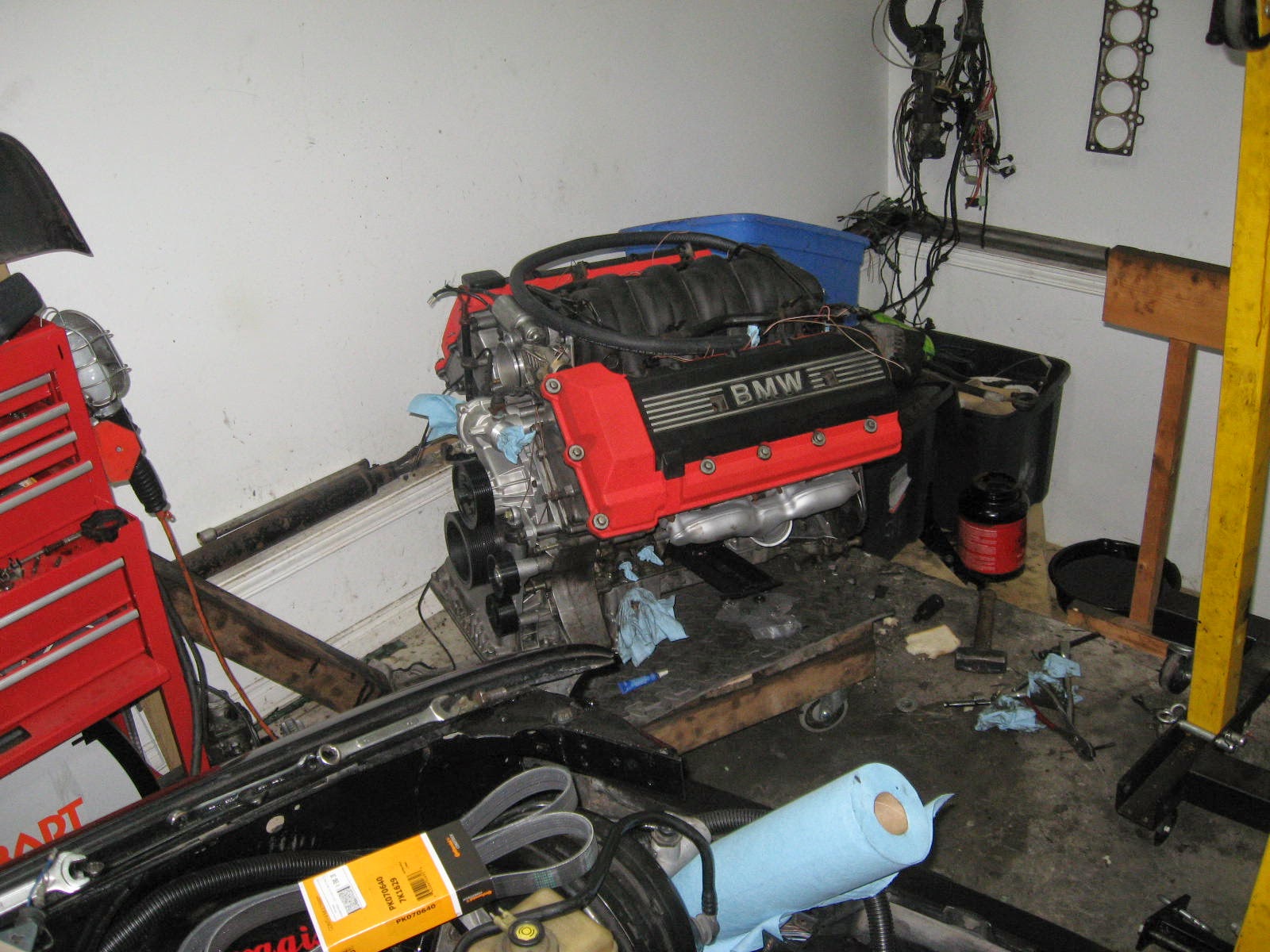

more work done... almost install time..
Who needs a 200$ BMW pilot bearing puller when you have bread...LOL.. yeap bread!!
wiring is going to be fun... going to use what I need from the OEM harness/C101 then its Megasquirt or Microsquirt not sure yet!
starting to look like a motor...
started attacking the tranny... new parts installed

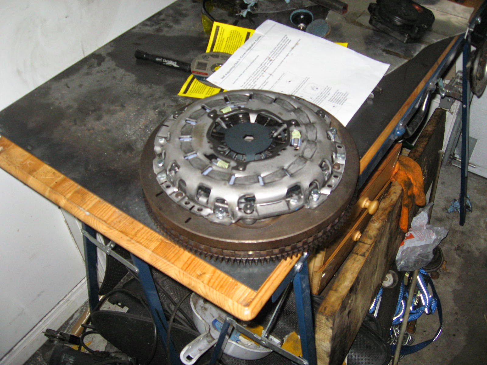

E39 M5 clutch/pressure plate and stock 540 flywheel

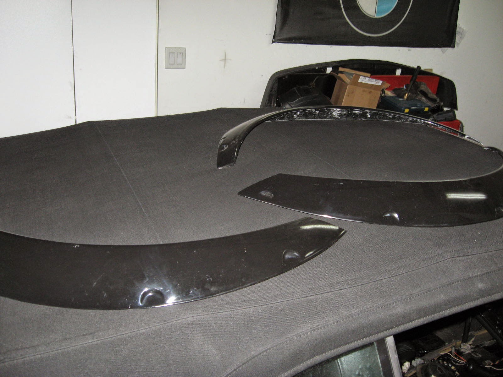

kamotors flares waiting patiently

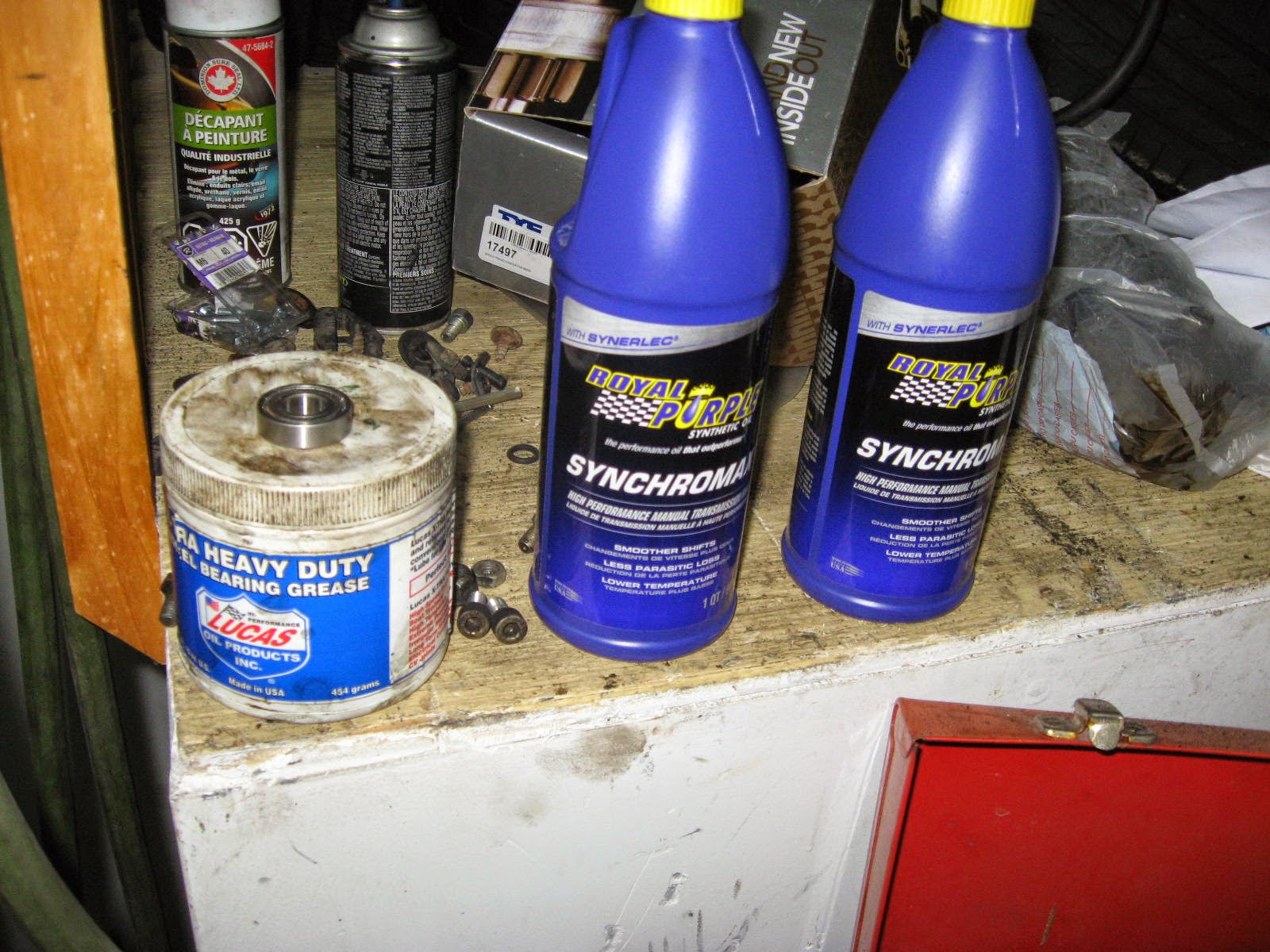

New tranny fluid
Pilot bearing out...also going to delete the OSV and go with a catch can....
Saturday or Sunday I should have this beast installed... but I still need to figure out the OIL filter housing and Power steering (wondering if I can go with JIC fittings instead of those damn always leaking banjo bolts for lines)Denny

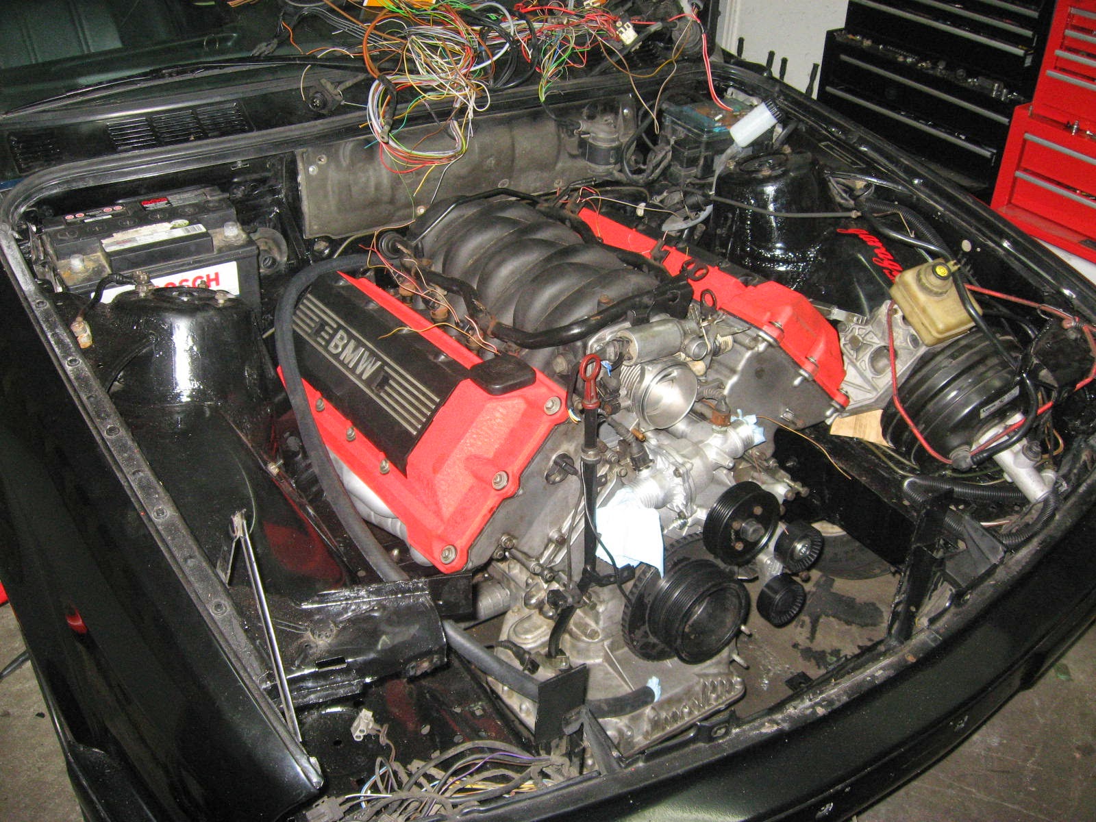

M5 clutch installed..
ready for assembly
Alone this wasnt fun lol..
BIG thank you to my father in law Robert for the help

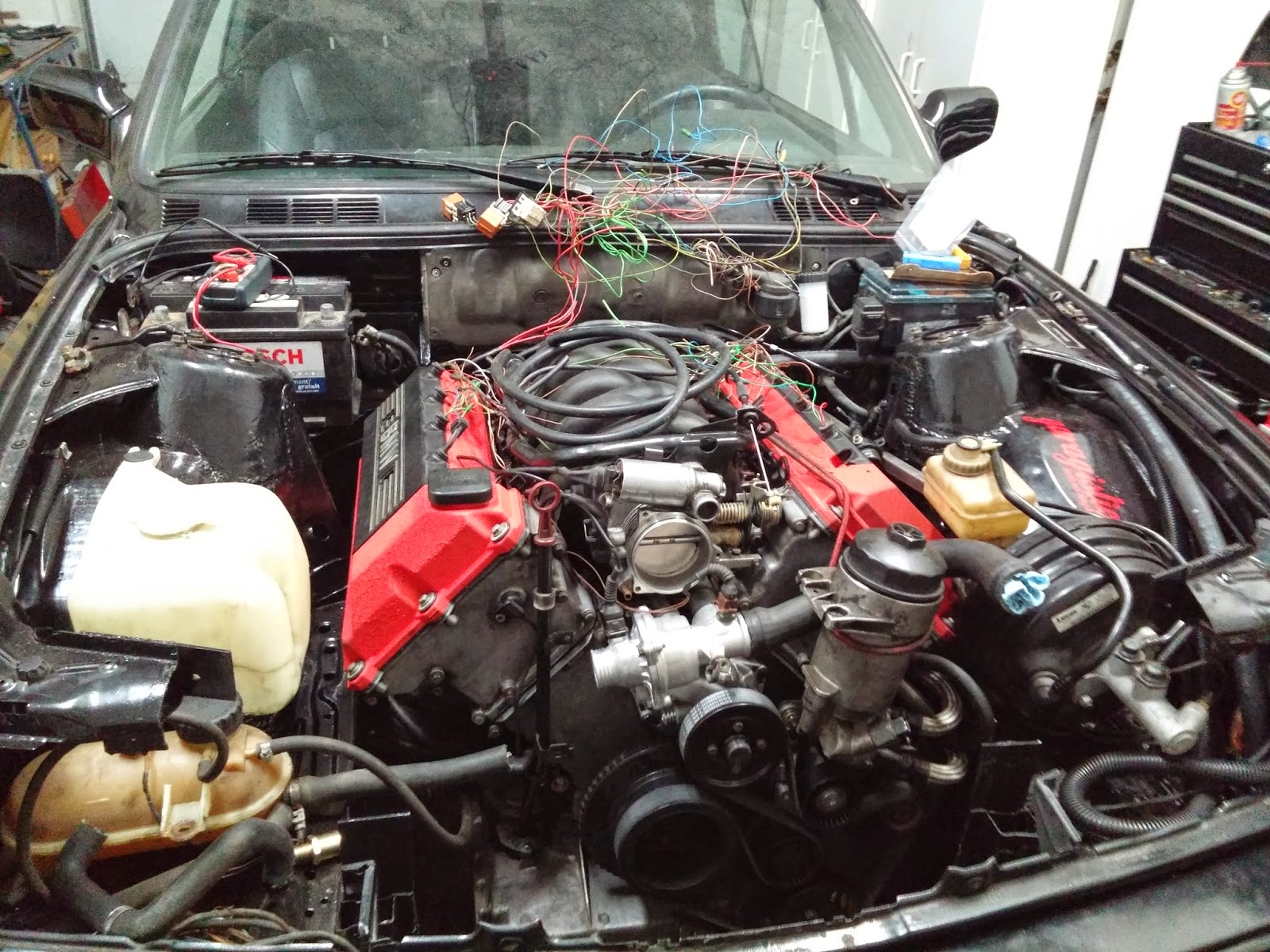

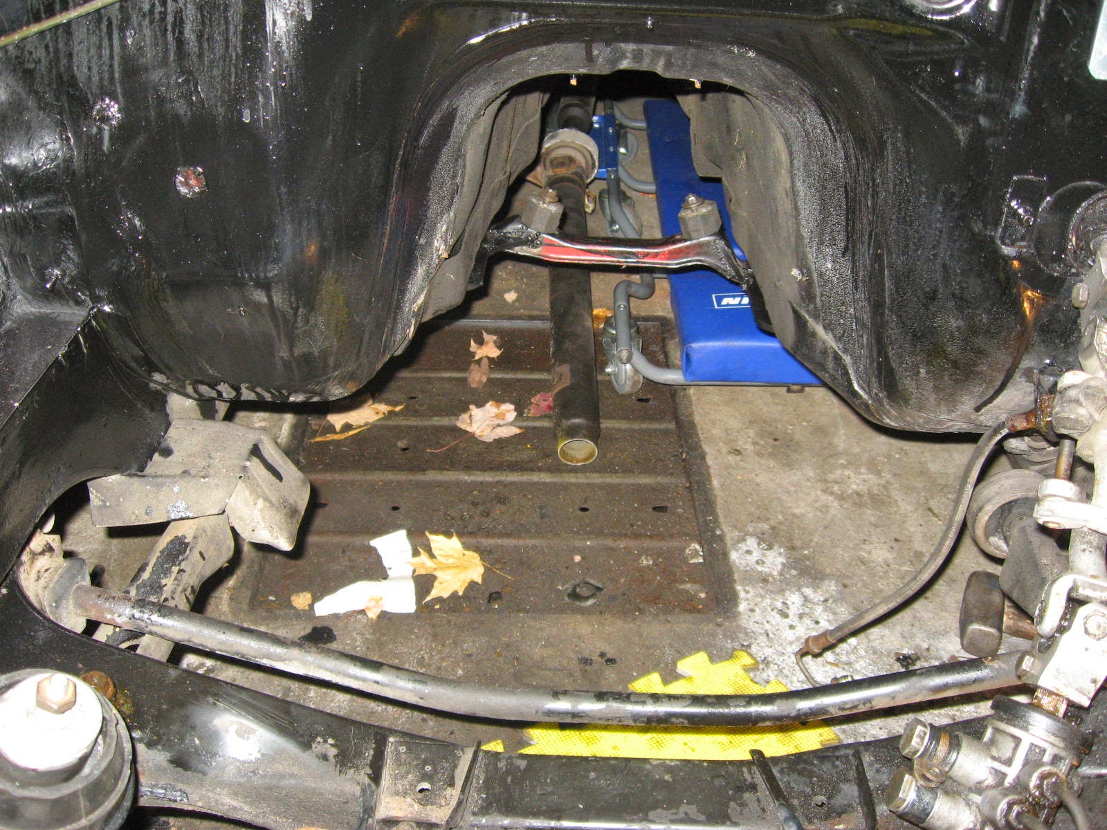

I had forgot to bang the firewall a few inches before the swap so I had some problems but all fixed now made room in the back...repainted and engine went in a LOT easier... thank god for the removal rad support mod
here it is installed ...
Now on to the rest of the fun stuff...

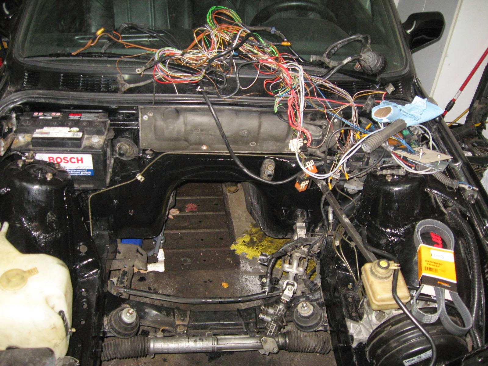

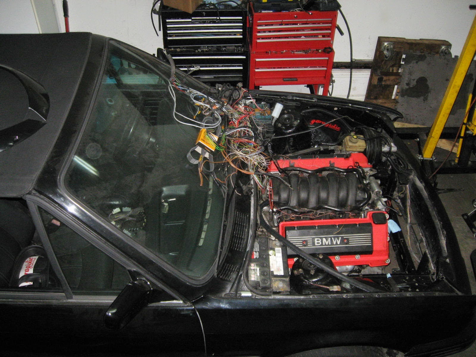

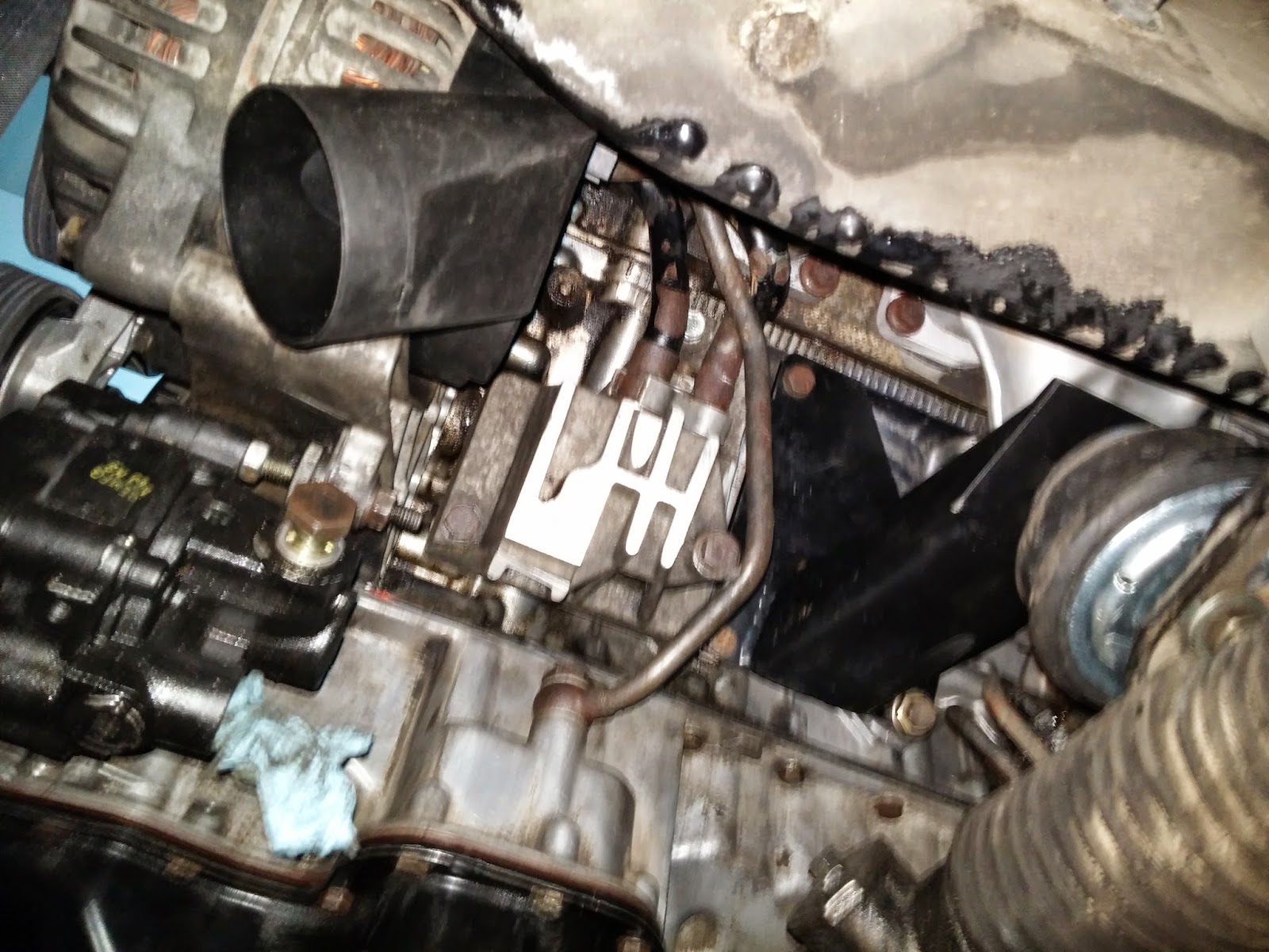

Long time no update been too busy but made a little bit of headway today..
Got rid of 20 pounds of useless wiring...kept what I needed to get ready for Megasquirt II
Finished the Oil filter assembly.. changed all the expensive as hell O-rings
Got to fabricate a braquet to hold the filter housing in place...things are tight
shot from above going to use the E30 coolant bottle
So my next steps are order the MSII and do all the wiring to get this engine fired up.. then I will attack the rad,fan..shifter, driveshaft, diff and finish off with the fender flares and suspension.. yeah I know I got a lot of work..Denny
